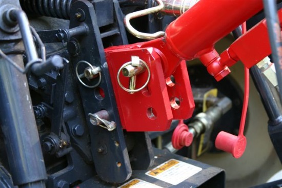

Yep, it shows two Sellers:
This is another option, the toplink extender:
