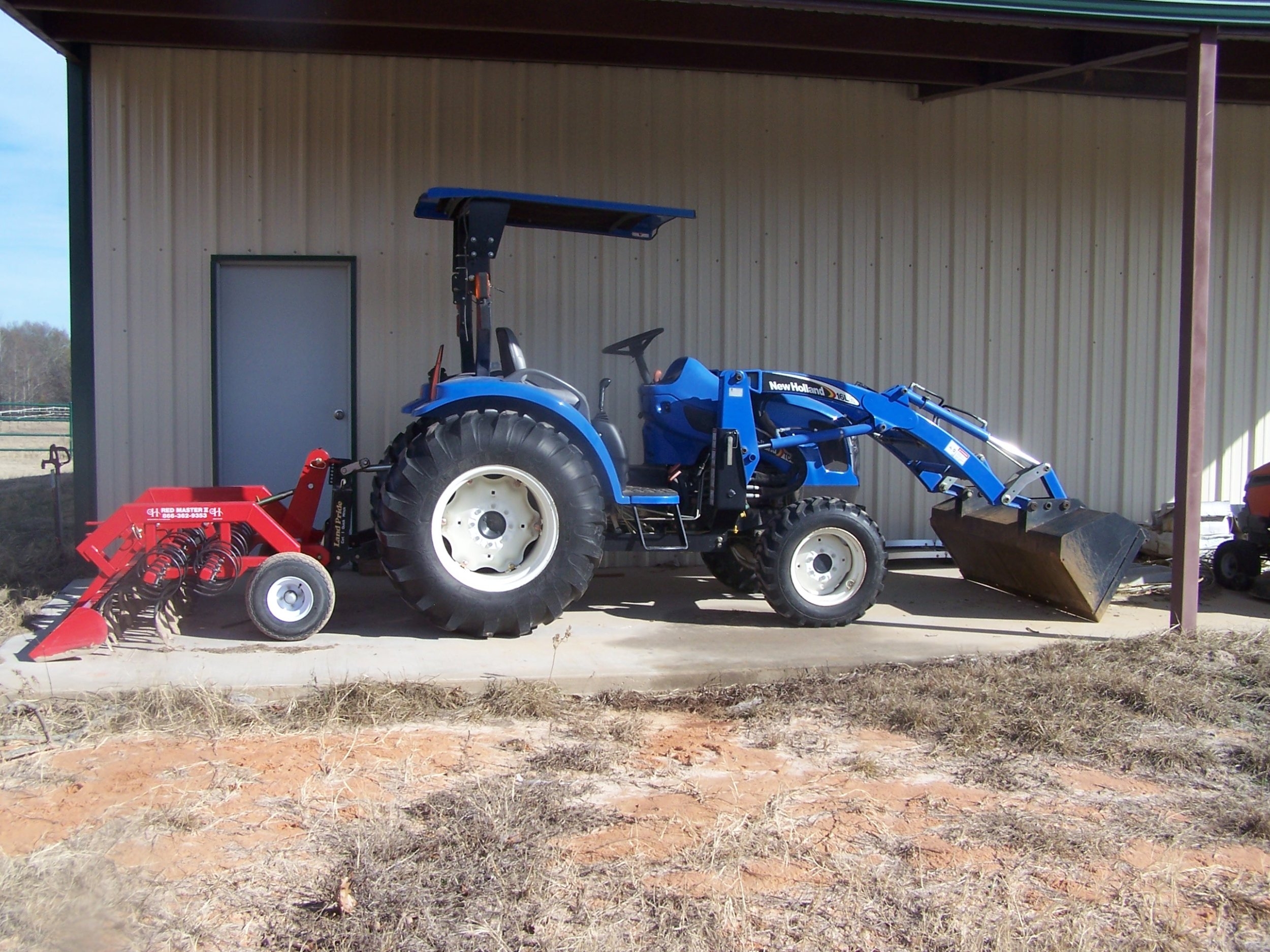

We use an 8' Red Master II harrow for our dressage arena. They make a roller that can be interchanged for the rear blade but we don't need the fluff it provides. We pull it with the NH TC40DA 40HP HST.
