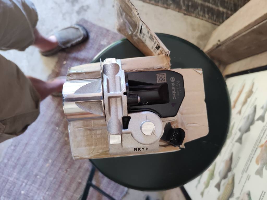

My EGR failed on my 2021 mt357. Dealer sent me a new EGR valve under warranty but it is the "updated" version . Looks a lot different. Has anyone changed there's to the updated version?
/ Updated EGR valve #2
I believe Snowman87 had to change his in his XR4155
What kind of symptoms were you having with yours ?
/ Updated EGR valve #3
The original Erae EGR valve was discontinued by the manufacturer, so LS was forced to change to the new Kamtech valve. I'm surprised that the dealer would send you a new style Kamtech EGR valve because you can't replace it with the new valve without installing a conversion kit. The kit has a new manifold and piping and the engine ECU must also be reprogrammed with new software to make the new valve work. Not something you can do yourself. The dealer uses their EVCI service tool to do that, and also must use the tool to save engine data and diagnostic trouble code files to submit with the warranty claim.
