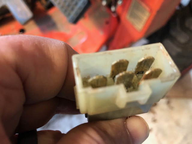

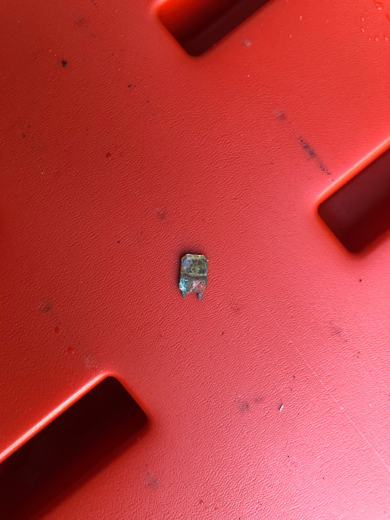

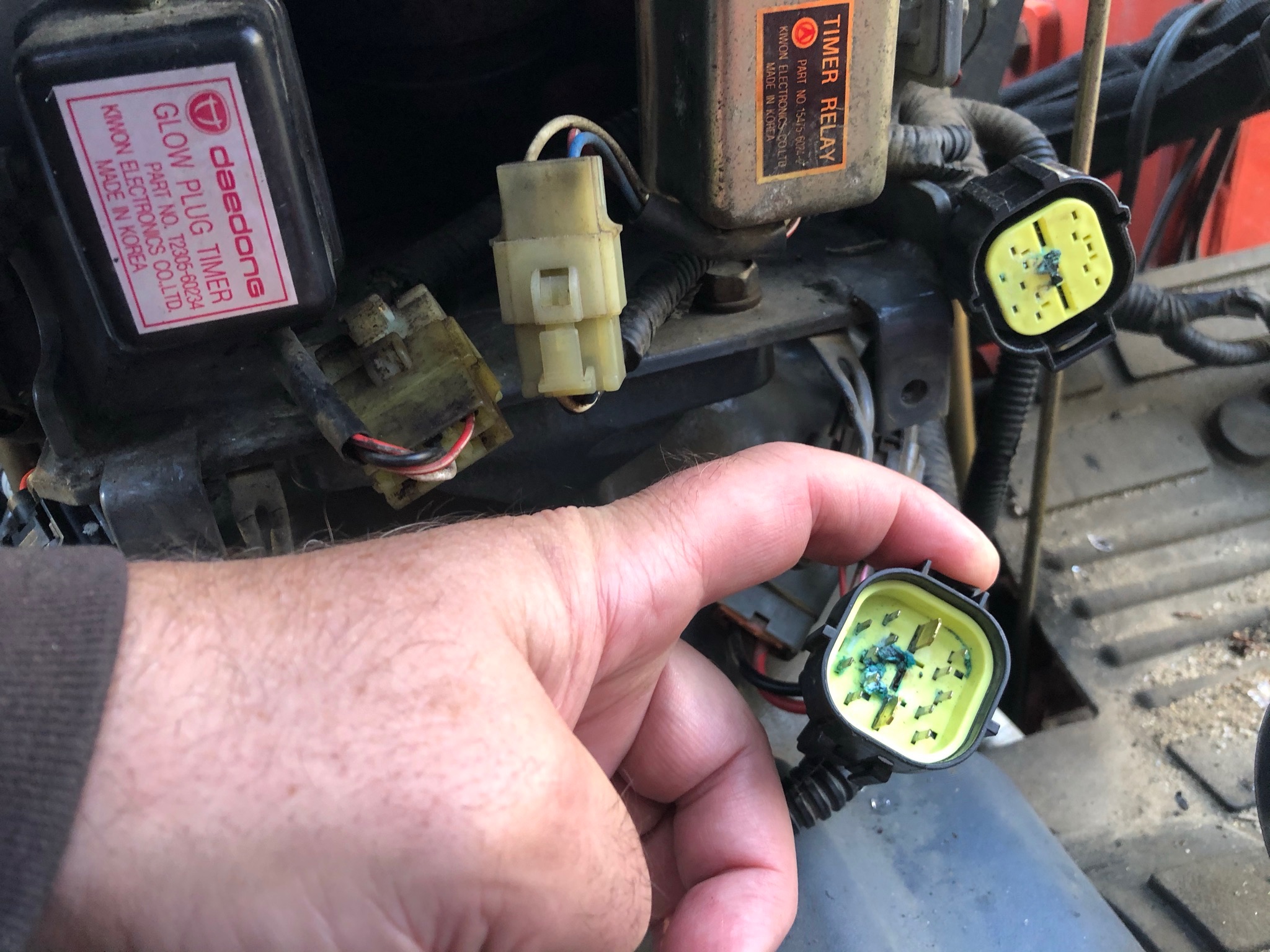

I had a similar problem with my CK20. Turned out to be a corroded pin in a connector on the hot from the battery to the ignition switch. It was intermittent until it corroded so bad it couldn’t carry any current. But it would light a test light at the ignition switch. About drove me nuts. Check the wiring harness connectors, all of them. 10CE9AFC-5CB2-4112-A352-D3782627A909.jpeg6A139753-EEFE-4A57-B055-4BD8B38A063E.jpeg

I had a similar problem with my CK20. Turned out to be a corroded pin in a connector on the hot from the battery to the ignition switch. It was intermittent until it corroded so bad it couldn稚 carry any current. But it would light a test light at the ignition switch. About drove me nuts. Check the wiring harness connectors, all of them. View attachment 679123View attachment 679124

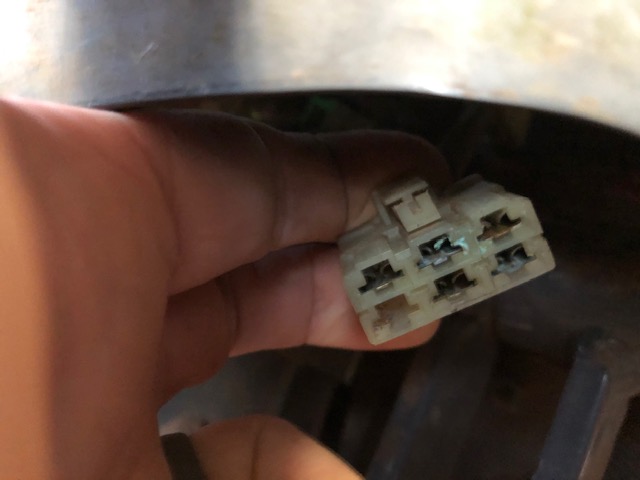

I have hade the same issue with my CK20, but not quite as bad as yours. Also my connectors are different, more of a two row connector. Did you replace both connectors or only one?
Rancho
CK 20 HST
Didn’t replace the connector. Had to do a field expedited repair and run a wire around the connector bypassing just the corroded connector. Will fix properly after winter, although my repair will last.

Here is what my connectors look like.
