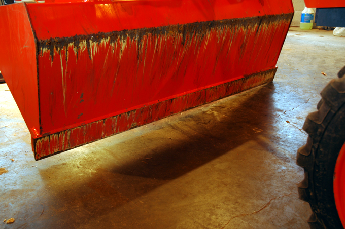

Now that you're back from vacation you may want to check on your oranges crooked loader syndrome.;)
Don
   / update on loader cracks #10
My bucket was like that the other day until I noticed one rear tire was low on air?
Steve
