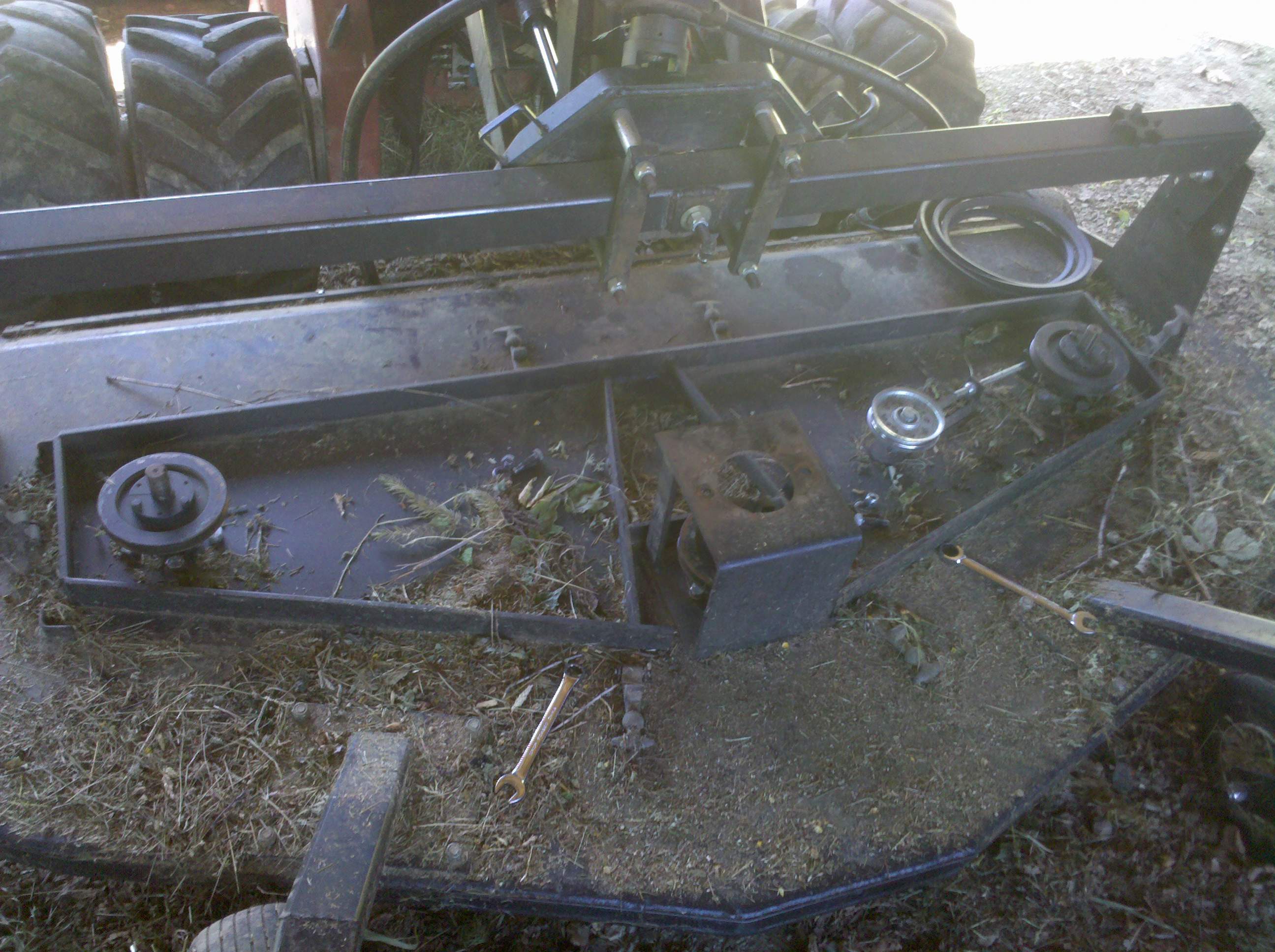

So, my belt was indeed stretched. PT sent me a new one to the tune of $42.72
I bent my tilt, dump cylinder rod so they sent me a news one. Honestly, it looks like the pulled the entire cylinder apart and sent me the whole rod, including seals. There was pipe wrench marks on the screw in end (did not expect to see this). It cost $61.90. I got a seal kit ($19.95 for one cylinder) as well thinking that all I was getting was a rod and not the cylinder cap and piston assembly.
It was replaced easily.
The spider on the mower was indeed shot. $ 22.50 per spider.
But here is the rub. Another bad weld from PT. As I said before, there was this vibration. It turns out the arm that holds the hydaulic motor plate steady on one end, the weld was busted off (no penetration. To really fix this I should have torn it apart, but that looked to be a major nightmare. Instead i got a long welding rod, and ran a hot bead again. Marginal but it held for 8 hours of mowing today.
Carl

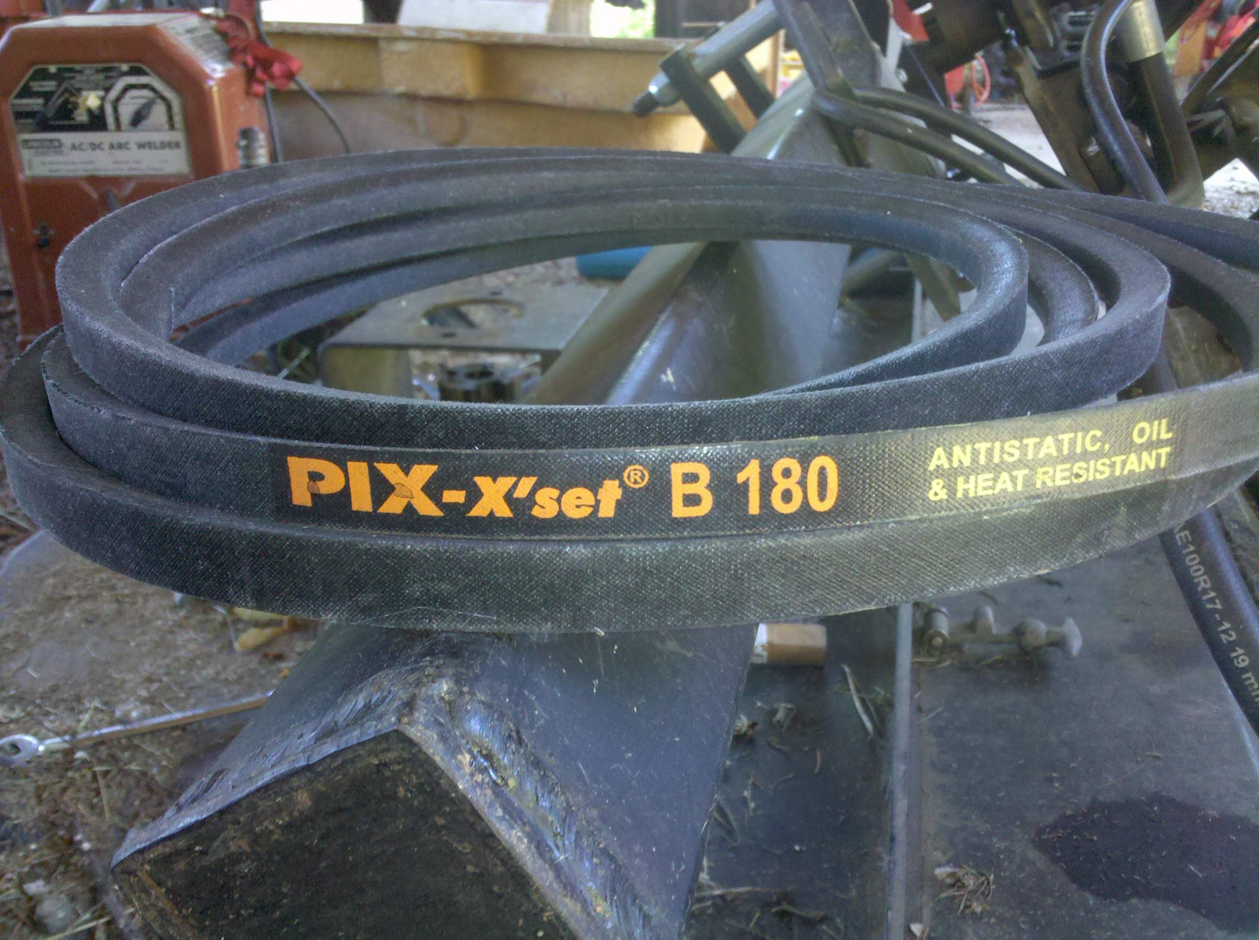

there was no markings on the belt (other than what is in the picture and I can't get a cross reference so far), but I have the old one and will tape measure it up. The stretch is minor, and if it wasn't for the broken motor mount I would have never noticed it.
Just FYI, Terry told me to keep the belts very loose.
I like the Spring Hollow name Ken.
   / Update on broken mower and bent cylinder #4
The belt size is B 180-- that means B cross section, length 180 inches.
If the belt has any reverse bend or small pulleys I have found that BX belts work better and last longer. They cost a bit more and often have to be special ordered.
McMasters Carr carries the B 180 for about $40 and the BX 180 for about $55.

Good to know. Will get a BX next time I am in town.

Thanks, Bob. I just broke mine and it says B 180 on it. Found a good site that has the Gates B 180 for ~25 and the BX 180 for about $33. Because of your recommendation, I am ordering two of the BX 180.
