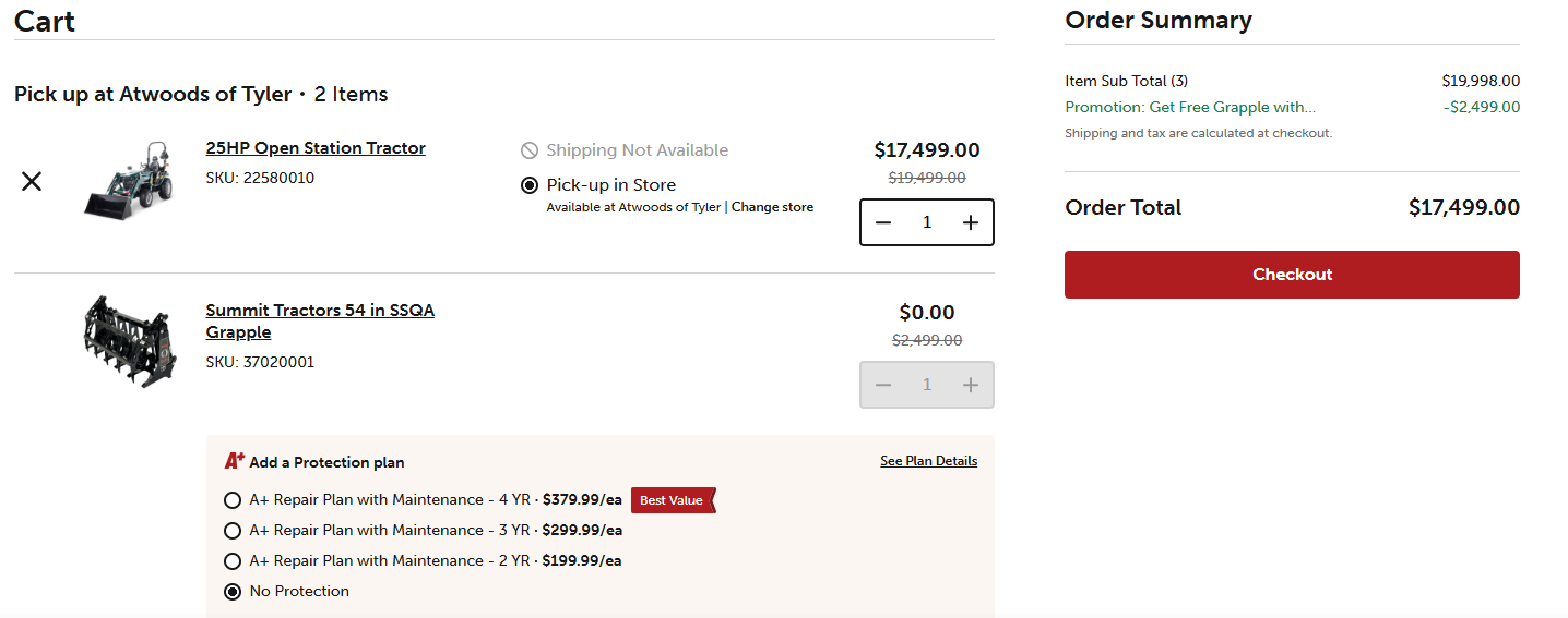

That is too bad they don't have reliable service centers. The Atwoods price near me is down to $17,499 with a free 54" grapple. Would make a good deal for a small homeowner.
/ Update buyer beware
#13
Does it still come with a front loader too?
