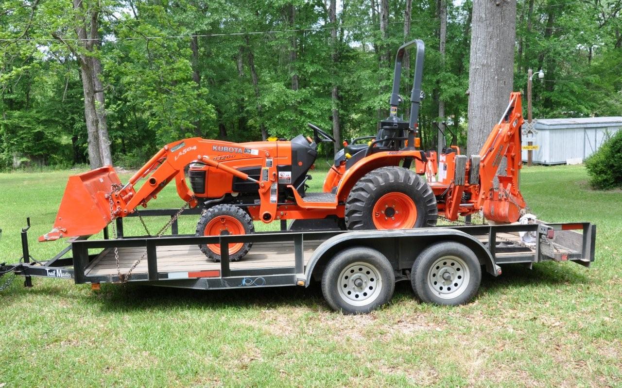

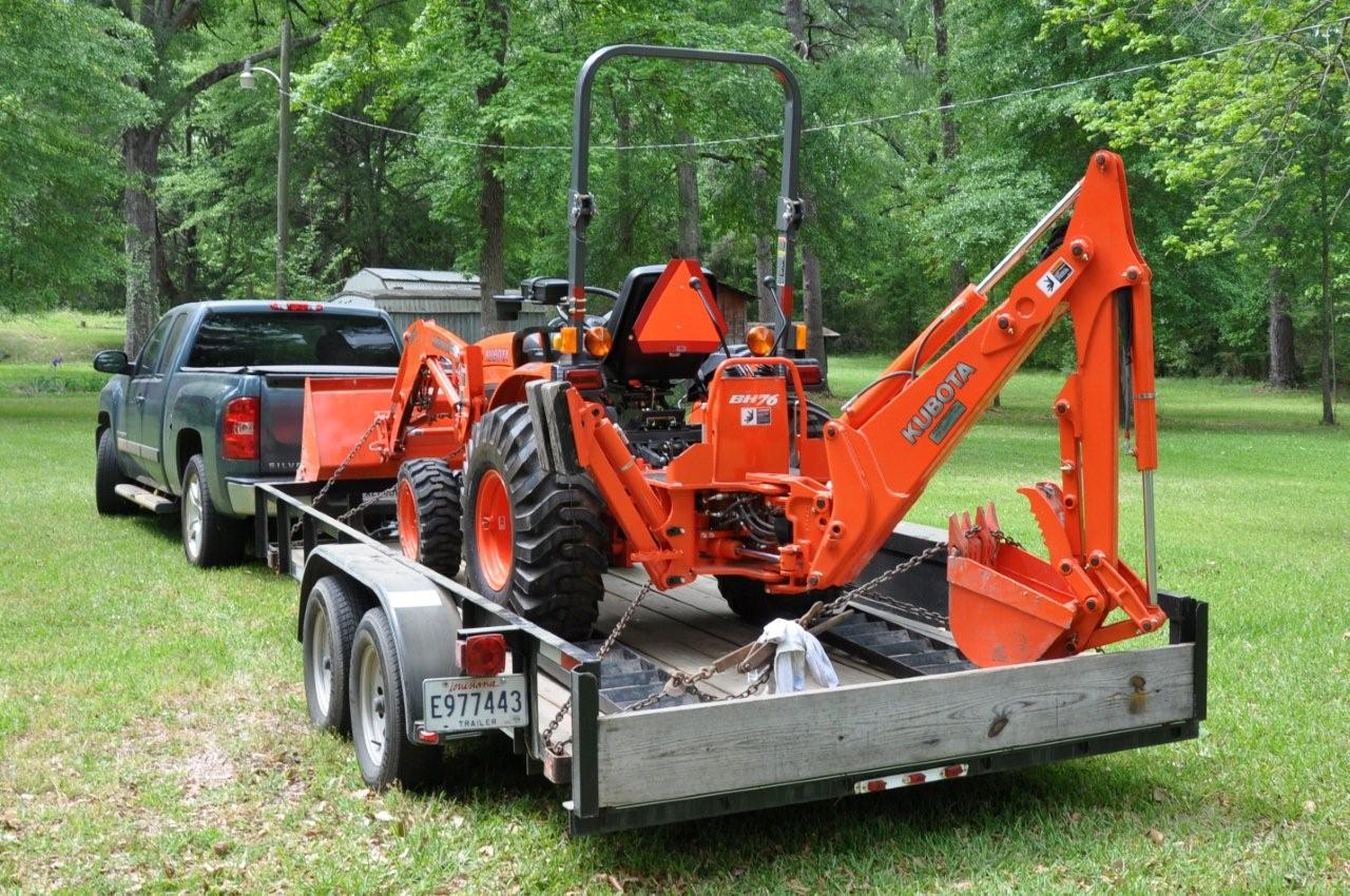

I have a 16ft tandom with out brakes, I was just hauling a BX23 with MMM, and it towed good. I just got a great deal on a B3200 TLB package from Barlows, and from photos you see it just fits on the trailer. Towed it up to my Brothers Thursday, and I could tell I was towing something this time. Getting out of my Yard truck spun out some in gravel pulling onto the road, and enroute it tried to fishtail a little, but not much. I think I need to up grade to a 18ft tandom with brakes, what do yall think, or can I get by, I don't travel much with tractors, or just keep hauling the BX23 for further trips, and only us B3200 my house and brothers, (only 7 miles). I use chains on Loader and back hoe, and all four corners of tractors.

No trailer expert here but curious if it would tow better with the BH to the front?
The BH may have offset the tongue weight too much??
   / Up graded tractor, Should I also get a new trailer? #3
Looking at the second pic I don't think to little tongue weight would be a concern but I could be wrong, it isn't making the truck squat much is it? Also, check tire pressure.

I'd definitely upgrade the trailer. 1) The tractor doesn't really fit the trailer, the bucket is on the rail and the BH is turned so it fits. 2) Trailer should have brakes. As mentioned that 7K trailer would also be illegal in my state without brakes plus its really not safe without brakes having all that weight pushing the truck down hills.
If you can't afford a better trailer at least put brakes on that one.

How much does the new unit weigh? I see a B3200 is about 1800 lbs, but can't find anything on the BH or loader. I'd guess each one of those is 1000lbs or so. It would say in your manual. So that means you are pushing 4k lbs for the TLB. It should work on a dual axle 7k trailer, but I'd go longer than 18'. 18' would barely fit better than what you have now. 20' or more would be better. If you rarely need this, then maybe you can rent for those times. Trailer Brakes would be important, IMHO, for that size load.

I also have a B3200 TLB and I haul it on a 18' tandem axle trailer with brakes. If you could go 20' I would, if not at least 18. I was given an estimate of closer to 5000 pounds with filled rears for the machine. Btw I think I also talked to barlows about the very same tractor that you bought and it was a great deal, hope you are enjoying it.
