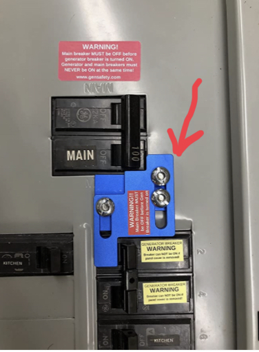

All the 'Interlock' does is makes sure your turn off main breaker before turning on generator.
   / Unsafe generator wiring et al. #36
it makes sure you cannot have both on at the same time (interlocked), which is the code issue, but yes you do have to turn one off before the other can be turned on or both off at the same time just not both on at same time.
