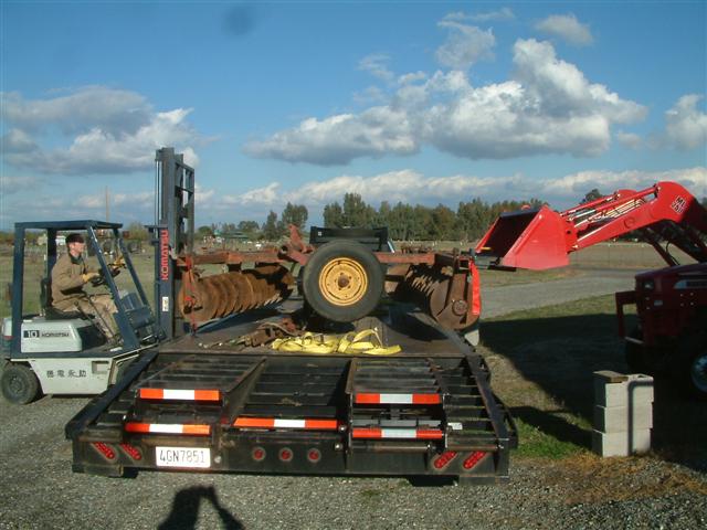

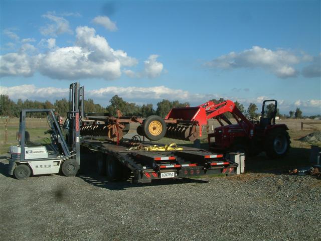

That's how we unloaded a 14-ft wide wheel disc that I bought from my tractor dealer. It probably weighed 2500 lb. Used a fork lift and my 2008 Mahindra 5525 with FEL with detachable forks capable of lifting 2900 lb.
