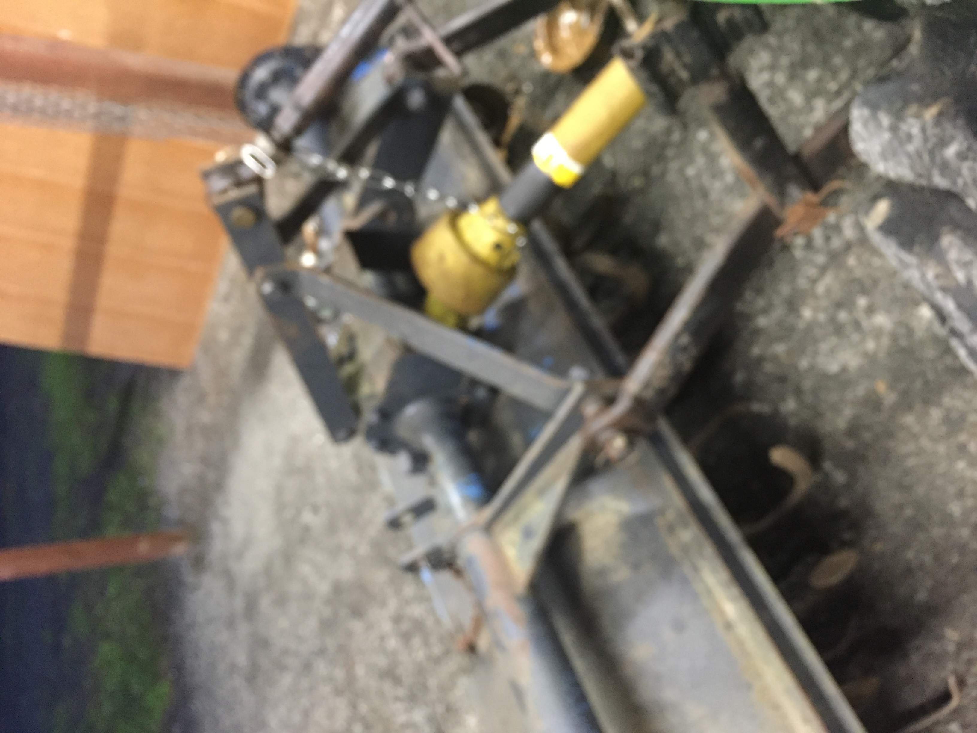

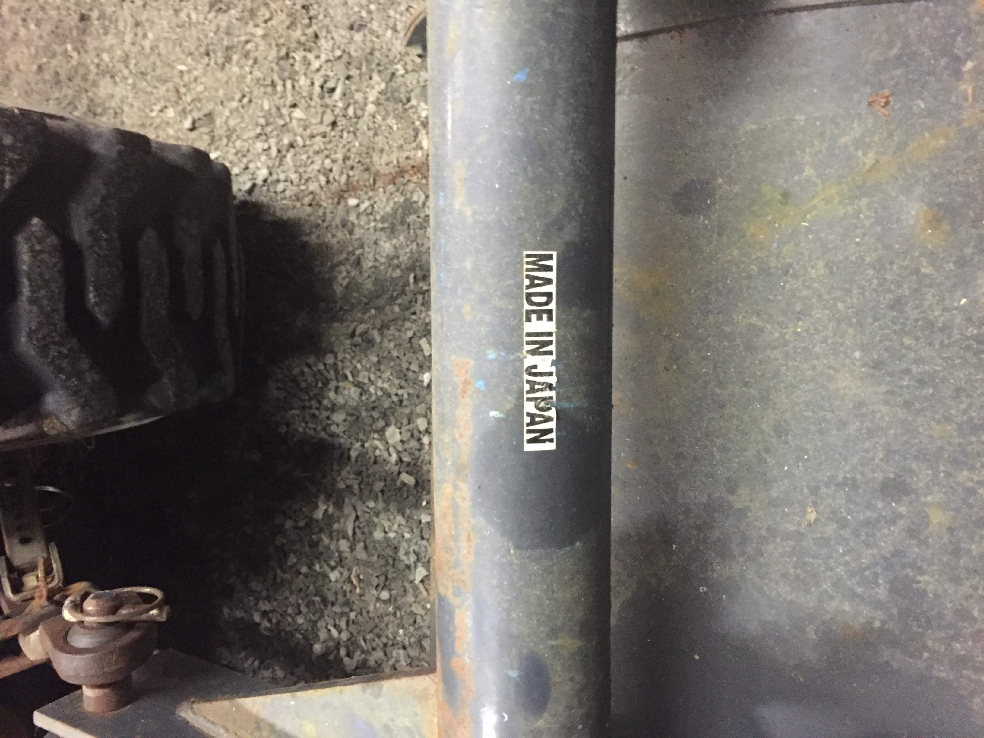

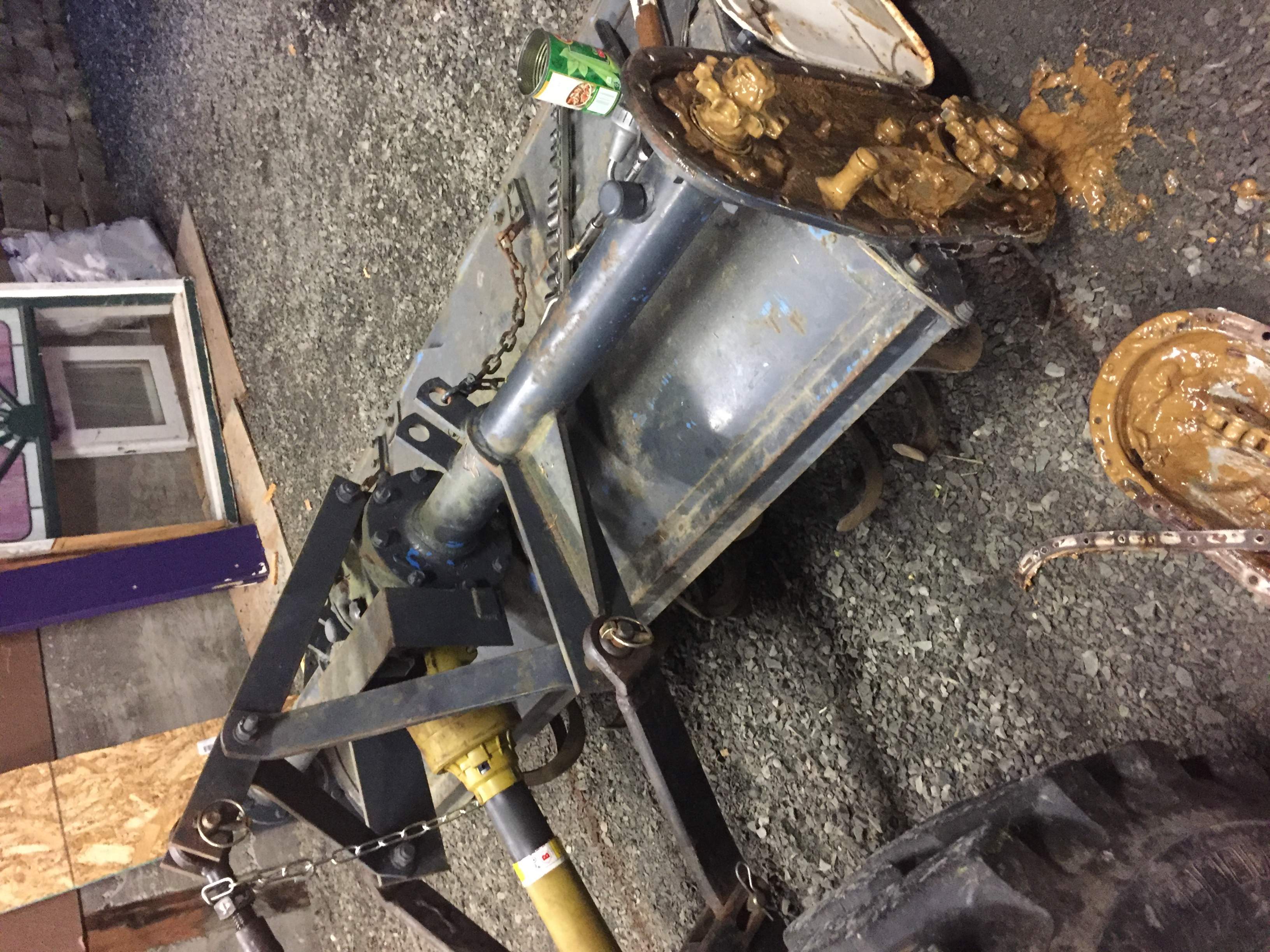

I have this made in Japan tiller and I've broken the chain. Does anyone recognize this make?
I would like to be able to repair it instead of buying new since I only use it sparingly.

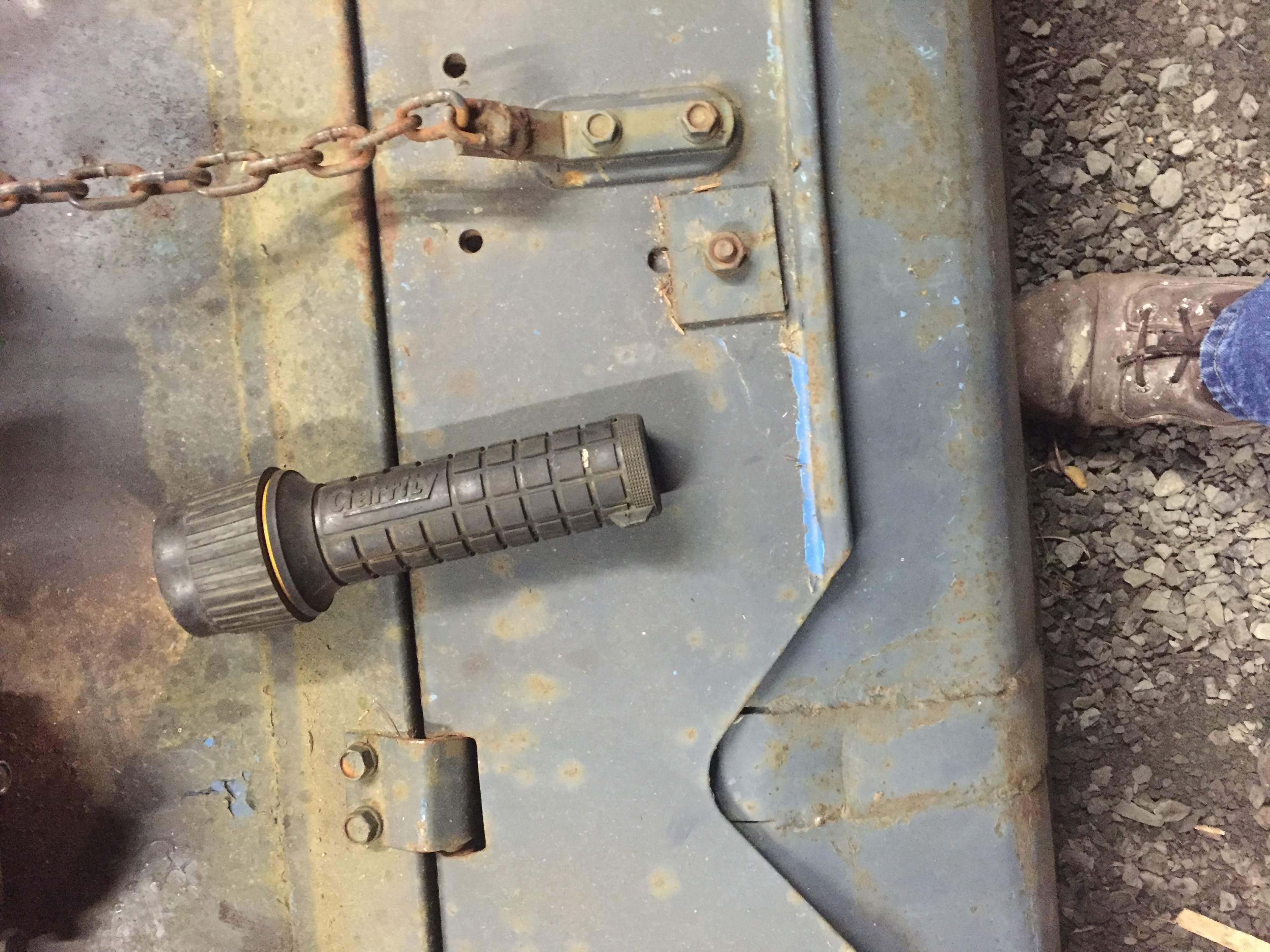

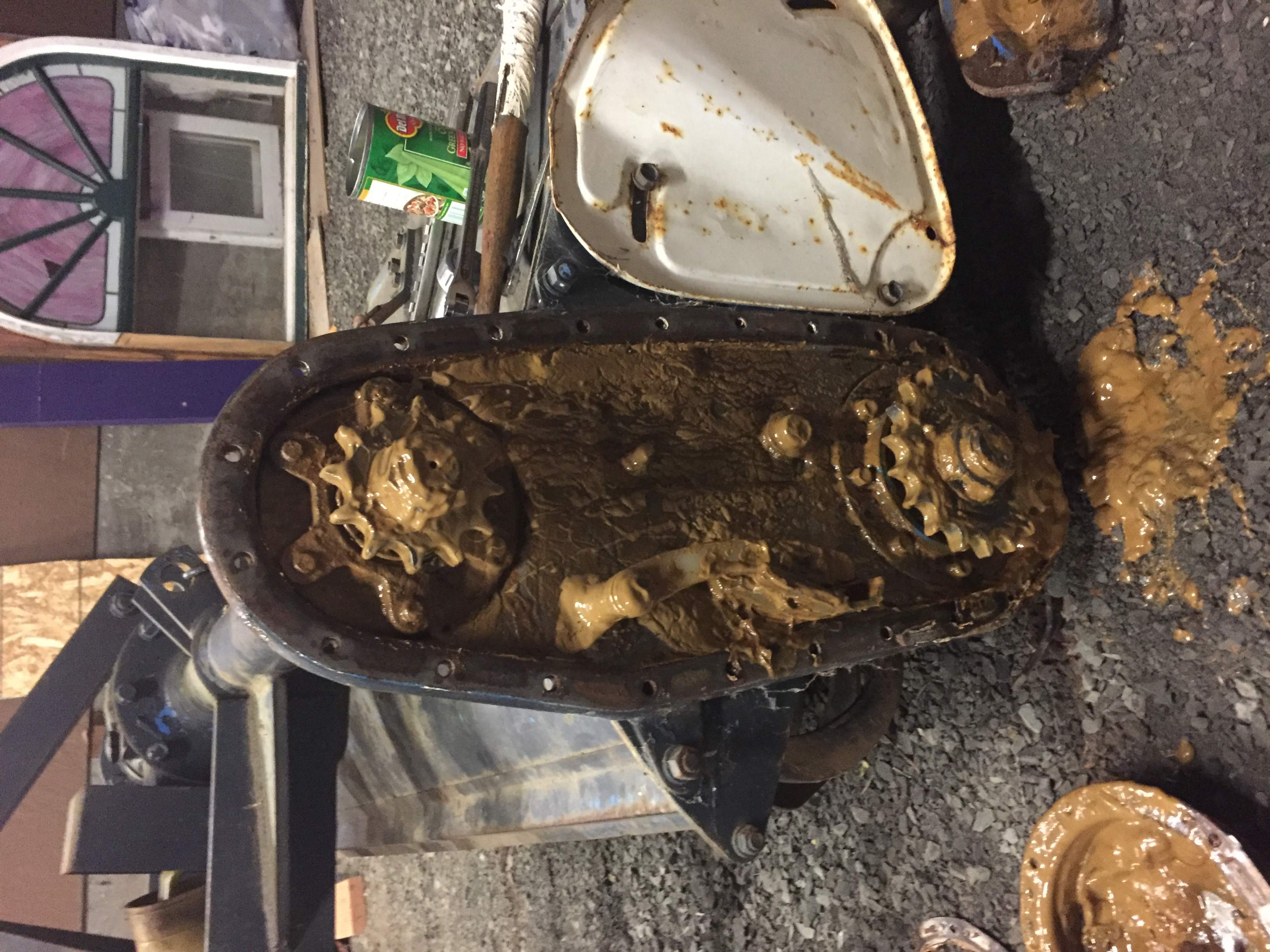

It appears as though it was originally a light blue color. Of course I had no idea the gear lube in it was so foul.

any dealer should have some chain that will fit it
   / unknown tiller is broke #4
Looks like a standard roller chain.
Should have the size stamped on the links of the old chain.
Find the size, count the links and get a new chain.
thank you! that makes sense. clean up the chain and have a new one made. the cover did sustain some damage but I can repair that and
pound out a new gasket if one is not available.
thanks. I had forgotten that "fact" about roller chain..................size being stamped.

I got out the file for the tractor today and in fact, I had retained the invoice from when I purchased the used tiller. it is listed as a Mitsubishi.

Looks like it was run with water in it. I would check all the bearing too. Moving parts don't get along with water.
