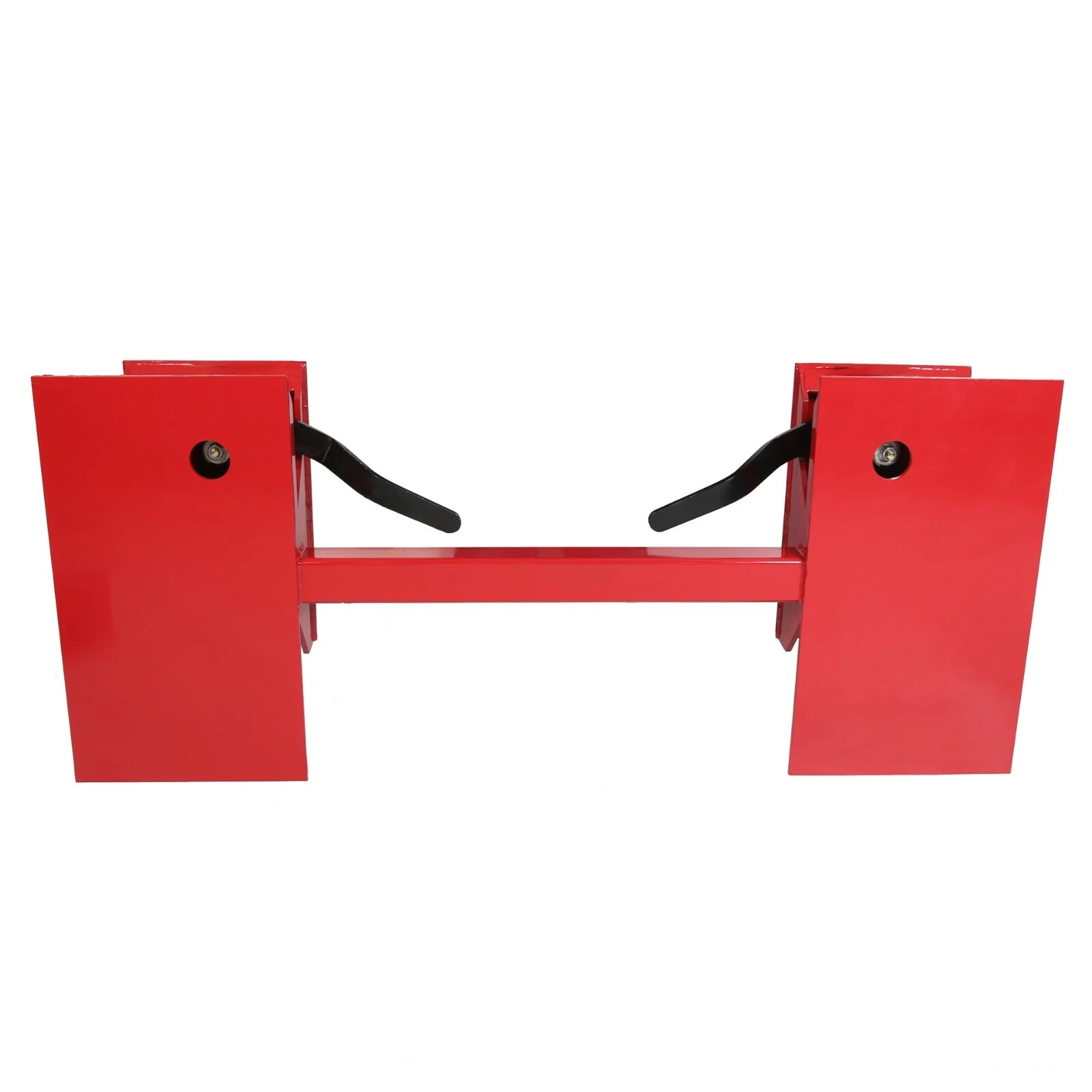

Looking to convert my ML112 FEL to SSQA. I can weld but would buy a reasonably priced, ready made adapter.
FYI. $1000-$1900 is not what I consider reasonable.
I can weld and may buy ebay weld on adapter, like this:
Universal Skid Steer Quick Tach Conversion Adapter Plate Attachments 4000lbs | eBay
Any tips or ready-made pin plates would be most appreciated.

Thanks.
Yeah, my cutting edge is worn, too, especially on the edges.
Figure while I'm going to be welding, it's a good time to look at making the SSQA conversion.
I suspect I will have to make a pattern and fab some weld-on brackets for the pin side to a conversion setup.
I don't have a plasma cutter and not looking forward to that much grinding, Lol.
I'm sure *somebody* has a pattern or the ears/brackets, but I haven't found them.
I'll keep looking for another week or so, then have to suck it up and DIY...
