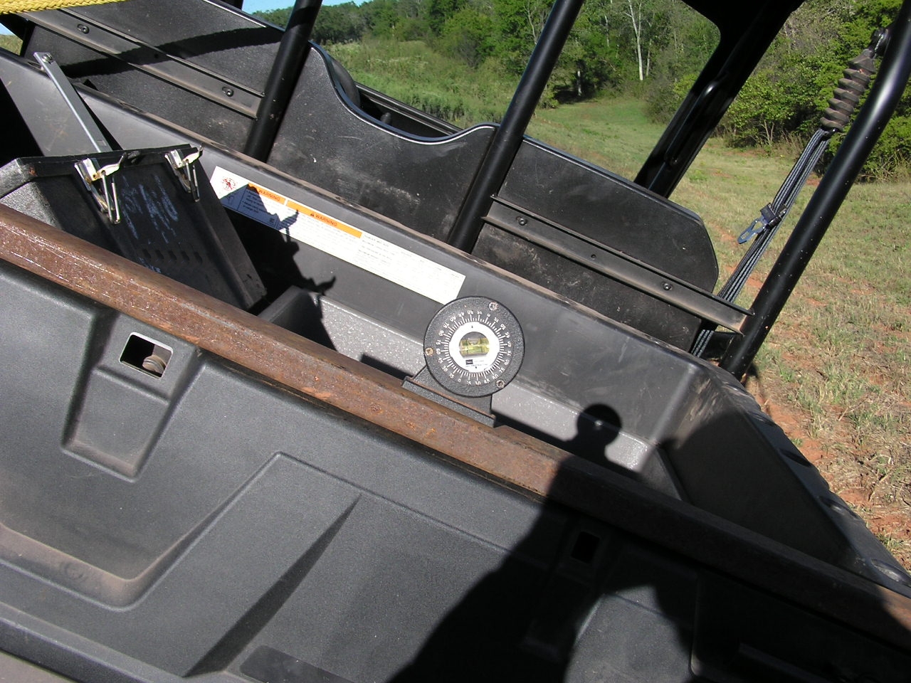

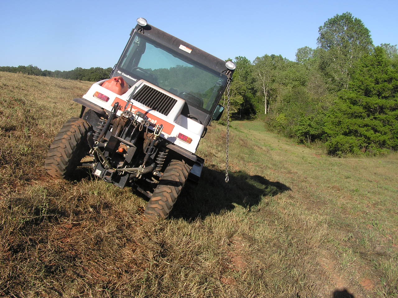

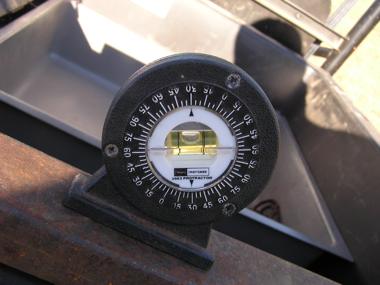

This is what a 26.6 degree side slope looks like.
Notice the chain on the Toolcat's work light to show true straight up and down.
I sure wouldn't want to yank that chain! :laughing:

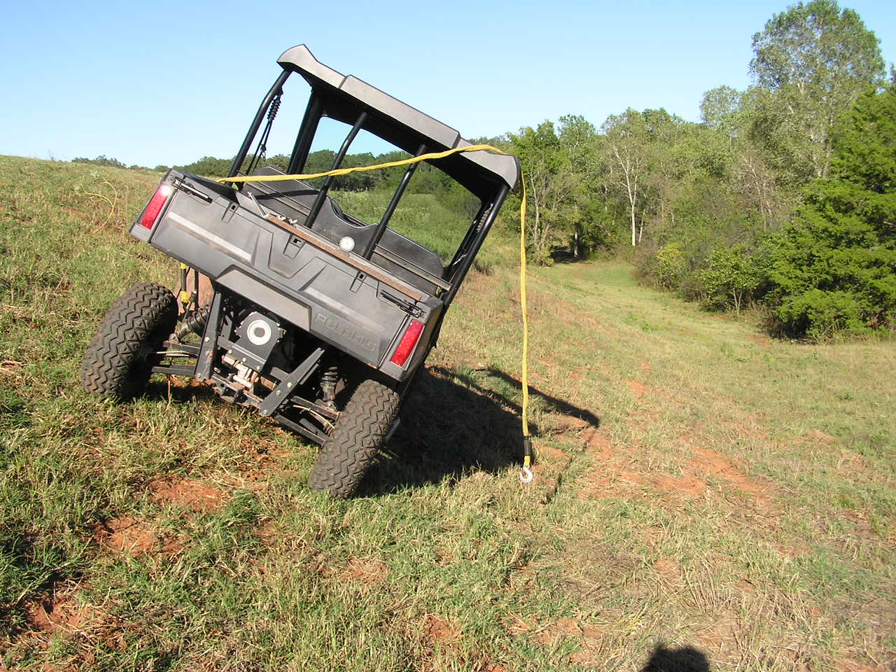

This is the same slope, showing 30 degrees of body lean on the Ranger Electric.

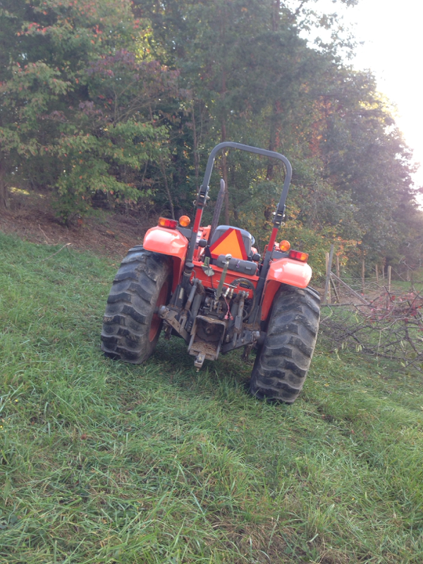

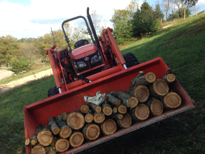

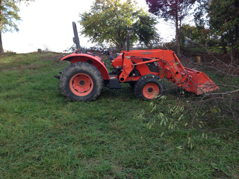

This is what 20 degrees looks like.
   / Uneven and hilly ground #14
ROPS up/seatbelt on. ROPS down/seatbelt OFF.
Even with 4wd tires can easily slip sideways on uneven wet ground, in mud/grass/leaves, etc.
Always use caution when on a slope and beware of the terrain below you. Rocks, slippery roots, etc can all move the tractor like it was on ball bearings. Bucket low, whether it's loaded or not, and definitely load your rear tires- there is no reason not to- it only provides benefits that are not overcome by not having them loaded.
Turn slowly, and let off the pedal if you start to tip at all. It takes getting used to so practice on smaller slopes first.
