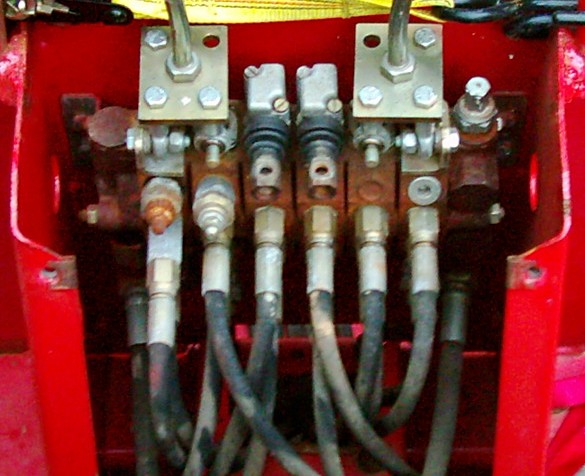

I have hooked up the hydraulics on the hoe as prescribed here in this forum by opening the return line back to the Hyd. block from the loader. The loader still works fine, but the hoe doesn't. Let me add that the hoe was empty of all fluid prior to me owning. I have topped off the fluid several times as it fills the hoe. The hoe will not operate. The only thing I got it to do is drop the arms and jack up the tractor and moved the bucket a bit in one direction and the one cylinder just before the bucket in one direction. Now, nothing moves except for minor jerky attempts at cylinder movement. It sort of appears that the cylinders are slightly moving in a direction opposite of the pictures by the sticks. I am wondering if the supply and return lines are reversed? Is this possible? Any thoughts? /forums/images/graemlins/confused.gif
Picture of valve attached.
   / understanding B7800 hydraulics #9
Your picture does not tell us much. Where is the inlet hose and where is the outlet hose? If there is a relief on the valve it will be on the inlet side.

The lower 2 hoses(Most left/most right) are the in/out. In a previous post, somone told me in is on the left and out on the right. I assumed this correct and hooked up this way. Since you say if it has a relief, that would be fluid into the hoe, that is backward to how I have done it if I am to assume the silver thing on the right top valve is a relief shown in the picture. I will try reversing the in/out hoses and give it a try.
