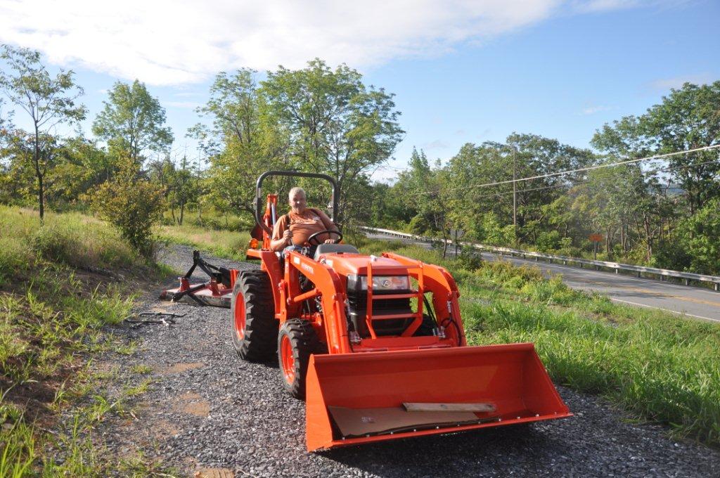

Skeet, I have just been using my freinds L3700su, with a BH SQ160, and we were taking on a large ticket of briars, handled it with ease, also my friend is a little on the larger size, he is 6'6" and 350 plus. After shoping around for tractors with him, he got a L3700 because he could get on and off tractor with no problems. He has it in a TLB, and the bush hog. I don't like the fact that he as two seats for tractor, makes it tight to use the BH 77, back hoe, but has plenty of power. See this thread, about last weeks bush hoghing we did. http://www.tractorbynet.com/forums/...g/208765-l3700su-working-hard-lehigh-gap.html , hope this works as a link, if not, its in the Kubota Using area, working a L3700 hard in the Lehigh gap . He lives on a mountine side and so far he has not had any problems.
/ Uncertain #14

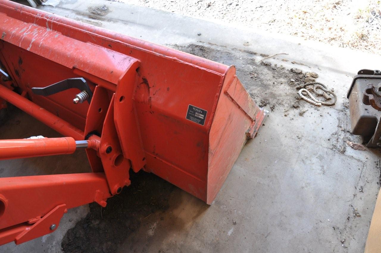

Hey Skeet, More info here. My friend, Kermit, also has the larger 66 inch heavy duty fel bucket, L2296, with bolt on front edge, and is SSQA. I would recoment you look at that for your unit up front, cheper that way. The SSQA gives you lots of options. some photos attached.
