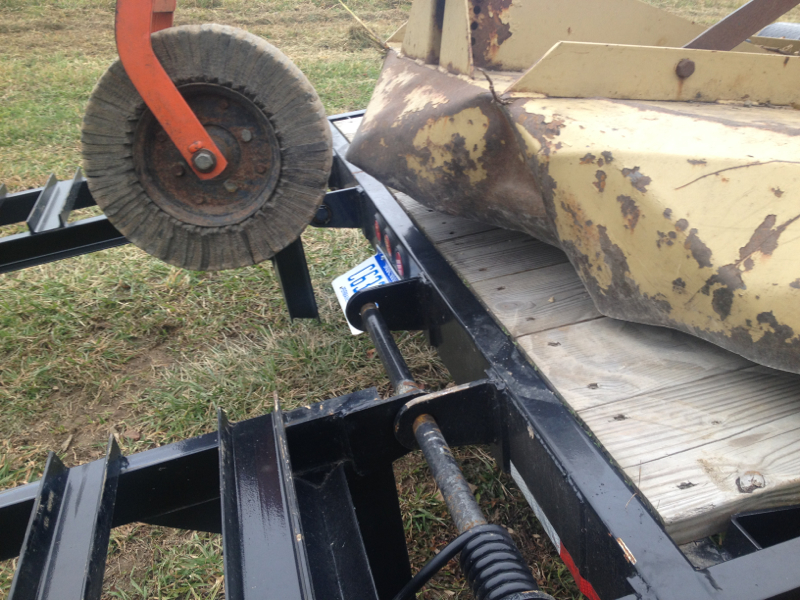

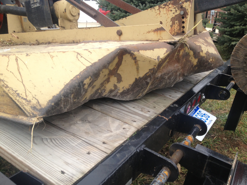

Just curious is anyone has some suggestions to unbending the rear skirt on my land pride rotary mower. I probably won't get to this for the next month or so but I want suggestions.
If you suggest attaching a chain and pull it out with a truck, best way to attach the chain to the skirt.
If you suggest heat, which gas is best.
Do rotary mowers use suction like regular mowers? What if I just cut the shirt off and just welded on chain links?
Shoot me your thoughts please
The mower still functions fine. With this bent, it cause some clumping of taller grasses. This can be cured by running clumps over backward with the tractor after being initially cut. However, let's face it, this is a waste of time when it should cut and scatter in the initial pass.

You could take a large pipe wrench adjusted down and pull up with your foot on the mower. When you get close, with the wrench, then get out the hammer and the hearing protection. Or your chains idea doesn't sound bad to me.
/ Unbend rotarty mower skirt #3
Set it down over a stump and slowly drive forward? Back up a few feet on the trailer, lower the cutter to sit on the trailer deck and wail on it from the inside with an 8# sledge and GOOD hearing protection?

Ok, I have tried a sledgehammer and it did nothing. I did hook a chain to my truck whole the cutter was attached to the tractor. I turned the tractor off and set the brake. The truck began to pull the tractor.....
I really like the stump idea ... Maybe even wrap a chain around a stump and attach it to to skirt...

I had a little success using a "porta-power". Was able to push from one side to the other. Be careful as the device can slide and slip off suddenly.
/ Unbend rotarty mower skirt #7
Cut out, weld in new plate or chain links or a piece of rubber conveyor belt or something like that. That's what I would do if it were mine or of you hired me to fix it
/ Unbend rotarty mower skirt #8
Cut it out and put on some deflector chain. The cuttings will be in longer (larger pieces) but you will get away from that clumping problem plus giving it a rear discharge will leave a little extra power running it. Same scenario as running a mulching mower deck versus a discharge deck. If you don't like the result of cutting it out, then weld some new flat stock on a close it back up.
/ Unbend rotarty mower skirt #9
I straightened my skirt by attaching a 16" crescent wrench to the skirt then a " come along" to the handle of the wrench. Also tried the sledge hammer with no success.
/ Unbend rotarty mower skirt #10
Pipe wrench worked great for me but you may have thicker material and it looks bent pretty bad.
/ Unbend rotarty mower skirt #11
If you try the wrenches youll need some ~1/2" shim metal to extend the jaws to the point you need to bend. Two 24" cheap china "crescents" with 6' pipes can give you good control. A helper would be good too. Kinda tuf alone.

I bent mine up once, not as bad as yours, but it was touching the blades which chewed a hole in the skirt. I used my FEL to flip the mower upside down with the bent spot on the ground. Using a 16# sledge hammer, I beat it back in shape. You can get the full swing and force of the hammer this way rather than sitting underneath. I think you will find that the quickest way.
I didn't have to heat mine, but yours may be thicker.
If you have a concrete slab to set it on, it may also work better. While I had mine upside down, I removed the blades and gave them a sharpening. I did have a helper to work with me removing/installing the blades.

Well, as stated, I tried hooking a chain the the skirt and pulling it with the truck. Really this method should of worked but didn't. Between the chain falling off and trying to do it myself without a spotter it was on so/so.
I slid the skirt over a short stump and it slid right over it. I found another stump a little false and tried again. Well, it was rotted and tore it out of the ground. I tried another stump and did it numerous times. I don't think it made her perfect by any means, but this was definitely the most successful way and easiest by far. Slow and easy.
I would eventually like to make if even better but it worked out.
