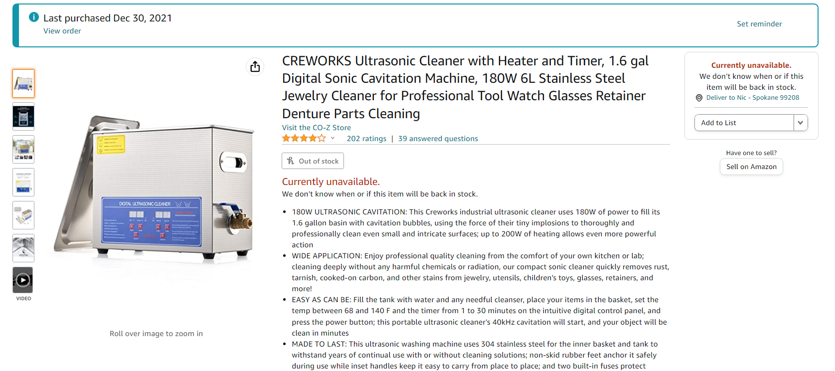

What do you use for a cleaning fluid in your ultrasonic cleaner?
