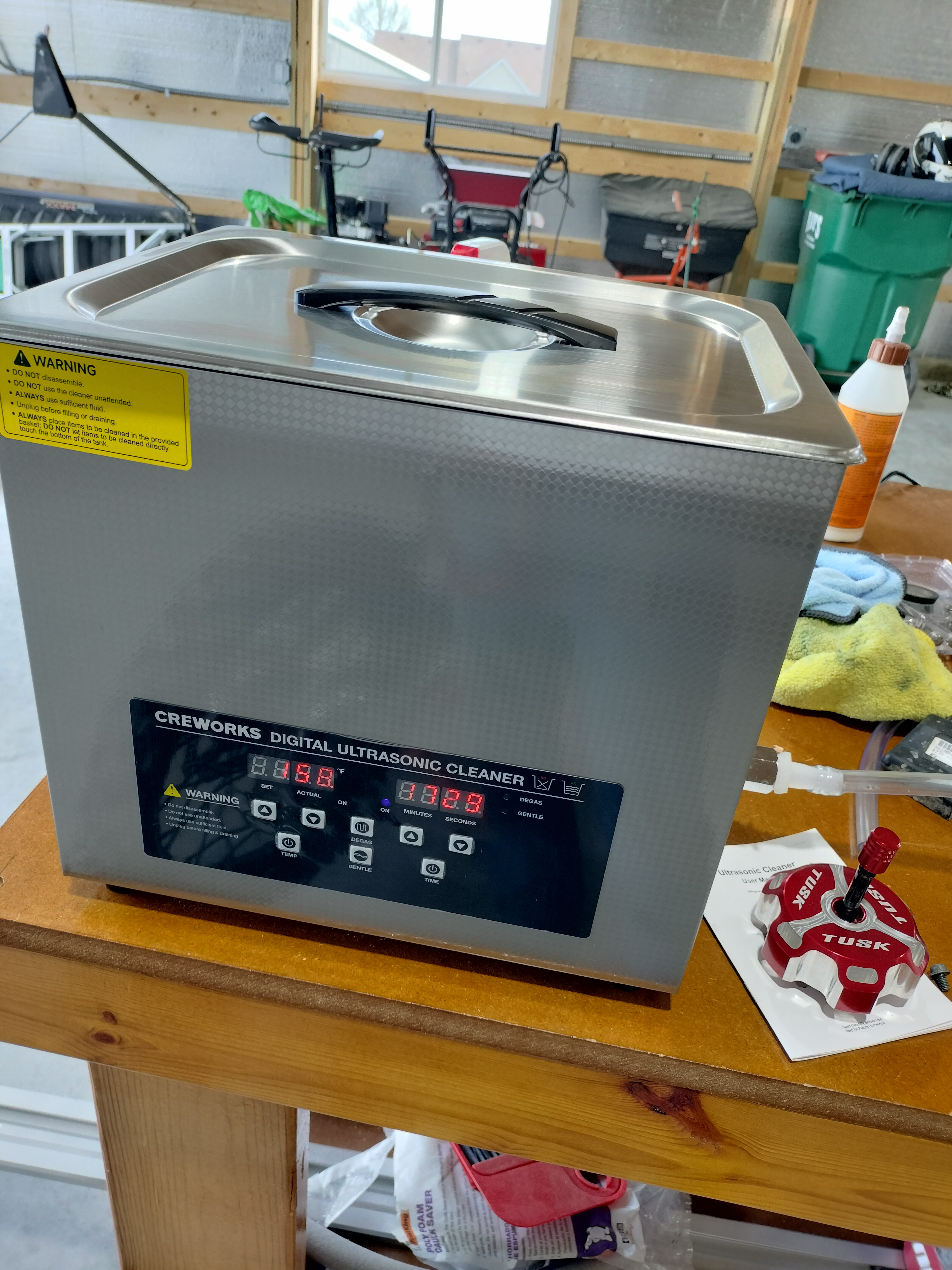

I have the digital Creworks 10l. Heats fast. Works great. A tip on heating, turn on the ultrasonic while heating so it circulates fluid.
