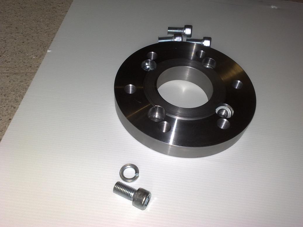

Progress going on.
Brought some plasma cutted iron rings to my friend. He is going to mill and drill. So i will see next week what i get.
made a sketch.
what i have got today.
Going to be an adapter for my yanni
fast sketch for my friend at the millingmachine
Stefan

Hi,
got this evening my adapters from my friend with the millingmachine. Tomorrow morning, I will mount them to the Yanni and then you can have a look.

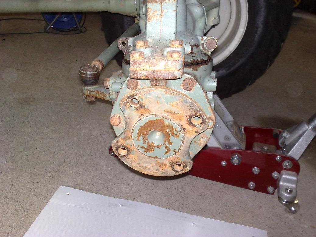

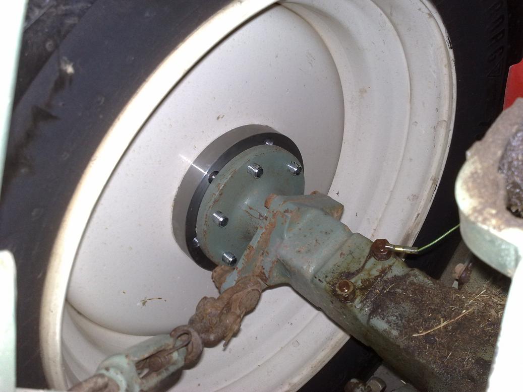

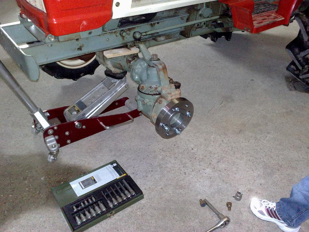

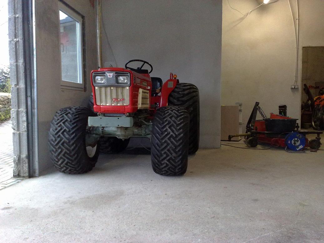

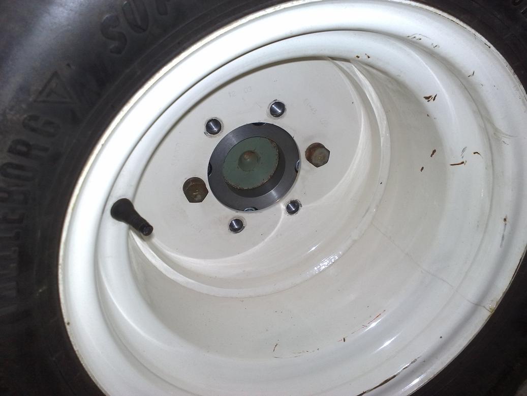

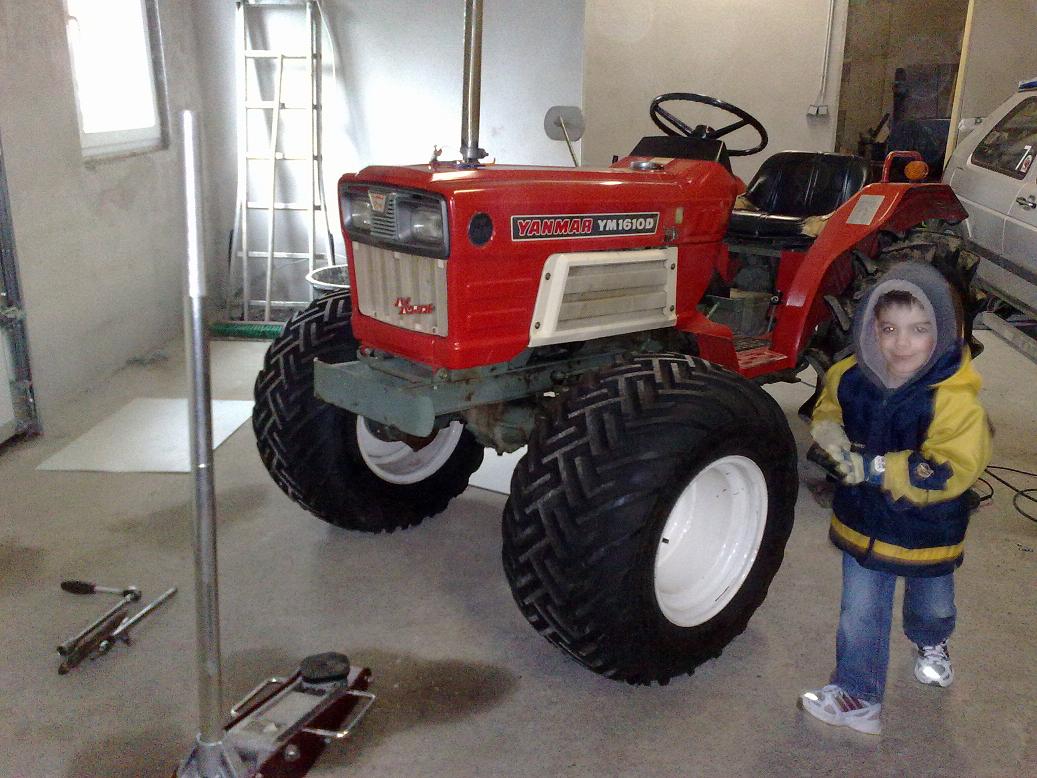

Hello to you all,
waiting has an end. Today i mounted the wheels and made a testdrive.
First mounted the front adapters and then the rear. With the help of my son Joschua and my friend Andreas ( I need them because the wheels are very huge to handle myself).
Before mounted the rear I had to remove the fenders. You know the wheels are huge. Drilles some new holes and mounted the fenders again and then the wheels.
Here you can see the result. My son made some videos an I will try to post them on youtube.
I know you like pics, so here are some attachments:cool:

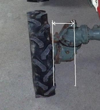

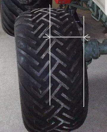

Hi Neat 1500,
had a lot of testdrives yesterday after mounting. I think the frontend will have no problems with the wheels. I think if you have a normal tractor with a FEL the stress for the front end ( stub axles etc.) is a lot of more.
Also something to think about: If you mount the original tires to the wide side, the stress to the front axle is higher than you mount the more wide tires, which are mounted in the middle of the rim. Hope you understand what i try to describe. my english is not the best. see the pictures. so i think if you have a FEL mounted it is harder for the YANNI :cool:

Had a lot of testing thru the last weeks,
drove two times about 20 mls thru the hard forest. no problems with the wide tires.
one pic with fenders.
ps. it doesnt swim. :confused:

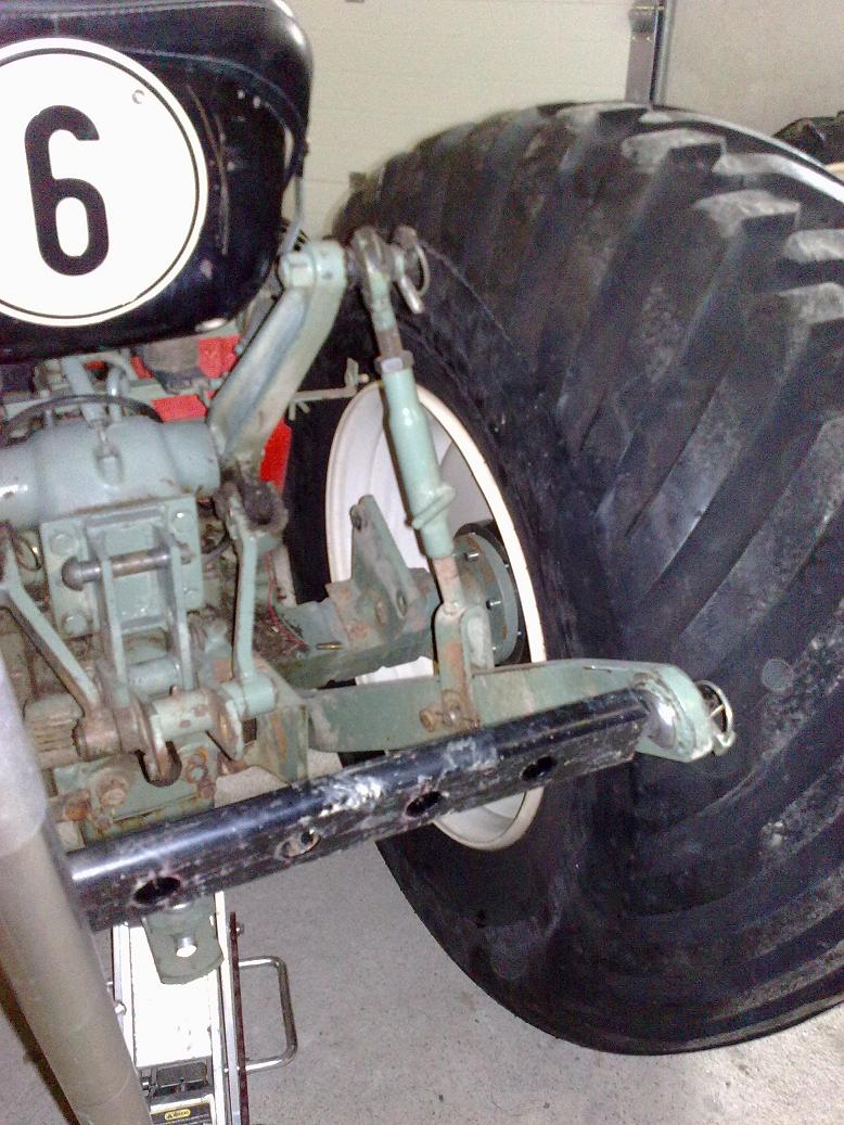

I have a 1610D and am interested in this setup. I have a FEL but would like a little less aggressive tire than my current standard Ag tires. I have looked at Hoye Tractor Turf kit but dont want to go all the way to turf tires with a FEL.
Now, almost a year after your last post, have you noted any problems?
Any clearance issues with front steering linkage/knuckles/frame?
My 3PH arms can hit my Ag tires currently. Did you do anything to shorten the side swing of the arms?

Hi to you all,
at first, I have not noticed any problems at all.
I am actually planing to ad a FEL (selfmade, and maybe in the next winter). The Wheels I bought from a bankrupt Kioti Dealer. They fit on a CK 45. A Sketch is no Problem. While I was looking for some other Wheels I found out the the 4 Bolt Volkswagen Beetle Rim also fits on to the front ( Diam. 4x130) maybe you can take some rims from a dune Buggy?
