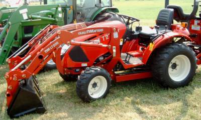

I looked at some of the new tractors at our county fair still going on. One interesting one there being shown by Beverage Tractor was a TYM. It has beautifully labeled and seemingly well-positioned controls. Both JD and Kubota could take lessons on how to set their tractors up from this South Korean upstart. When I upload my pic from my camera (after some more planned in the garden), I'll post a pic I took of it. It has a beautifully sloped hood that allows you to see about to the center line of the FEL. Had a nice digger on the back, too. This particular model was a 27 hp one. Comes also in a 23 hp one. Good competitor to the BX 2320, JD 2320/2520 and NH TZ models as well as Simplicity and a couple other compacts.
The TYM had a Mitsubishi diesel though. Ain't all South Korean; I guess. It has the hydraulic cooler in front of the engine radiator where it ought to go. The front hood opened up the engine area completely, no side panels to remove like on JD and Kubota to get to the lower parts.

Here's the pic I took of the 273 TYM model at the fair. It looks similar to the NH TZ models, but without the huge frame alongside the engine on the NHs. The hood opens up and exposes the entire engine. No side panels like on JD or Kubota. The ergonomics and view from the driver's seat are superb. I've never seen controls so clearly labeled.
JD and Kubota take notice.

Is that BH subframe mounted?
