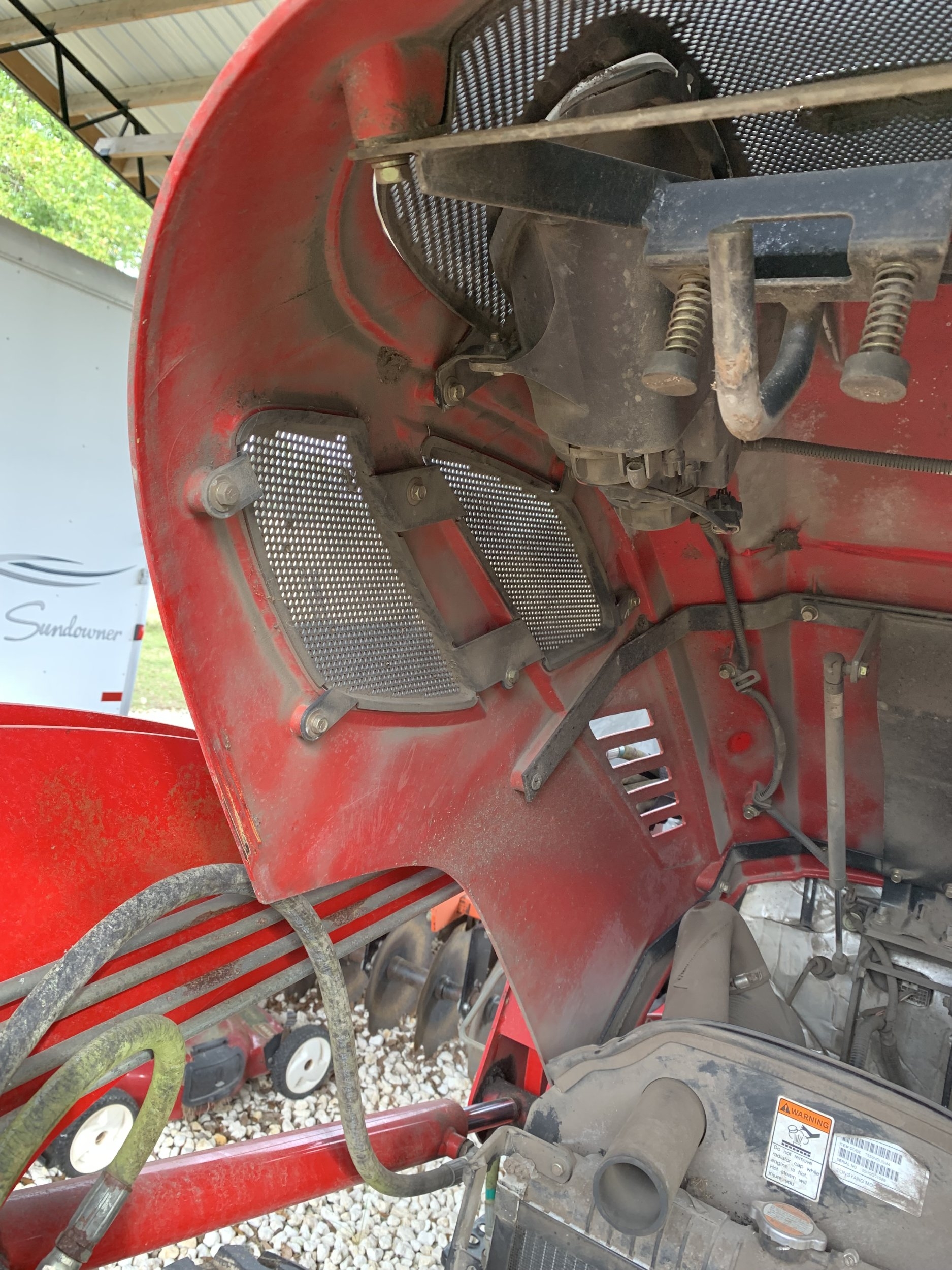

Can you tell me how to pop the latch from cutting a hole in the plastic grill.
/ TYM T353 Engine Cover Latch Problems #7
Jerzen, it's been awhile but if I recall correctly because the hood is somewhat flexible I was able to squeeze my hand under the hood on the passenger's side and remove the nuts holding on the side grill. Then I was able to access the latch. I think they are 10mm nuts, but not sure. I'll try to get a picture for you later today.
/ TYM T353 Engine Cover Latch Problems #8
Jerzen here is a picture of the grill from inside the hood. You can see there are 6 bolts holding it on, but it think I only removed the 2 in the middle and the 2 lower ones. That may have been because I couldn't reach the top 2, or my impatience because I did crack the grill. Though the crack was minor, had I removed all 6 bolts it would not have cracked.
Good luck with getting yours fixed.
