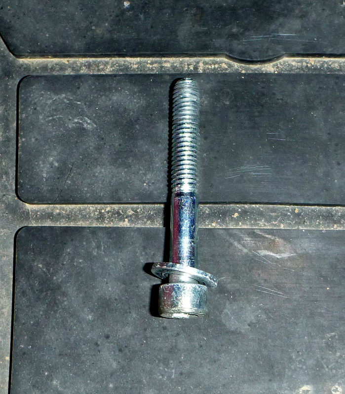

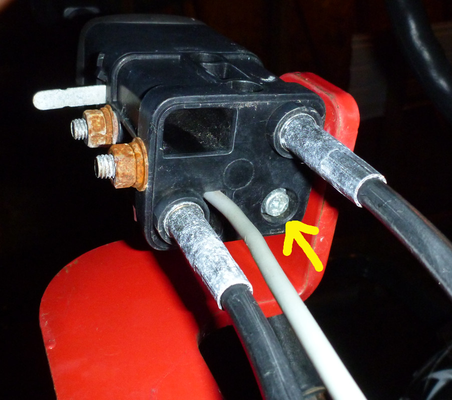

/ TYM T 330 with TYM LT 300 loader #4
Don't buy a new joystick because of a lost bolt. Is it the bolt on the bottom of the joystick, bolt points straight up towards the sky? If it's the bolt in the attached photo (yellow arrow pointed at it), that bolt fell out of my joystick one day while I was moving snow around. I was fortunate though, when I looked down the bolt was laying on the floor mat of the tractor. I reinstalled it tight and haven't had a problem since. I removed the bolt for the photo, since it's out I think I will put some blue locktite on it when I reinstall.
That bolt is socket head M6-1.00 x 45mm. It took a 5mm Allen wrench to remove it. Hope that helps.
Dave

Good morning Dave,
We're getting closer, LOL. Same thing happened to me with the bolt. I found the bolt but the thing that looks like the end of the cable that it bolts into fell out. Its the part that holds the joy stick in place when you operate it. Any help getting one would be GREATLY appreciated. Thank you so much for your help up to now.
Kenny
