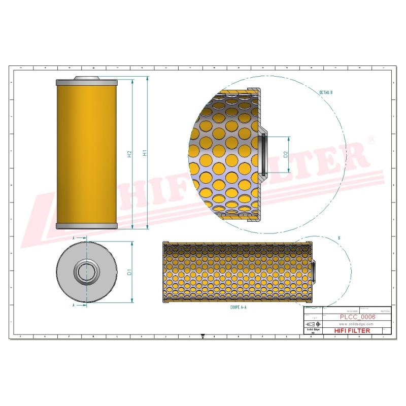

TYM 474 im looking for fuel filter
/ TYM 474 im looking for fuel filter #1
cajnguy61
Jul 8, 2023
1
TYM 474T
I'm looking for a fuel filter replacement to include the valve assembly. TYM part # 15721022100 in there mechanical drawings. I found a TYM dealer that is looking for one for me. But that's day away and 30 dollars over night shipping. If it's the right part anyway. Because they keep referring to it as the water separator. Not the same part cause this tractor has one of those also. Are there other filter that will in its place? Reason I ask is there is a small diaphragm in the mechanical part of it.

Looks like the filter element is a hi filter SN 21586 which crosses to a Kubota P/N 1583143380 which is also a Fleetguard FF5468.
~71mm tall and 35mm in diameter?
