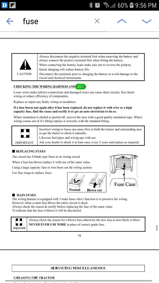

I have very few hours on this three-month-old tractor and the dash went out. No tach, no fuel gauge. The idiot lights come on when I first crank it, so not everything is dead... just the graphics. Where are the fuses and why can't I get my hood to pop?
   / TYM 394 HST dash went out... #2
Pull the hood release harder. The fuse is in a little box behind instrument panel.
   / TYM 394 HST dash went out... #3
This is from T293 manual Screenshot_20180711-215632_Hancom%20Office%20Editor.jpeg
   / TYM 394 HST dash went out... #4
TYM had some issues with the dashes going out. I believe they fixed the issue. I think you need a new one.

it should still be under warranty, so you should let your dealer fix it with the update, so it don't happen again..
