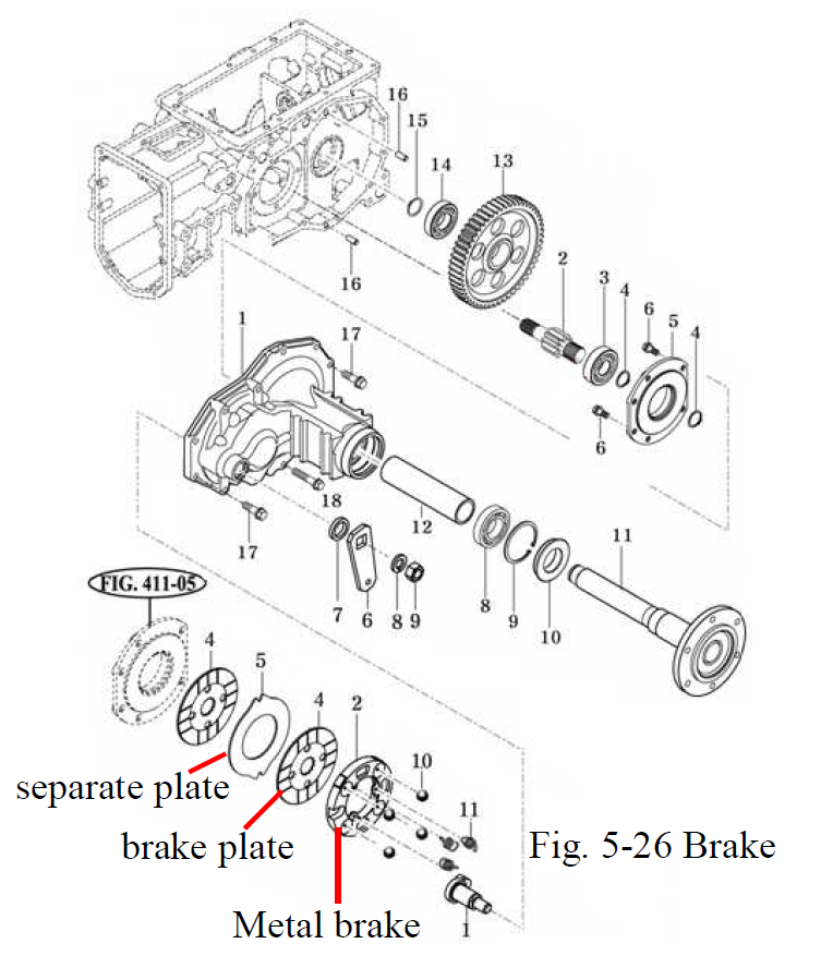

I have a TYM 233 approximately 15 years old
Both rear axle seals are leaking and I thought I would replace them myself along with the barring's. I attempted to remove one side and cant seem to pop it out.
Has anyone ever attempted this on a TYM tractor if it's in fact the same instructions?
Thanks in advance

You'll need to remove the entire axle housing #1. It might be tricky because there are a couple of close fit alignment pins, along with RTV that tends to glue things together.
Keep in mind all the brake parts. I don't know if those stay in the tractor or come with the housing.
Then, should be a matter of taking the snap ring #15 out and slide the shaft out, so you can finally get to the seal.

Thank you ptsg
Looks like this machine is going to get loaded onto trailer and taken to someone who works on them.
