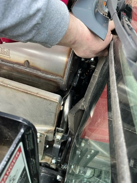

Hello, I have seen a few posts about the TY359 and I would like to put up my experience with the one that I have had for 2 years. First I am not doing a rant, All in all I really like the machine. I had a Kubota Grand L6060 before I got this and I liked it okay but I really didn't like pushing the hydro as hard as I was on my VERY steep driveway plowing. I also have a John Deere 5100E , JD 2520, Farmall M , JD60 and a JD 435... So I like to think I am fairly in tune with all flavors / types of tractors :) . So I will give my negatives first so I can end on a high note :)
Cons:

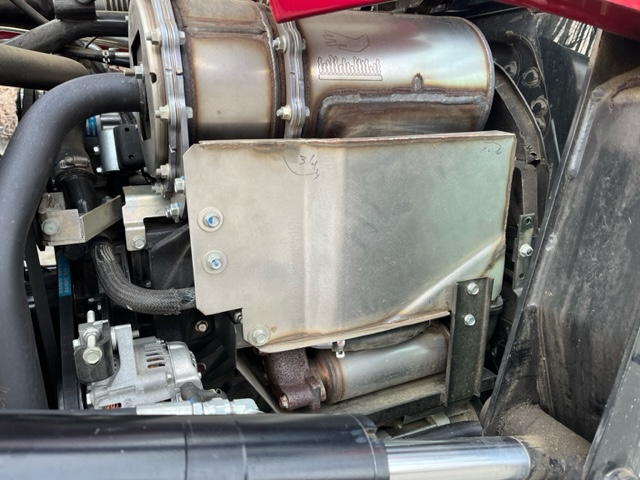

Heat Shield rattle ! O my gosh nothing gets on my nerves like hearing some heat shield rattling! I had to fabricate a new heat shield out of Stanless (I own a machine shop / fab shop so it was an option). The heat shield by the muffler was the first one to rattle. After that one was fixes about a month later the shield by the starter added in and I had to weld a stiffener on that shield. If anyone else is having this issue I am more than happy to show how I solved this.

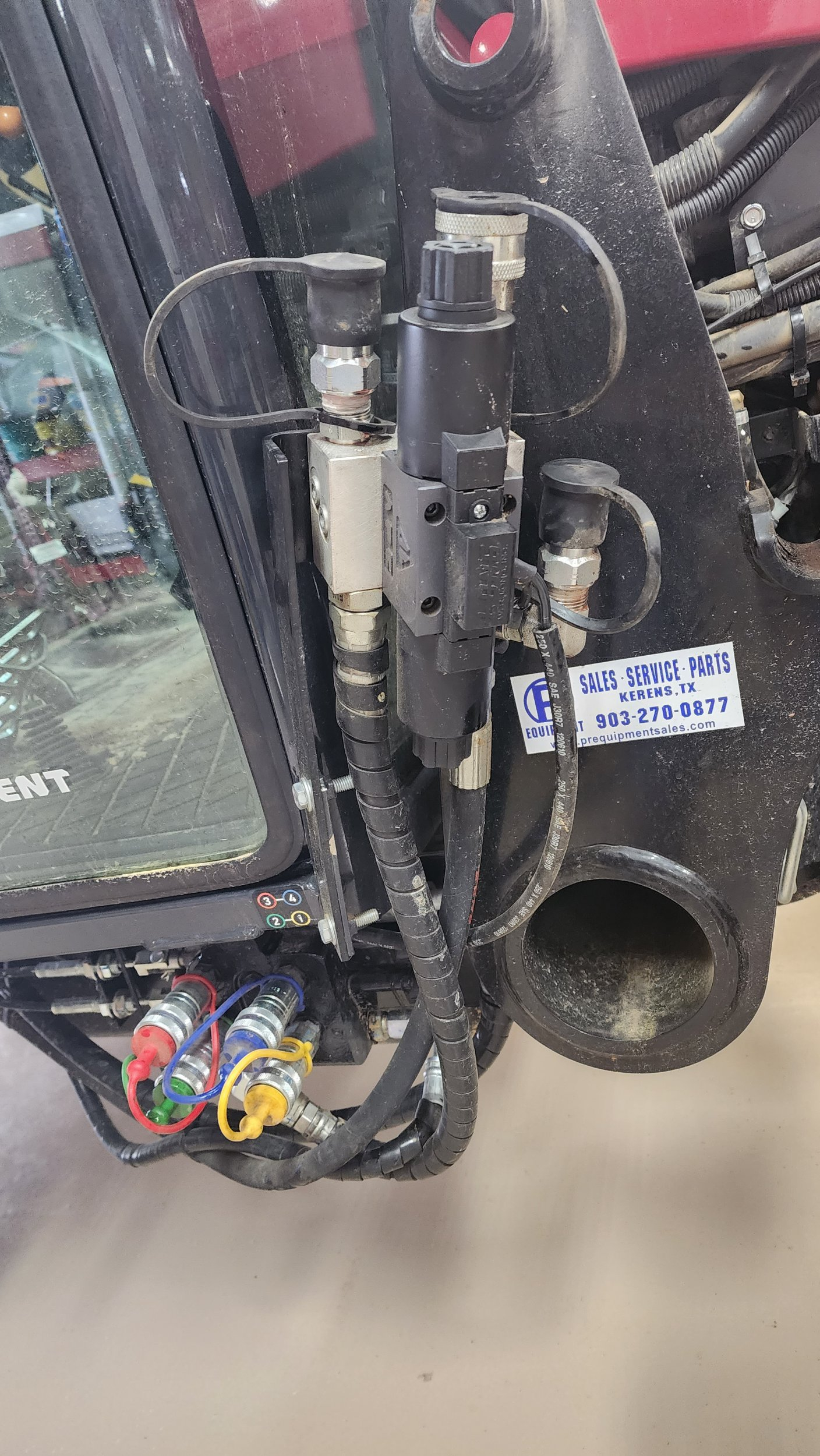

what does a guy need to add the third funtion valve? yt347

   / TY359 Review and comments #37
It's an option that needs to be installed. It's custom made to integrate directly with the tractor. It's a diverter style valve which means it limits function to the specific motion so you can't curl and use the third function at the same time. Not a big deal.
I opted to go with the WR Long live 3rd function. It allows full articulation all at the same time. I installed it myself.
Other reason I went this direction is I have a hydraulically run front brush cutter that requires it.
Your dealer should be able to get the proper kit for you either way. My dealer got me the proper WR Long kit.

Sorry, I told you all I would post a few pics of the heat shield that I made for mine. it has been on there for a few years now so I think it's going to hold up! The material is 316 stainless .090" thick. it was some scrap I had around the shop, We call it availability engineering here šŸ˜€. The big takeaway from what I did was adding the support in the back to the bolt on the muffler (if you can call that monstrosity a muffler).

#40
That is the heat shield to protect the hood from when the ā€œmufflerā€ / filter goes into its clean out cycle and burns everything. I may have gone a bit over the top but the original one would start vibrating like mad at some engine RPM’s.
