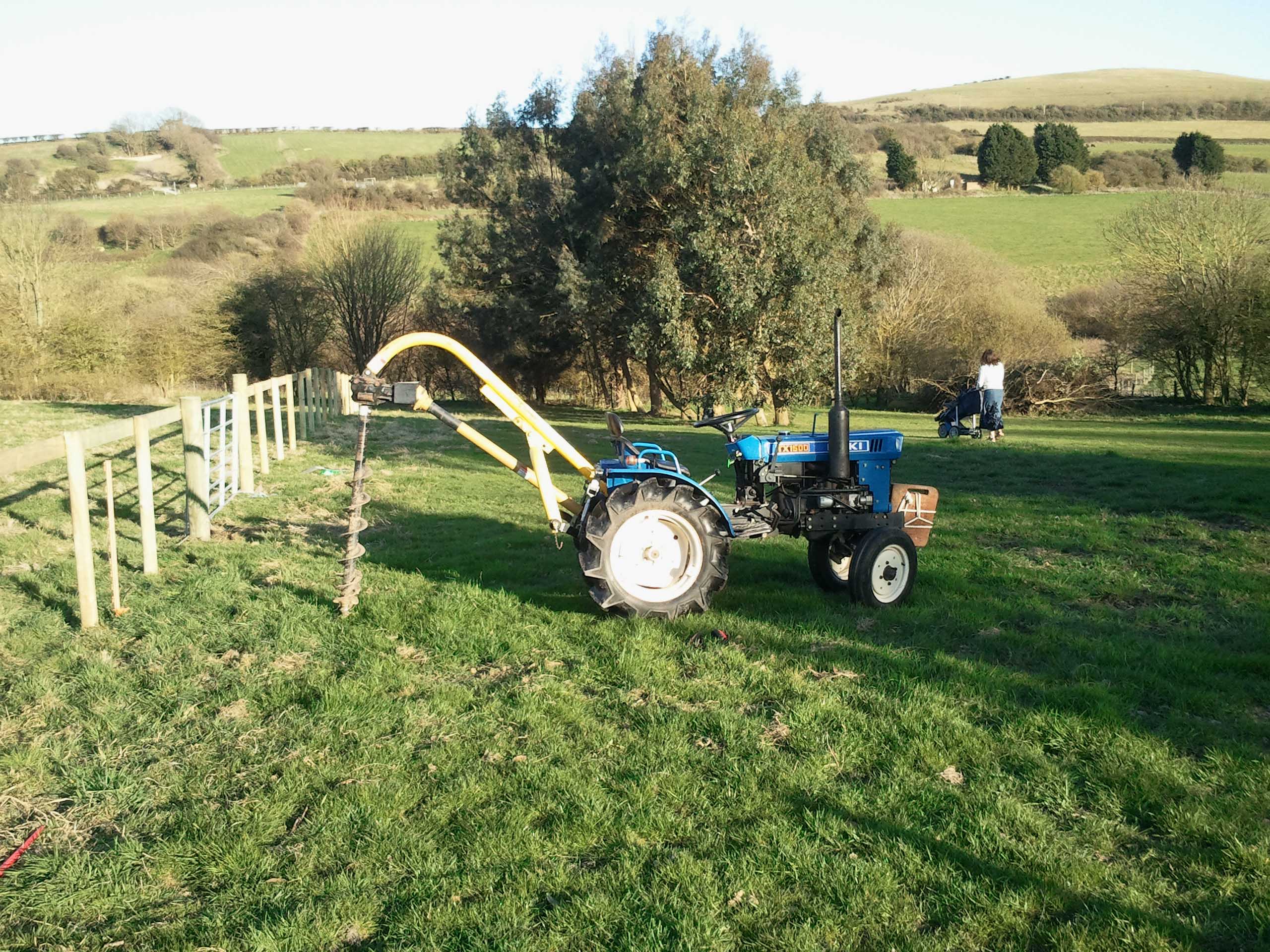

Here's another photo from doing some fencing a couple of months ago.

Glad to help! If you need any other pages from the service manual please let me know, I am happy to help. I'll see what I can find from the section about the starter. That a very nice tractor! I am just about to purchase a post hole digger like the one that you have on the back. I was wondering how it worked for you. I have to put in about 20 posts for a pasture fence, and I was not sure how the tractor would do. It looks like you have a very nice set up there. Anyways, glad it was a help!
/ TX1500 Rotavator PTO
Thanks Mitch, not sure if that universal is quite right, but will go have a look at the splines to check.
My post hole borer is a US made one, Greenline, there's a thread on them here: http://www.tractorbynet.com/forums/attachments/37291-looking-feedback-greenline-post-hole.html
In truth it is just slightly too big for the 1500. The geometry of the link and borer is such that to get maximum depth, the borer only just clears the ground when raised. Its fine for me, but you have to take care when driving. The tractor is plenty powerful enough for it though, you don't need much power on at all. The hydraulics not so great, but it stops you forcing the tool faster than it wants to go. The only other issue is the lack of reverse PTO, so if you jam the auger, you can't 'unscrew' it out. I just unpin it and use a steel bar to back turn it. Happens a lot here because of the hawthorn roots and flint everywhere.

I found the pages in the service manual that reference the starter. I am not sure if they will be helpful, but it is worth a try. They are listed below. Sorry for the quality, but my digital manual is not much better. Hope this helps, and thanks for the information on the post hole digger. I am going to pick mine up this week, and it is very similar. I had not considered the ground clearance, but I actually modified my lift arms a bit by adding smaller lift arm leveling assemblies. I also am attaching the pages from the service manual, and I hope that it may help you a bit, at least with the breakdown of the starter. Take Care, and post some more photos when you get a chance!
#9
Mitch, this stuff is gold! Many thanks.
I didn't even think of shortening the lift arms, but I don't think it will quite solve the problem with the borer.
By shortening them I then wouldn't get to full depth on the auger, and I need that more than I need ground clearance. What is stopping the borer arm lifting higher is not actually the link, but the borer arm support (the bit linking the bottom of the linkage to the arm) jamming as it gets to the top of its travel.
I could grind it out so it doesn't jam, but it has two good side effects. 1. it means you can't accidentally lift the attachment too high and bend the PTO, and 2. it makes the hole borer mush more rigid and stiffer when you need move the tractor with it attached.
I should mention that I only used the borer for the strainers and gate posts (6-8 inch) for the 3-4 inch round posts I just rammed them by hand - harder work but quicker.
