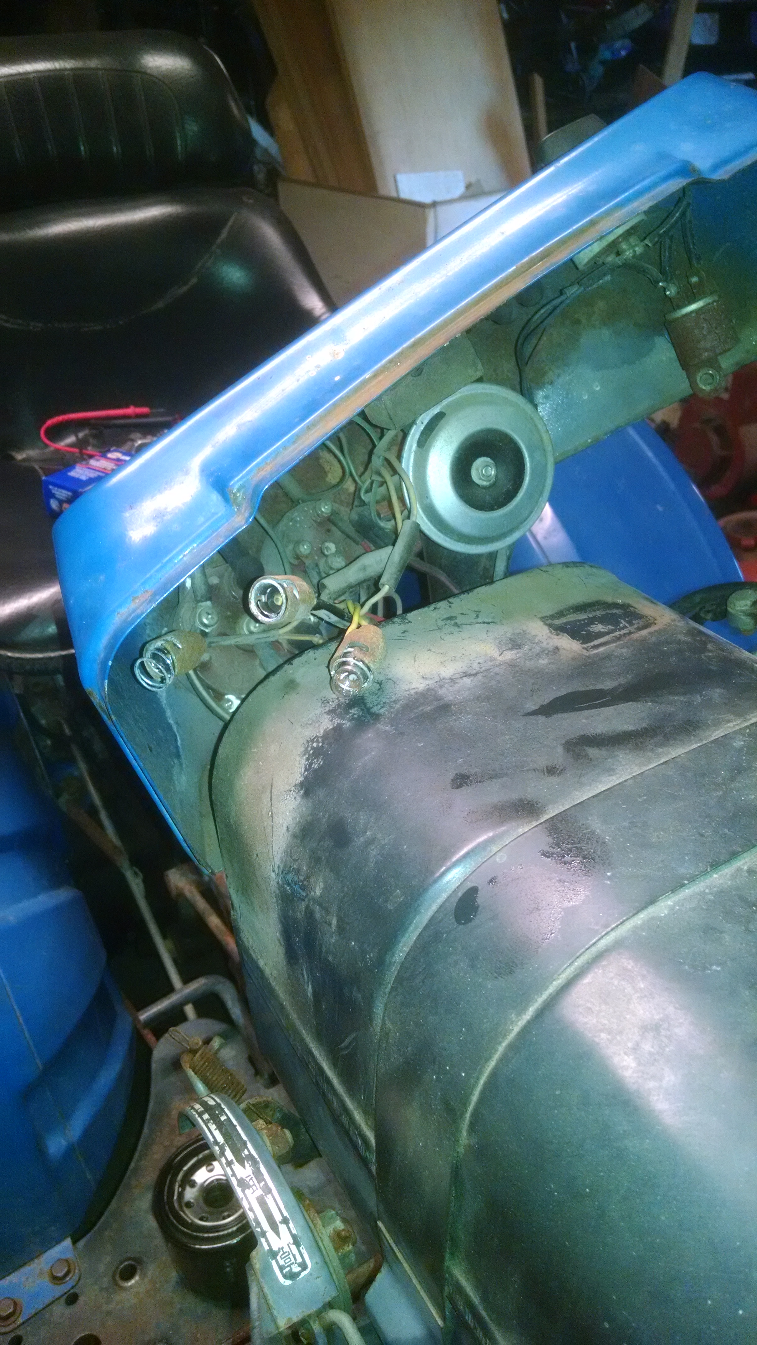

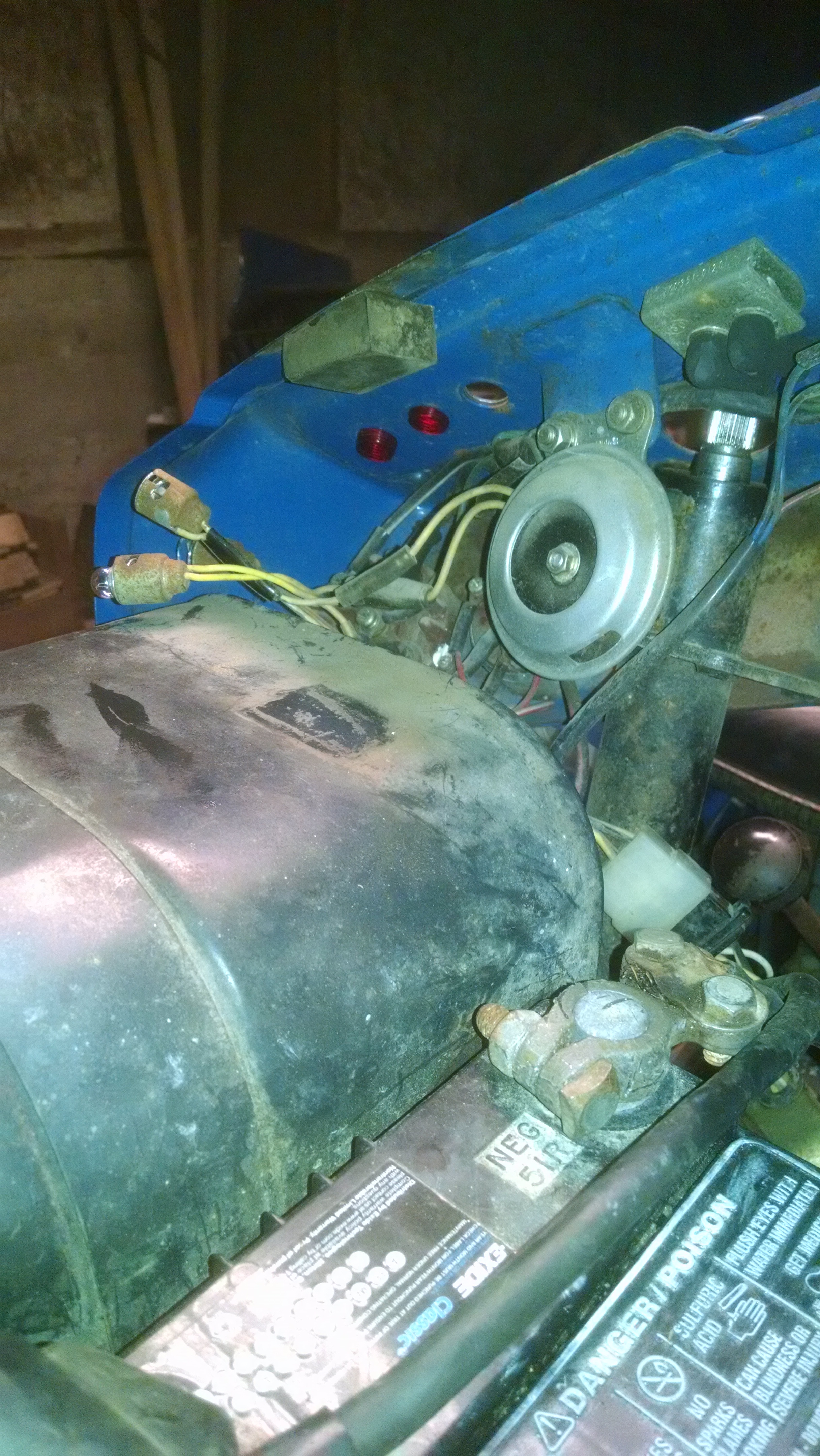

When I bought my TX1300 a month ago none of the dash warning lights worked. Thanks to some of the replies on this forum I was able to finally fix them. I ended up removing the dash to get to the lights. Hardest part was removing the steering wheel with a puller. Once the wheel comes off you do need to remove the voltage regulator as well. It then slides up with plenty of room to get to the bulbs. It turned out my oil and generator light bulbs were blown. That fixed the generator bulb problem but the oil light would still not come on. It ended up being the oil pressure switch that screws into the block behind the oil filter. I was able to find one at NAPA for $10. The NAPA part number is OP6158. I found the bulbs on ebay for $1 a piece. They are BA9s base, 12V, 3watt. Just search for them and quite a few come up. I am assuming the water temperature light works, the bulb is fine and I have power at the switch.

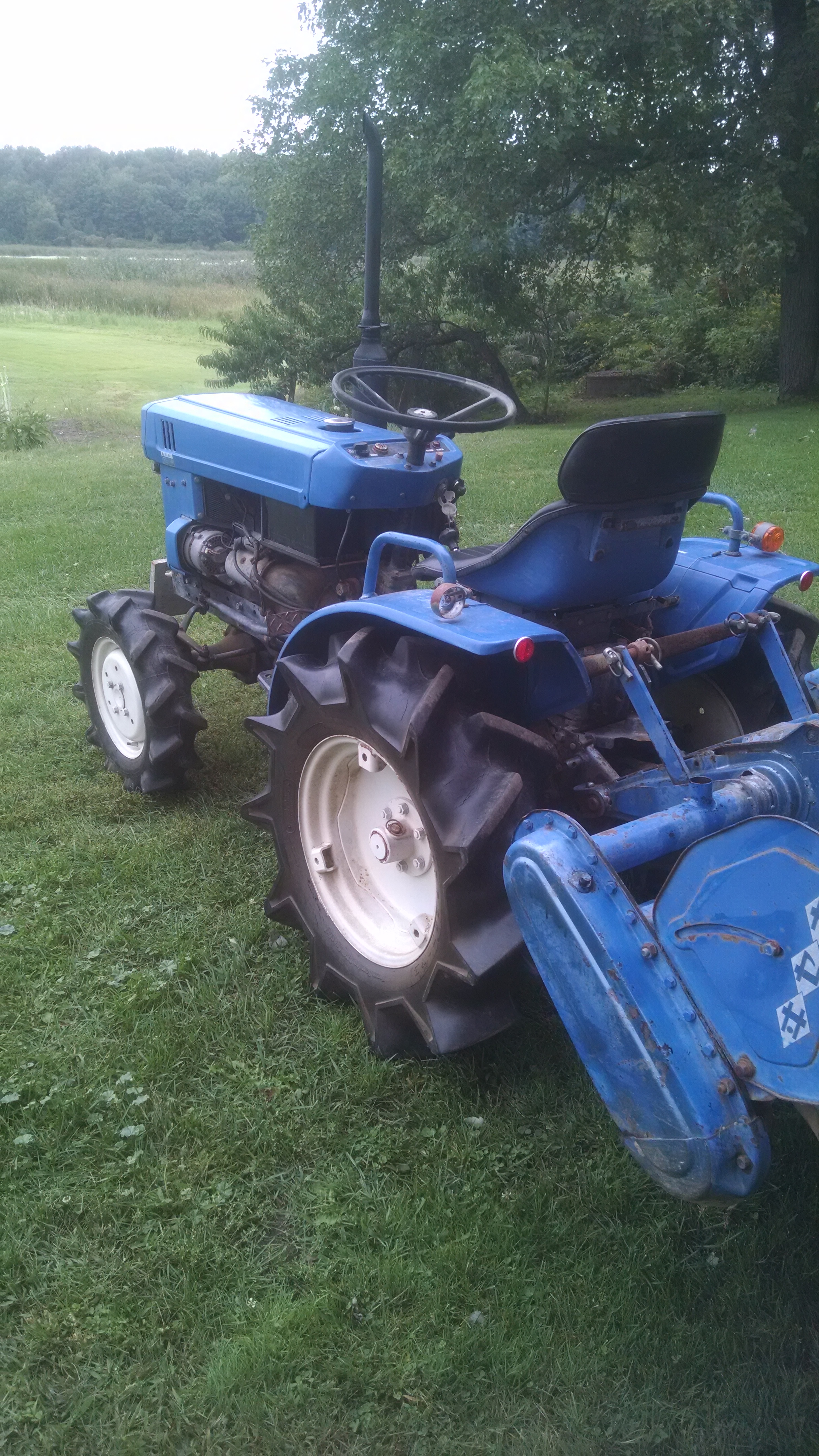

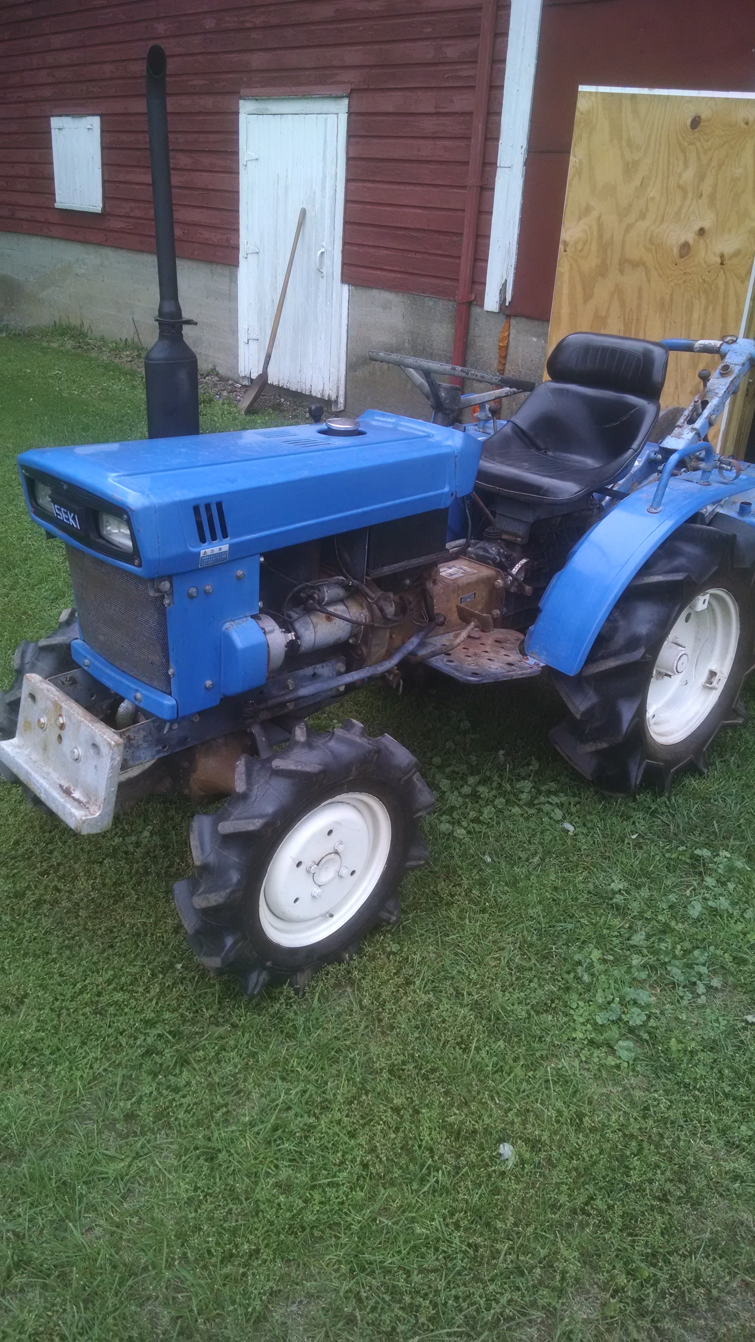

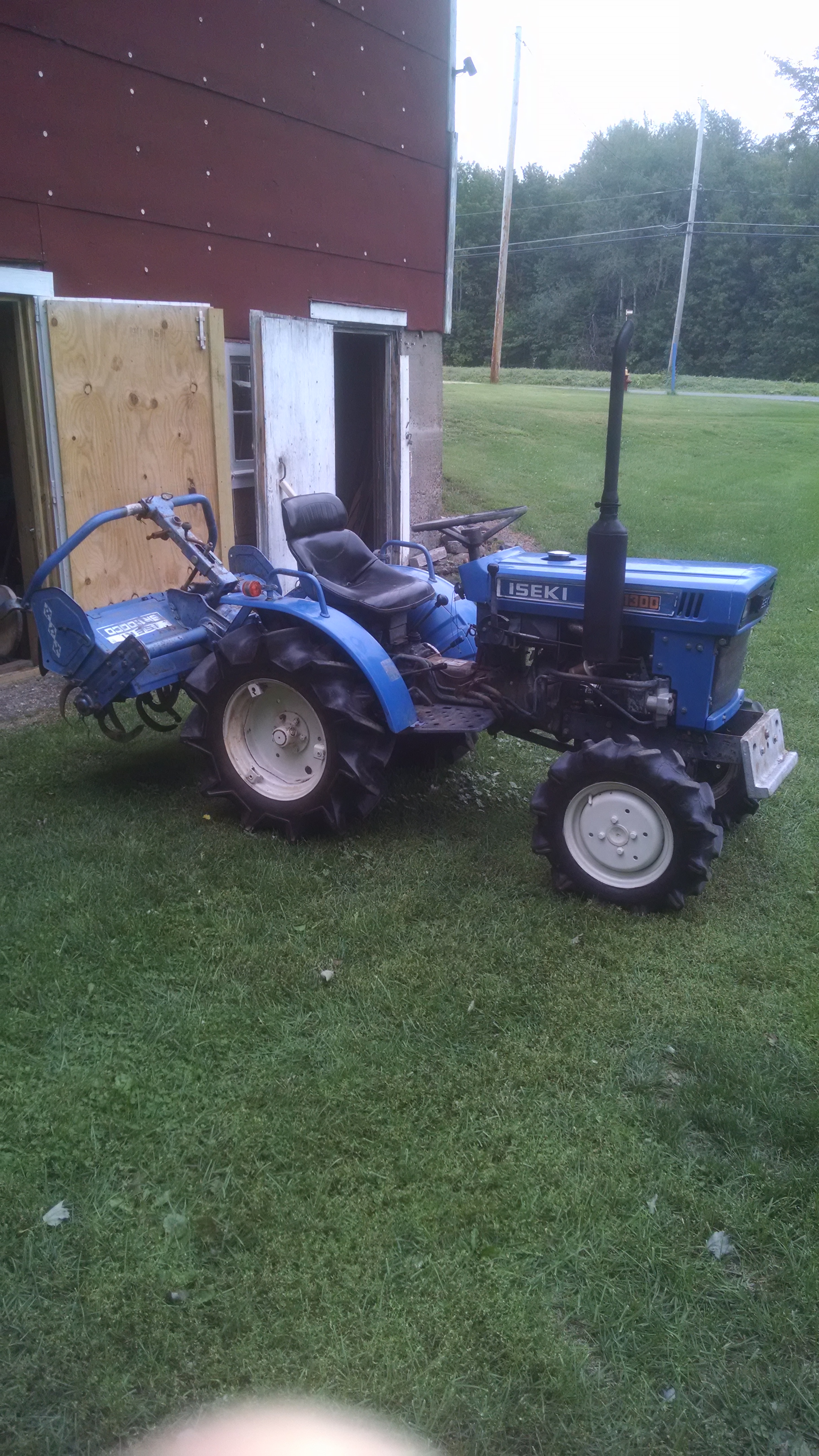

I have included a few pictures for those of you interested. The guide wheel bracket on the tiller was bent pretty good when I got it. Looked like someone tied a chain to it and used to pull something. I brought it to a local metal fabrication shop and they were able to straighten it pretty good. I still need to install one of the actual wheels which is why it is missing in the pic.

Your tractor looks really good, almost everything original and in good state. Except the exhaust pipe (but going up is way better that the original, i would love to have that), and the oil pump for hydraulics looks a bit different. Thanks for sharing photo's.

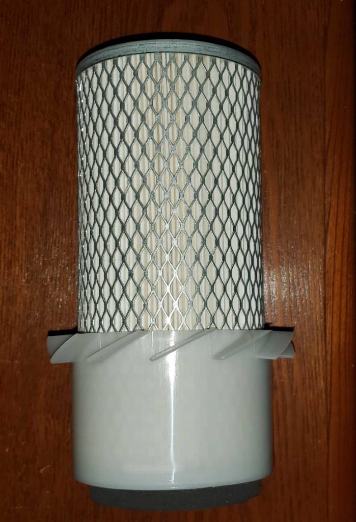

I have not found an reasonably priced air filters. Looks like I am going to have to spend some money and get what is available.

About the air filter: around here (europe) i can get them for something like 12 euro. Just saying this as a reference of what you can expect. Here is where i bought mine:
http://traktor60.hu/japantraktor-alkatresz/japantraktor-szurok/levegoszuro-mitsubishi

As far as the air filter goes, I called a US company today. They want $42(38 euro) plus $20 shipping!!! I see they are much cheaper in Europe but I cannot find any of those companies that will ship to the states. It seems to run just fine with the old air filter so I will continue to use it while I search for a cheaper one.
/ TX1300 dash warning lights finally fixed #7
Got a cross for your air filter, Stens # 100-465. Amazon list just over $19 for it and if you go to Stens site, it'll give you a lot of the cross references that it covers. I've had my tx1500 4x4 split for input shaft on trans with coupler that had lost our broken roll pin. Brought like that for $1800 and spent $500 on parts and 2 hours time. Brinkley Hurst can get most parts since these will cross to Agco. My 4x4 is a White 17 field boss and a 2wd sold as a Bolens 1502. Both gear drive. A buddy of mine has a Bolens 2wd hydro. Have parts manuals for #'s if you need some. Hope this helps.1568682511248~2.jpeg
