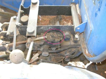

I have a TX1300 that I have not started for a few years (work got in the way of life.)
What is the best way to restart it without damaging it? I have thought about pulling the glow plugs and spraying some WD-40 down the cylinders but, I don't know what the torque is for them.
Where can I find a list of the fluids for it? Probably should change them all.
Also, there is a valve under the seat and I have no clue what it does.

I Dont ever Remember seeing the Valve before in the Pic on the Smaller One I traded off, Not saying it wasn,t there , But sure Never had to mess with it .
As Far as Manuals contact A Member here Below He should be able to Get You a Manual of a Similar US model , There not Cheap but What is These days, :D . As Far as The Fluids Hopefully Someone with A Similar Model will Come along soon with Info . Best of Luck, Bob

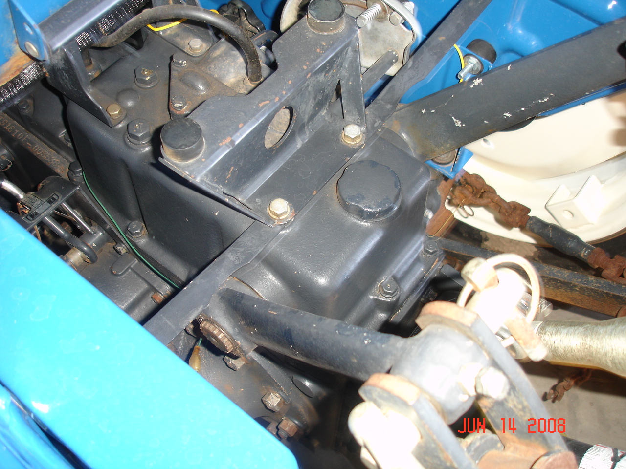

I also have an Iseki TS1610F. Here is a photo of the underseat area. No valve like that one exists there as you can see. What valve are you talking about?
   / TX1300 Advice needed #7
Should be a manual override for the electric solonoid to operate an auxilluary implement.

63DH8 is correct, it is the lowering speed adjustment for your 3 point hitch.
