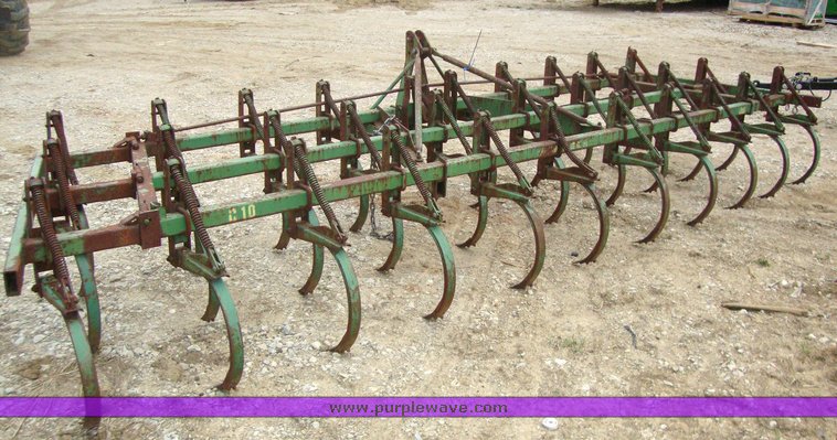

i have a pic that in a cultivator shank has 2 layer.
Why the shank is made of two layers?
/ Two layer cultivator shank #2
Allows more flex or spring.
Inner layer is under tension, and the outer layer is under pressure in actual.
are two layers material different?
/ Two layer cultivator shank #4
That looks more like chisel plow shank , runs deeper than a cultivator . Actually 2 layers stiffen it up alittle and still allow some flex .
/ Two layer cultivator shank #5
This appears to be a john deere C10 leg . Light field cultivator , This type flex too much and dont penetrate as good as a heavier single shank as a chisel plough and tend to straighten out with age .

Bending stiffness is equivalent to the modulus of elasticity and the moment of inertia. In the case of the flat bar which is the actual cross section of each cultivator shank at any point, the moment of inertia is width x thickness cubed / 12 (English measures). If it was a single beam for example 1 inch by 1 inch for easy calculations, I = (1 x 1)/12 or 1/12. In this case you have 2 beams each 0.5 thick. The cube of 0.5 is 0.125 so each beam has a moment of inertia of .125/12, but you have 2 independent beams stacked so it is additive or 0.25/12. The formula is M=EIk where M is the bending moment, E is the modulus of elasticity for the material being used, and I is the area moment of inertia. k is the resulting curvature. Two thicknesses stacked together are 1/4 as rigid as 1 single thickness unless they are completely fused for the entire length.

why 1/4?

Excellent explaination, I was not aware of this formula. I will have to retain this for future reference.

It's from the calculation. One cubed is one. One half cubed is one eighth. Double one eighth (two thicknesses) and you get one quarter. It's the same way with typical leaf springs (not the single leaf the Chevy Nova used). Stacking thinner layers results in a lower spring rate or softer ride than one heavy leaf. I am not sure about the cultivator shank but I believe they use multiple leafs to get more action out of the shank therefore breaking up the soil better. I have an old cultivator with single thick shanks but then a triple large coil just before it clamps to the frame to give it ground busting action but the shanks were expensive to break. They aren't expensive anymore because the company (Case) realized it was a bad design and quit making it, and service parts, long ago. I pulled it out of a fence row to use for some special jobs where I need a small cultivator.
