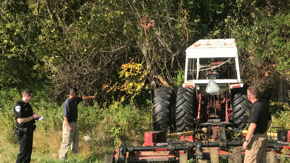

Ag tractors don't have a seat switch.
Many guys start their tractors that way. Not a problem if you pay attention. Maybe not a great idea for an 86 year old.
Or even a 46 y/o, for that matter. Especially with a tractor that size with a full cab and dual wheels on the rear! Have to move pretty quick to jump out of the way.

No, you still don't understand. Shorting the starter at the starter basically connects the solenoid right to the battery. The starter is already, always connected to the battery.
Amazing how so many people think that an 86 year old is going to recover and get better.
I most certainly do understand that using a screwdriver across the solenoid bypasses all of the safeties, that is why it is stupid way to start a tractor. I have done it on cars in younger, poorer, stupider days. I was simply correcting your assumption that I was referring to a "seat switch" when I was not.

Dang an 86 year old man still climbing up in the cab of that 130 horse tractor and so many people here ranting and carrying on about the way he was starting a 45 year old tractor and being so pious about why it may have required a less safe way to be started. He neglected to engage the parking brake when he got down from it unfortunately, it happens I wonder how many of the posters will still even able to climb up those steps if they reach his age.
No one not directly involved has any idea of why he didn't put the tractor in neutral and engage the parking brake.

I have a friend that does that probably at least five times a day, 365 days a year, and I personally know he has done that for twenty five years. Pobably twenty five years before that. So that's 45,625 he did that in the time I knew him, without killing himself or anyone else. Unsafe?

Of course bypass starting is unsafe. There are always outliers but the risk of not having everything in place for a successful start is not diminished.

I don’t understand your question. These guys were critically injured while bypassing the safety start circuit of a tractor while standing in the travel path of a rear wheel. If you are trying to claim that is not an unsafe activity I refuse to engage in that debate. Beyond that I have no idea what your point is.
