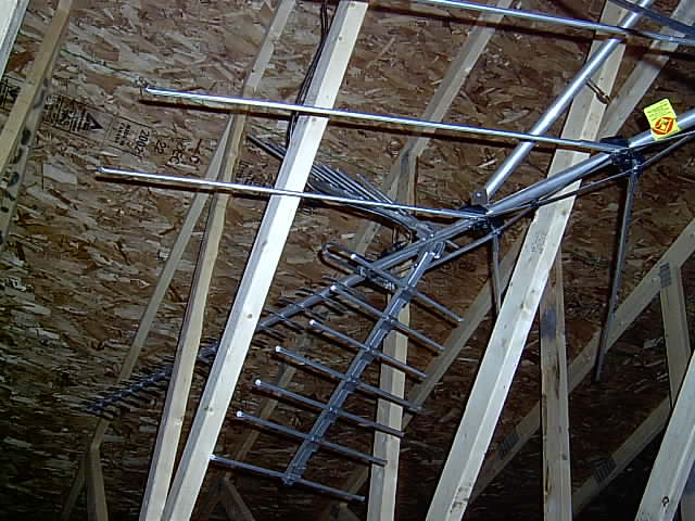

I have one of the large rooftop antennas, but I mounted it upside down in the garage attic. I bought one of the larger models-- I think it has a range of something like 120 miles. I was told you lose half of that range when you mount it inside, but I'm only 20 miles to the towers of the local TV stations in Youngstown-- on a good day I can also get Cleveland, Pittsburgh, Steubenville, and Erie!
Not only do I not have to pay for a dish or cable, but I get great reception without the eyesore on the roof!

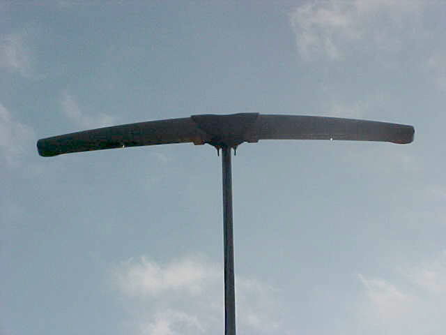

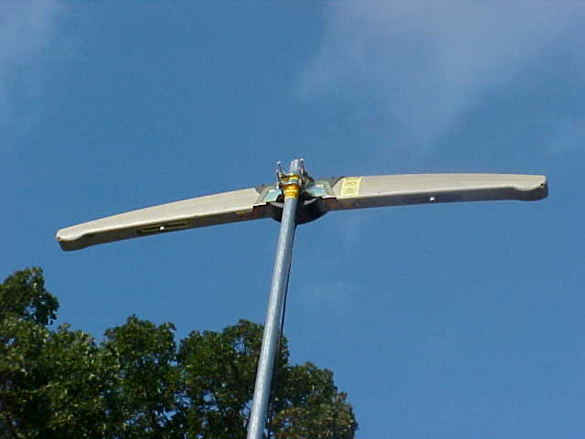

This antenna can be put in your attic or installed outside. It comes with a Booster and we get 8 Local channels in about a 200 mile radius. Good clean picture and very little wind resistance. I have attached a picture of it. It is made by RCA and we got it at Lowe's if I remember correctly. I think Home Depot and Wal-Mart have it as well.
Jim
