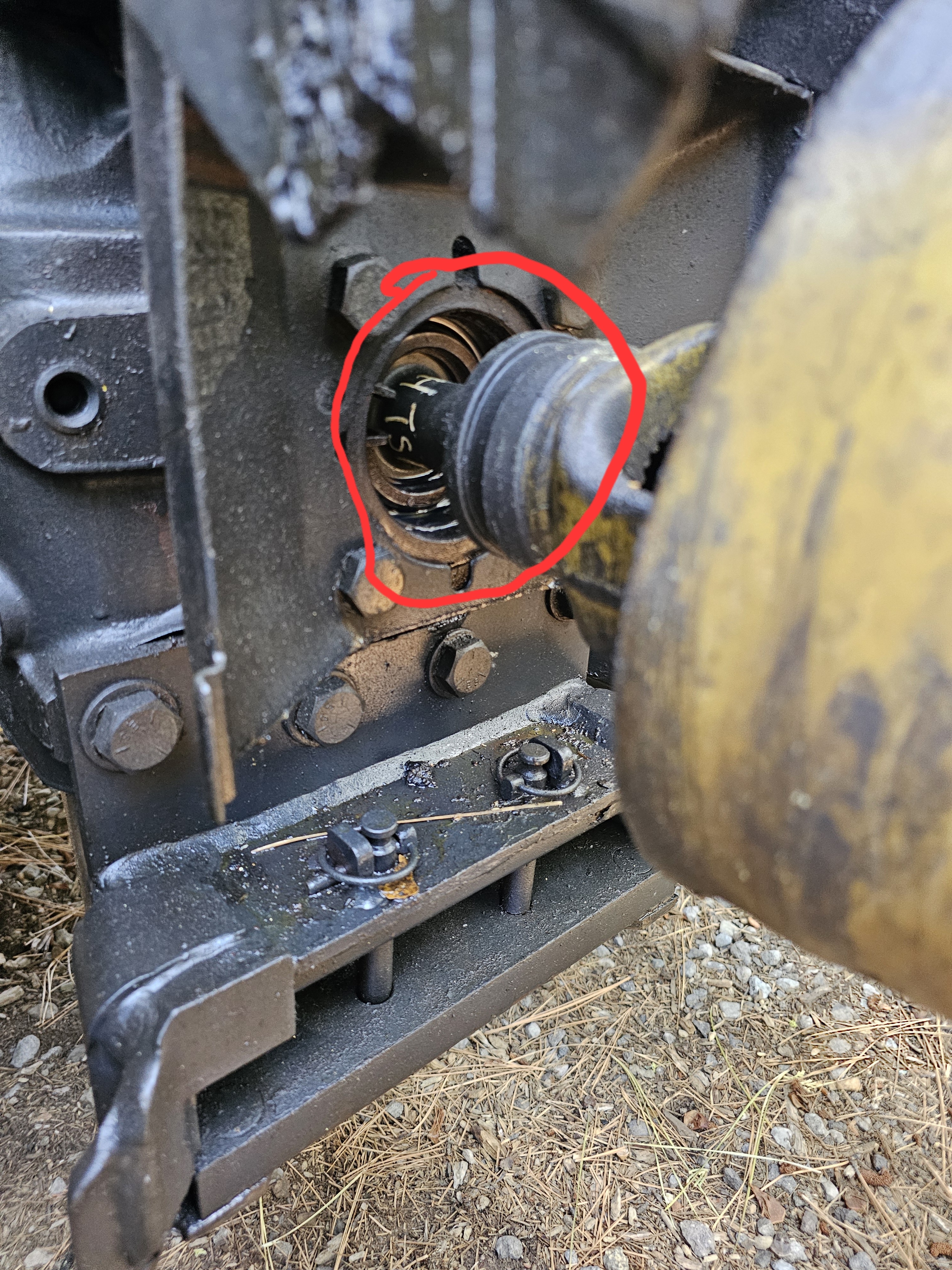

   / Tv 145 pto leak #2
Looks like a bad seal.
   / Tv 145 pto leak #3
Is the style that you can swap from 540 to 1000 and back by swapping the end shaft?
There does look to be a gasket inside the bolted on retainer.
I don't see a retainer in your picture.

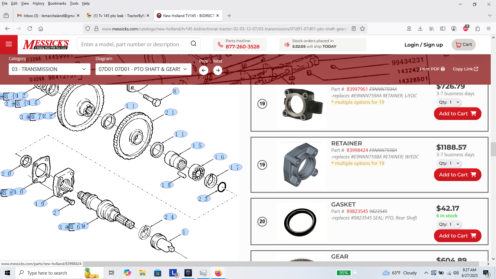

I'm just guessing here, but it looks very similar to the rear end housing from the 5000 series tractors. Based on this diagram I would say you can get to the seal after removing the PTO guard support (assuming that's what's covering the seal retainer) then the retainer itself. Again, this is just a guess.
   / Tv 145 pto leak
thank you for the help and diagram. that would be awesome if its as easy as removing the PTO guard support and retainer to swap it out
   / Tv 145 pto leak #6
I make no promises in that regard, but it looks like an obvious starting point.
   / Tv 145 pto leak
you can electronically select between 540 or 1000 rpm on the dash.
there was an extra shaft sitting on the cab floor when I bought the tractor, I have never used it
I have only ran it on the 1000 rpm setting
