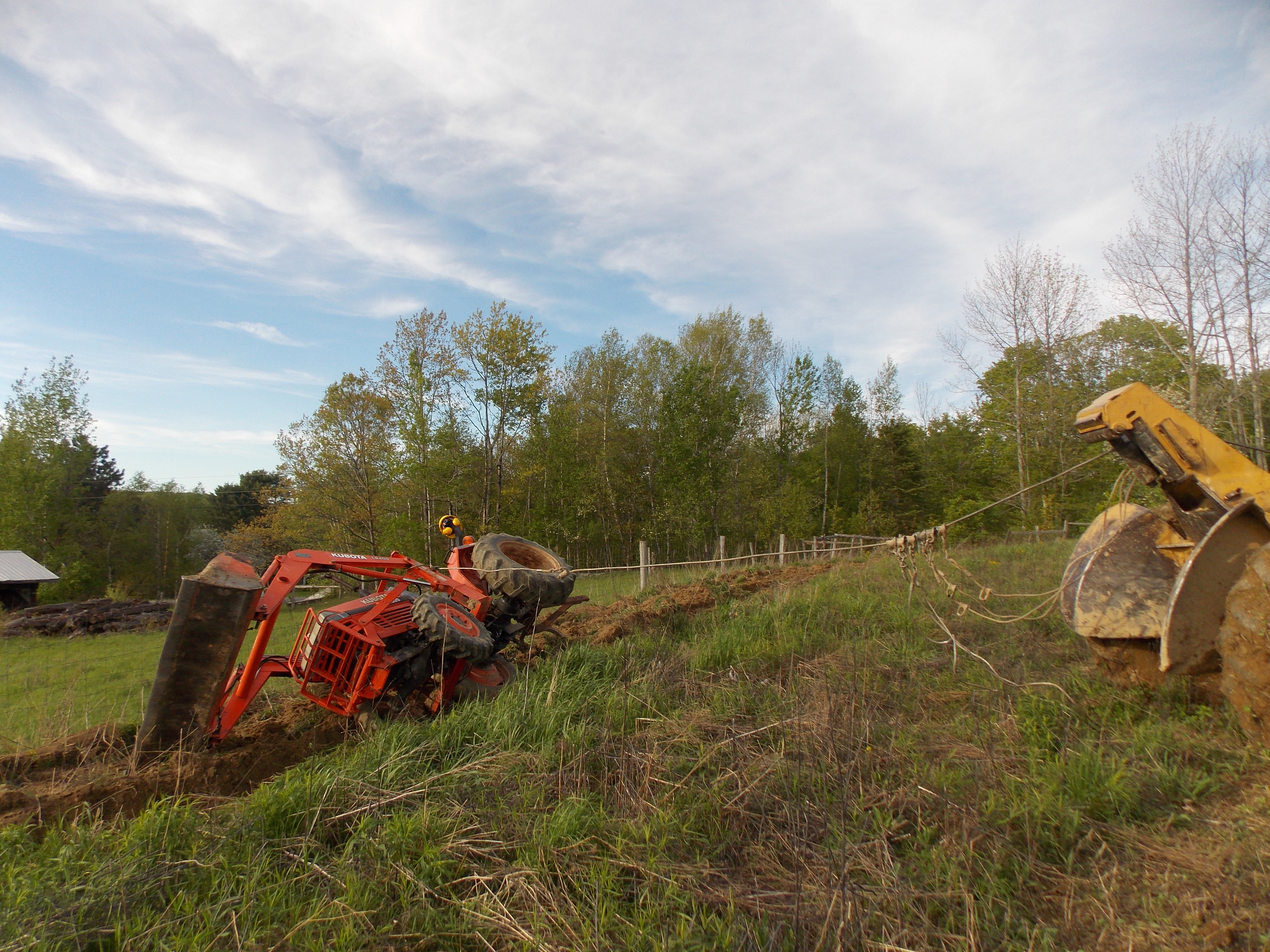

Pulling to the side and not tracking right is one thing,,,,,,,,,,,,,,,,,that's another story. Broken Track you better caaalllllll somebody! :ambulance:
I would like to say that it happened fast, but that would be a lie. I felt the tractor start to go over and just stepped off it like it was in slow motion, funniest thing I ever seen on a tractor. Of course this is the first time I ever flopped over a tractor before. I have been operating tractors, bulldozers, skidders, log loaders and excavators for 40 years and never put one rubber side up.
It was kind of funny how it happened. This is on a pretty good hill that is not apparent in the photo, and I was closer to the fence then it looks too. I had the bucket up so when I rounded the corner I would not mash it. Then the front tire popped out of the furrow, so I cut it back and when the front wheel dropped back in, she just kept going over; like I said, in the slowest way imaginable.
It was not a big deal. I had the skidder right there to put it on its wheels again.
Now off all the machines I have had in hard spots, I would have thought I would have rolled the skidder by now. More than once I have thought, "Now how am I going to get out of this?"
