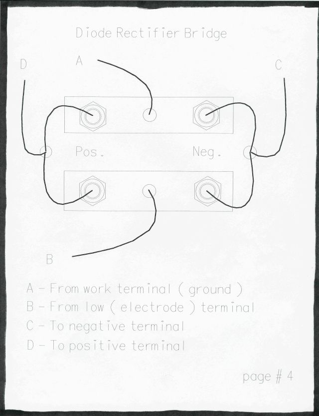

I'd do it with four diodes, making a diode bridge. You run the two AC leads to two corners and pick up your DC from the other two. Would be a little bit lumpy but you could series the proper number of 12v batteries to smooth it out.....

Be careful of the voltage rating of the diodes. If you use a bridge configuration ( 4 diodes) then they need to be rated for at least the peak open circuit voltage. On my 180 amp buzz box, I have 85V RMS open circuit. This works out to approx 120V peak. At least on this welder the above mentioned 100V diodes will likely eventually fail. I would use at least a 200V diode.

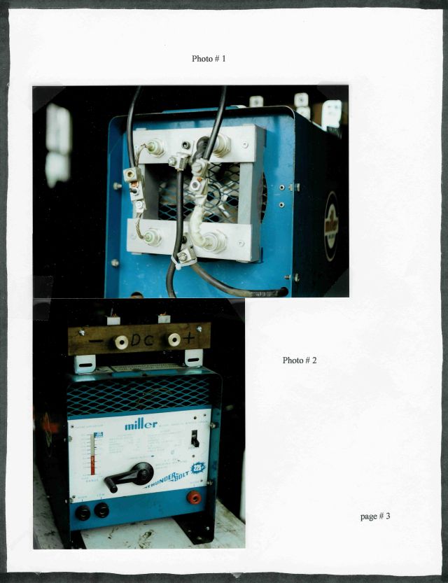

The diodes will generate some heat when welding. You should use stud mount diodes, mounted in a piece of aluminium.

Does anyone have a wiring diagram for this change over????
Here are some instructions and diagrams that were posted on one of the welding forums a while back.
