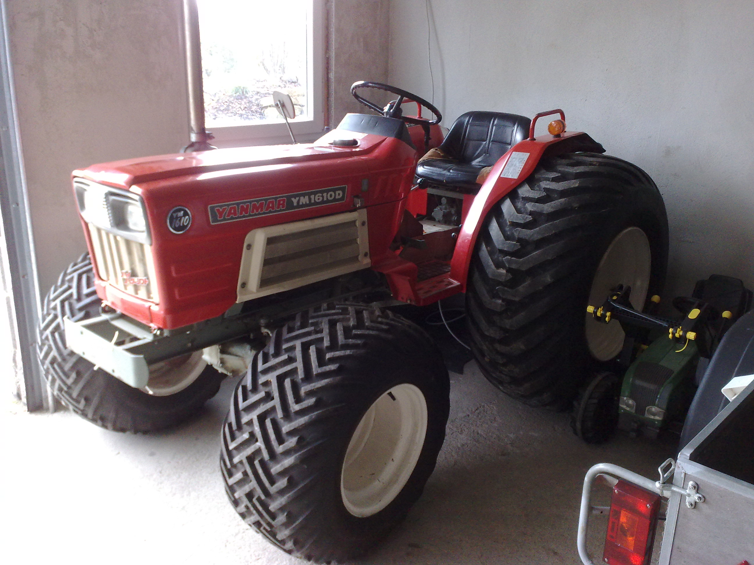

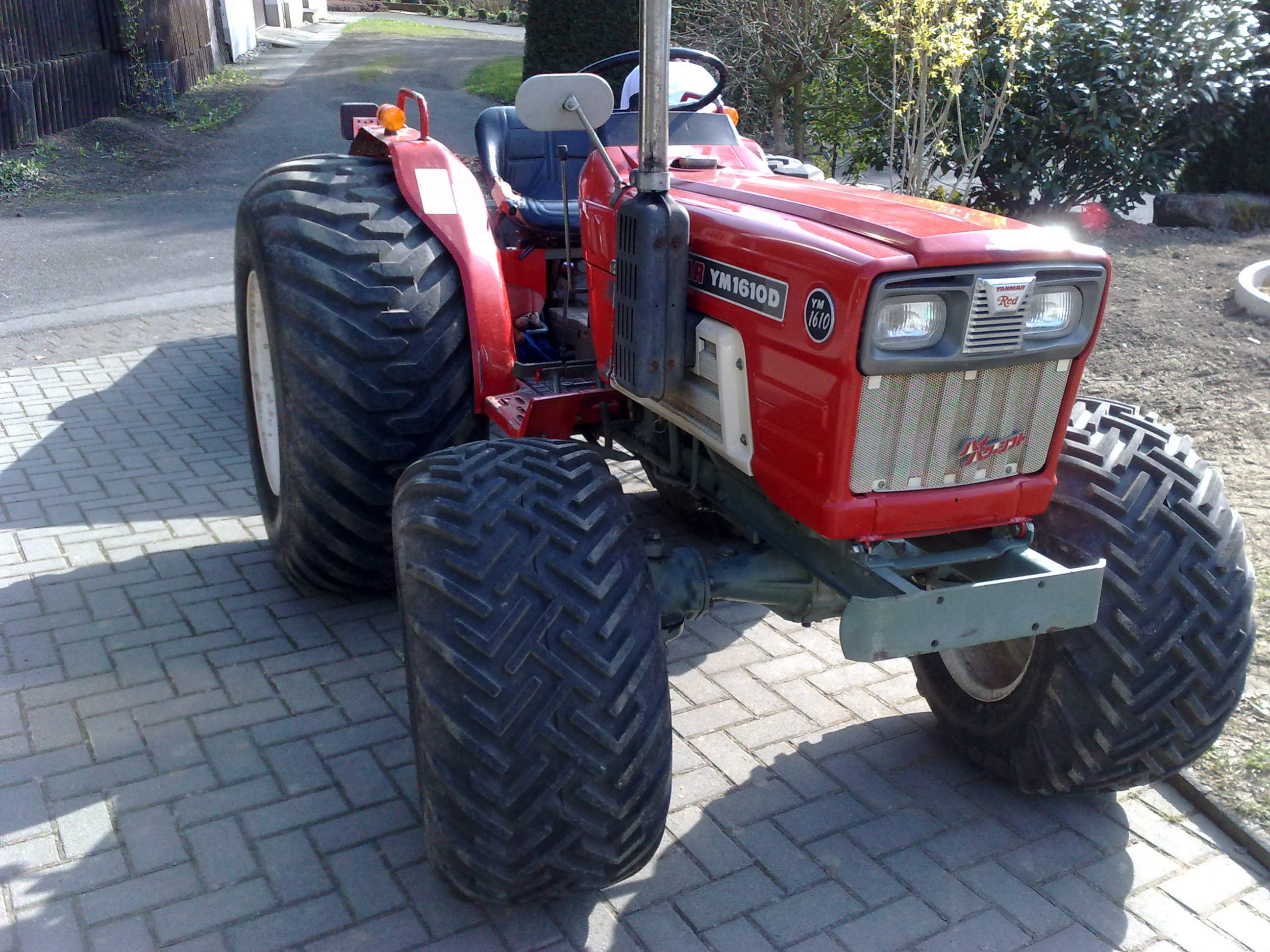

Verleih-Nix is that picture in your avatar real? that looks insane, in a cool way:drool:
   / Turf tires - YM2001 #6
Yes it is. Glad that you like it :thumbsup:
How did you make that work?
EDIT: never mind I found the original thread about it.
   / Turf tires - YM2001 #9
I had some issues with tires on a gray-market ride and refused to meet the price wanted for new rims and tires that were available.
Talk about strange things a man will do....I took some 15-inch Chevy rims and mounted a pair of surplus wide-mudder (truck tires) on there. The difference in overall circumference between the tires on the tractor and these mudder's was negligible. Made a great turf-tire and traction was great. Best I can recall...I had to "polish" the bolt pattern a bit on the 15-inch rim and put a flat spacer washer between the rim and the hub, but they bolted right on.
   / Turf tires - YM2001 #10
Looks great. Was there any affect on steering????
