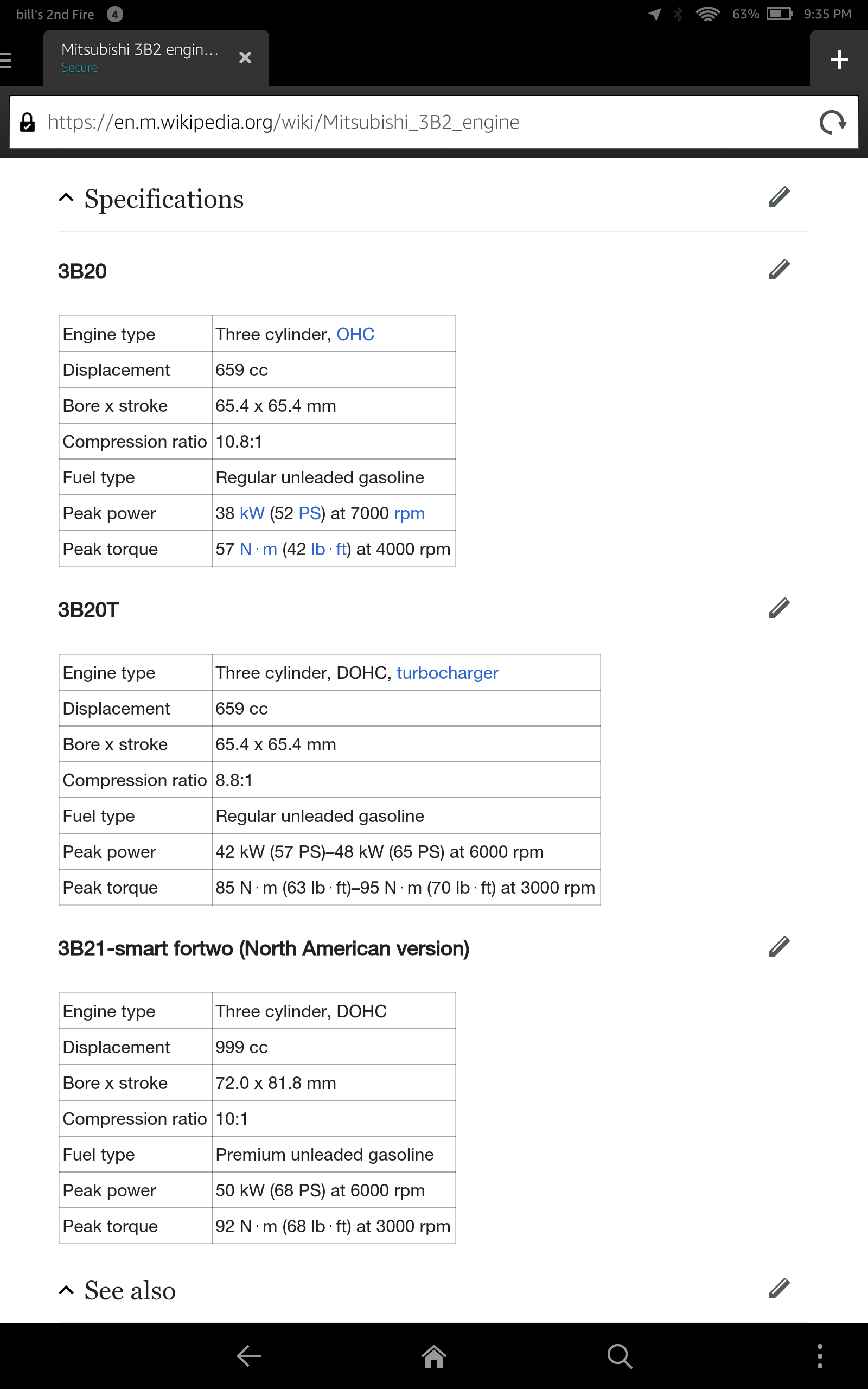

   / turbocharging a Kubota B7100 #10
Mitsubishi smart car engine.
90cummins,
Did you increase engine cooling? Do you recall boost psi? Turbo, oil or water cooled? Thanks.
