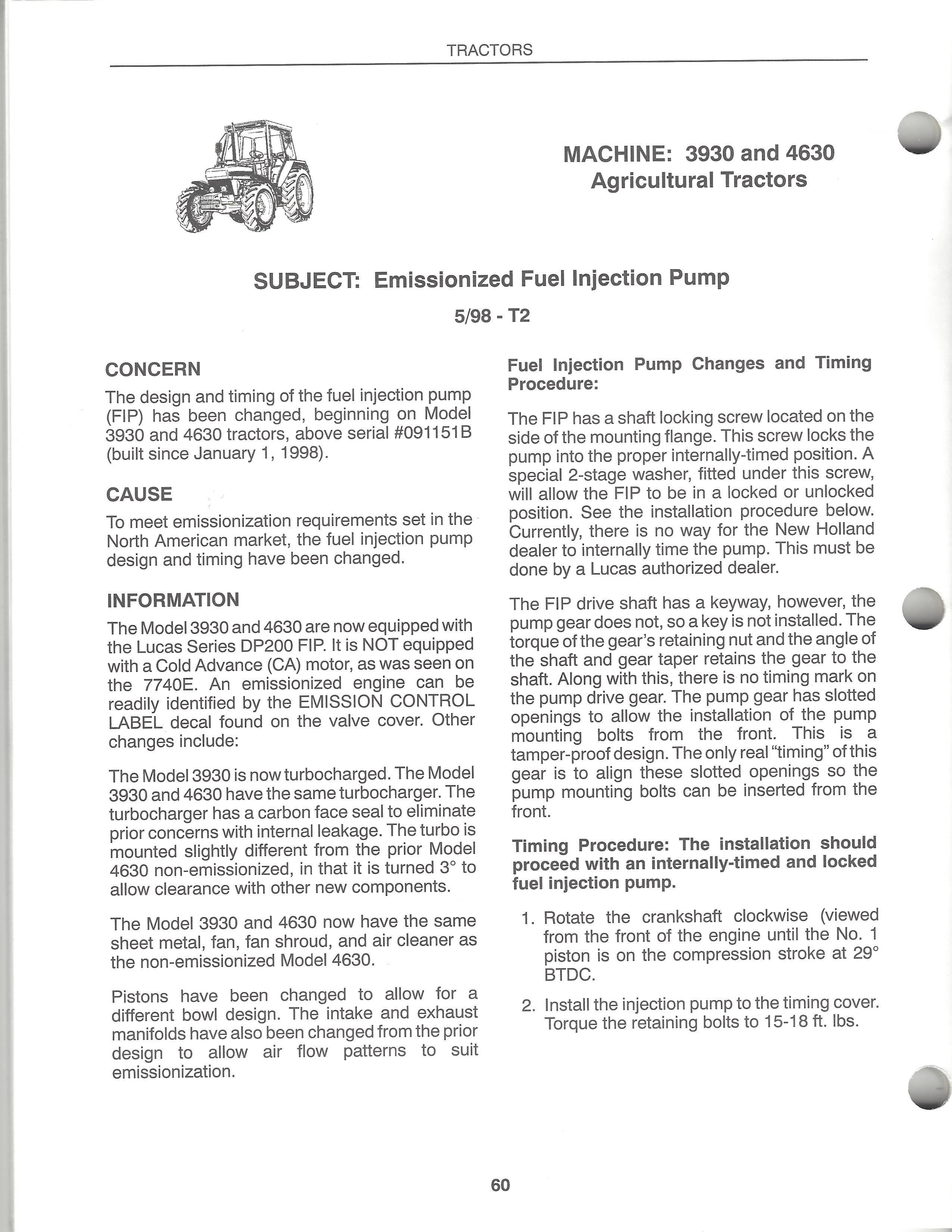

Gary, I'm going to assume that your rebuilder wasn't using OEM or equivalent parts. The emissionized engines were still BSD (Basildon Series Design) engines but incorporated turbo with the appropriate manifold and piston changes. The serial number format changed, but did not mean the engine was of a different design. The 87801653 head gasket is the only one referenced and is not in the part number update for those engines.

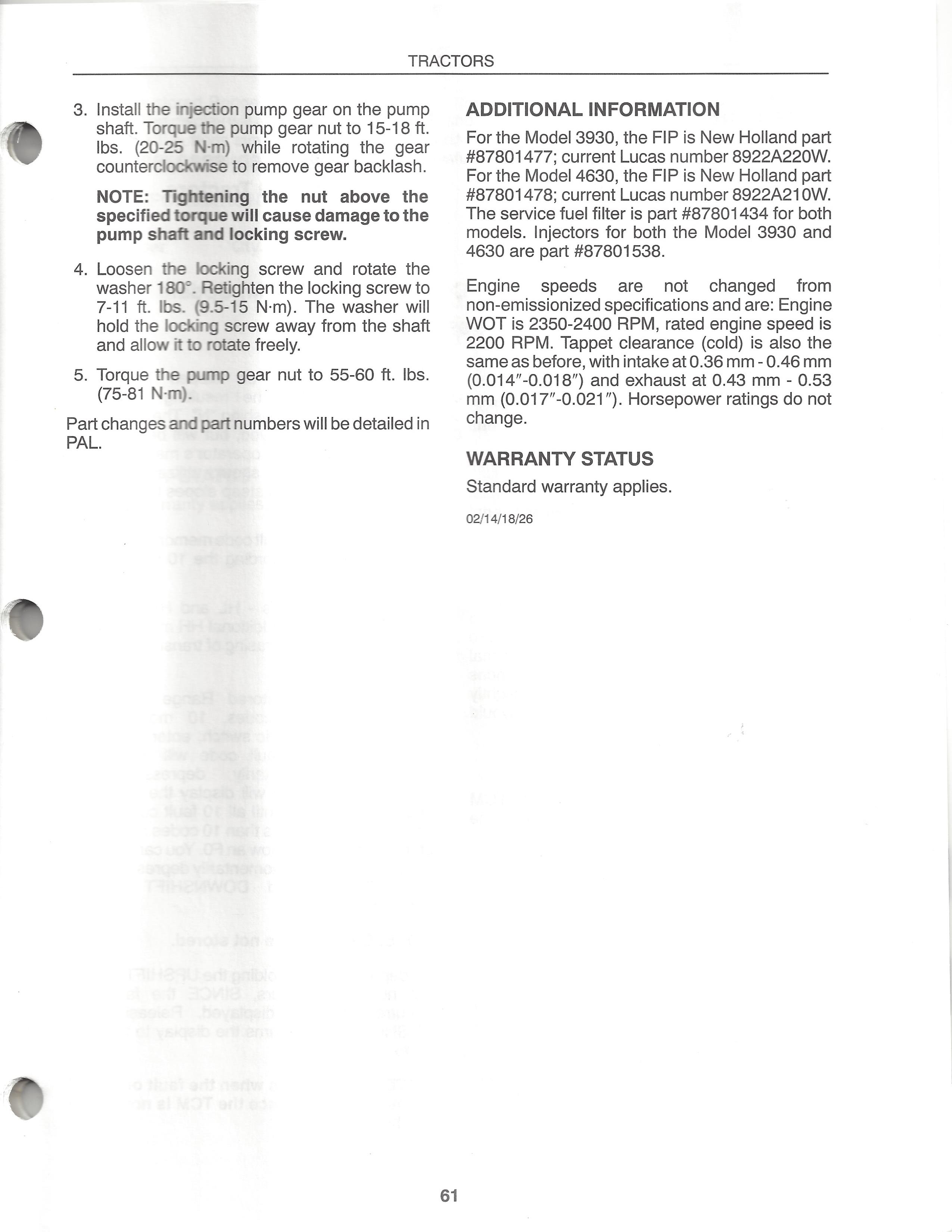

Attached is the service bulletin about the fuel pump and some of the changes for these engines. Emissionized 3930 & 46300001.jpgEmissionized 3930 & 46300002.jpg

Sorry I didn't reply sooner. Thanks for the info. I figured out the fuel pump. We then had to remove it and send it to the shop because it wouldn't pump The head gasket had to come from a Farm Trac. The gasket kit was aftermarket. The kit had the wrong gasket. And also as you know from the service bulletin the intake and exhaust gaskets were wrong also. We got it figured out and it runs good. When I worked at the dealer in the 80s and 90s, they were slow in letting the dealers know about changes. It caused problems sometimes. Thanks again,
