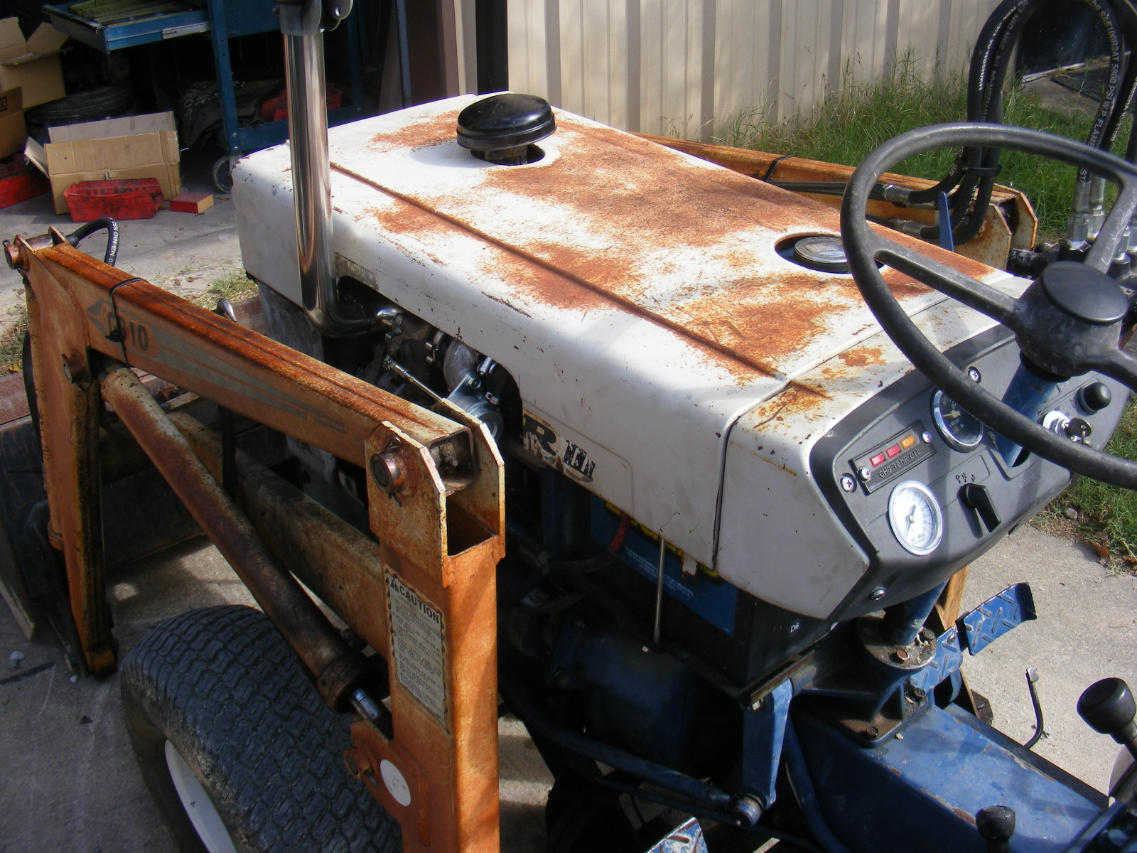

I'm not going to pursue any more fuel system modifications, with the additional rack travel and the helper spring it will get up on the wastegate (7 PSIg) near 75% load or so and barely smokes, just a light haze. Not going to hurt anything this way. Its finished except the EGT gauge.

Boss went and pushed some dirt around for an hour or so friday. When under working load pushing dirt it makes 4-5 PSI boost at under 1800 RPM, so the thing is about correctly sized, fuel pump changes worked out about right, and EGT's stay low, no overheating, so we're golden.

Both people who have put in hours pushing dirt on this thing in stock form can't believe how much more power it has now.
