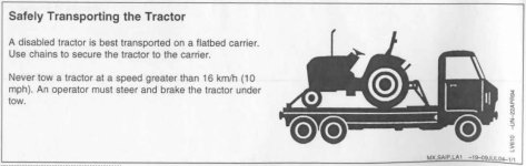

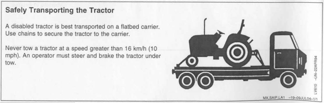

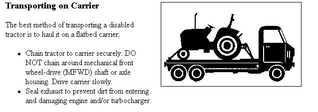

Since I readily admitted earlier that I am by no means an expert in this area I may have taken this thread a bit different than others. Rather than take any side on the issue, I just looked at it as a possible bit of useful advice that was offered only to help people; not stir any argument. So, I again looked through my JD owner's manual and emailed JD to ask them. Well, I was in for a bit of a surprise. My owner's manual I received with the tractor does not match what JD says is in my owner's manual (the manual I received from them with my tractor)!
I'm attaching a copy of what is in my owner's manual as well as what they sent me. The attachment that JD sent me does say to cover the exhaust, but not for the reasons first discussed here. The email from JD said that they advise to cover the exhaust to prevent FOD (as already mentioned here); not to prevent 'pinwheeling' of the turbo. Per John Deere, that does not happen and is not an issue.
So, the bottom line from John Deere is yes, do cover the exhaust when trailering your tractor, but not because of any damage that may be done to the turbo spinning without lubrication. I did ask for them to send me a new manual since my manual did not match what they said was in their manual. Either way, I'll likely cover my exhaust if I think about it to prevent bugs and dirt from entering the exhaust system and getting caught in the muffler.
The first picture is from my manual and the 2nd is the one sent to me by John Deere.
*edit*
I did forget to mention that John Deere strongly advises against using straps of any sort to secure the tractor to a flatbed or trailer. They advise to only use chains. I've already learned my lesson on that issue and would never again transport a tractor on a trailer using straps. ;)

Hehe, they put the tractor on the truck backwards!!
   / turbo owners: caution in transport #84
No, if you are John Deere, the tractor is correct. It's the truck that's backwards.;)
   / turbo owners: caution in transport #85
Don't forget, I didn't make the picture!! :D
It seems that they went out of their way to make sure that the exhaust is pointed into the wind! Worse yet, I don't see the exhaust covered in the one picture that recommends covering it.

Nope, rear facing is correct.

Another thing I don't know.
I was told that loading the tractor backwards is recommended to prevent the tractor from tipping over backwards if going up a steep incline to load on the trailer/truck. I dunno. However, my cab doors open like a regular car door and I have a FEL that makes sure I don't get light in the front when climbing up on my equipment trailer. Therefore, I always load with the tractor facing forward. That way I don't have to worry about one of my cab doors popping open and being ripped off. But, as I said, what do I know...I just don't want to think about buying new doors for my cab. :eek:
