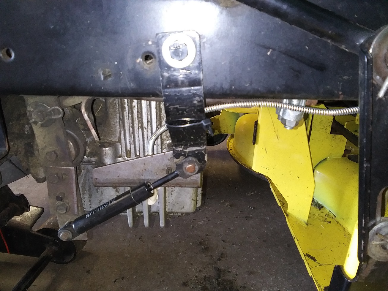

Might be the damper on the shift lever as shown. Some hydros have an internal cushioning port in the hydraulic pump to smooth the shift.
   / TuffTorq K46 Repair Guide with Pictures #1,014
Thank you for the photo, mine does not have that.
yes, i thought those 2 small ports or balls (i forget the name) had some cushioning design, perhaps best function with a lighter weight oil?
