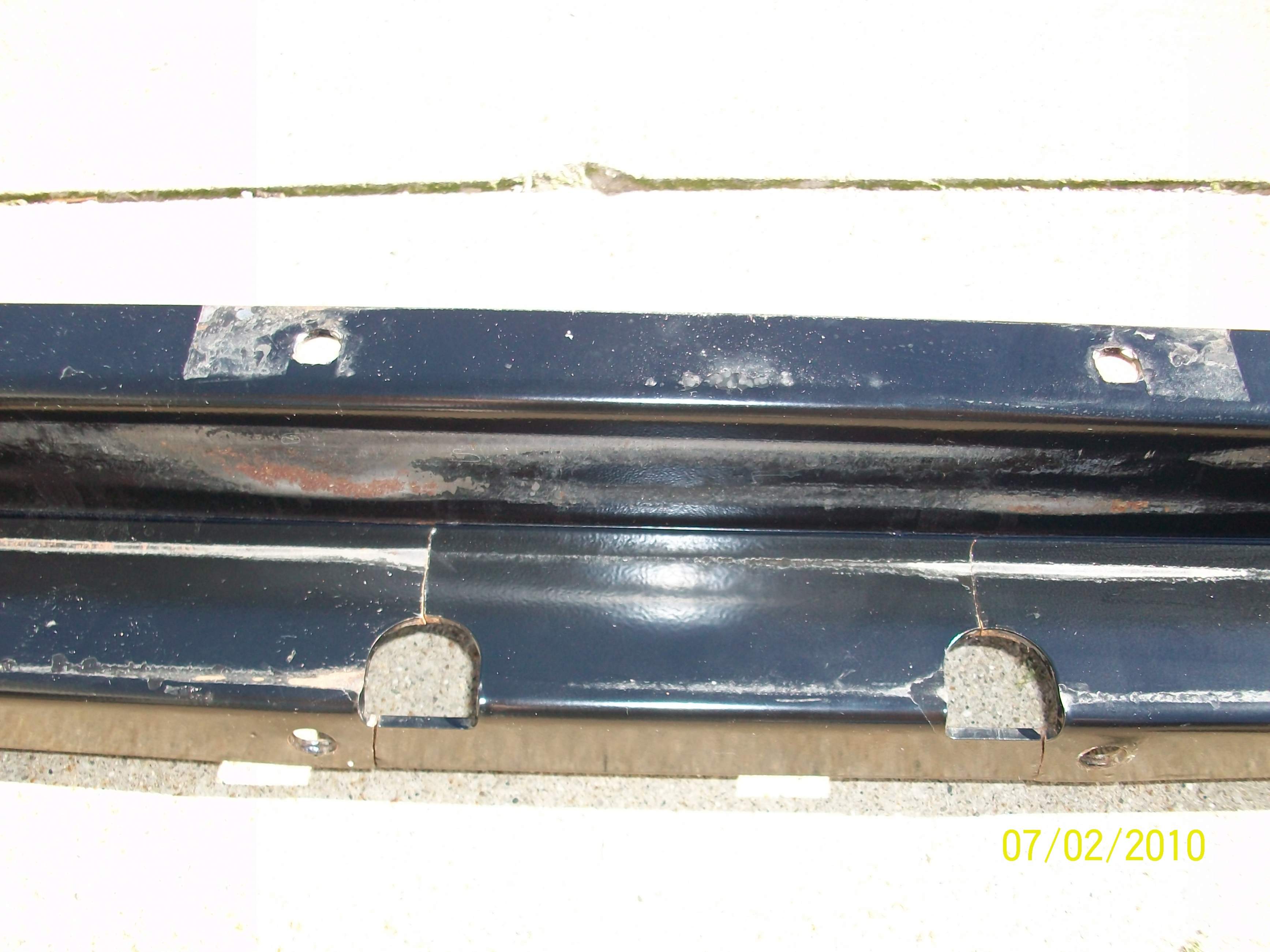

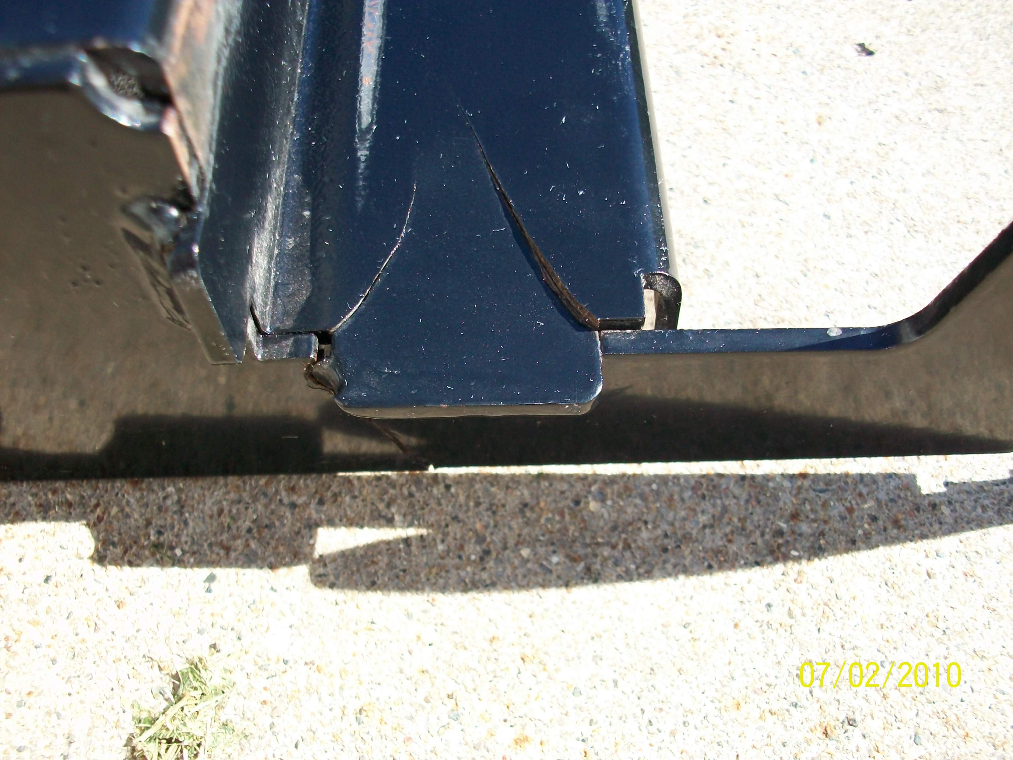

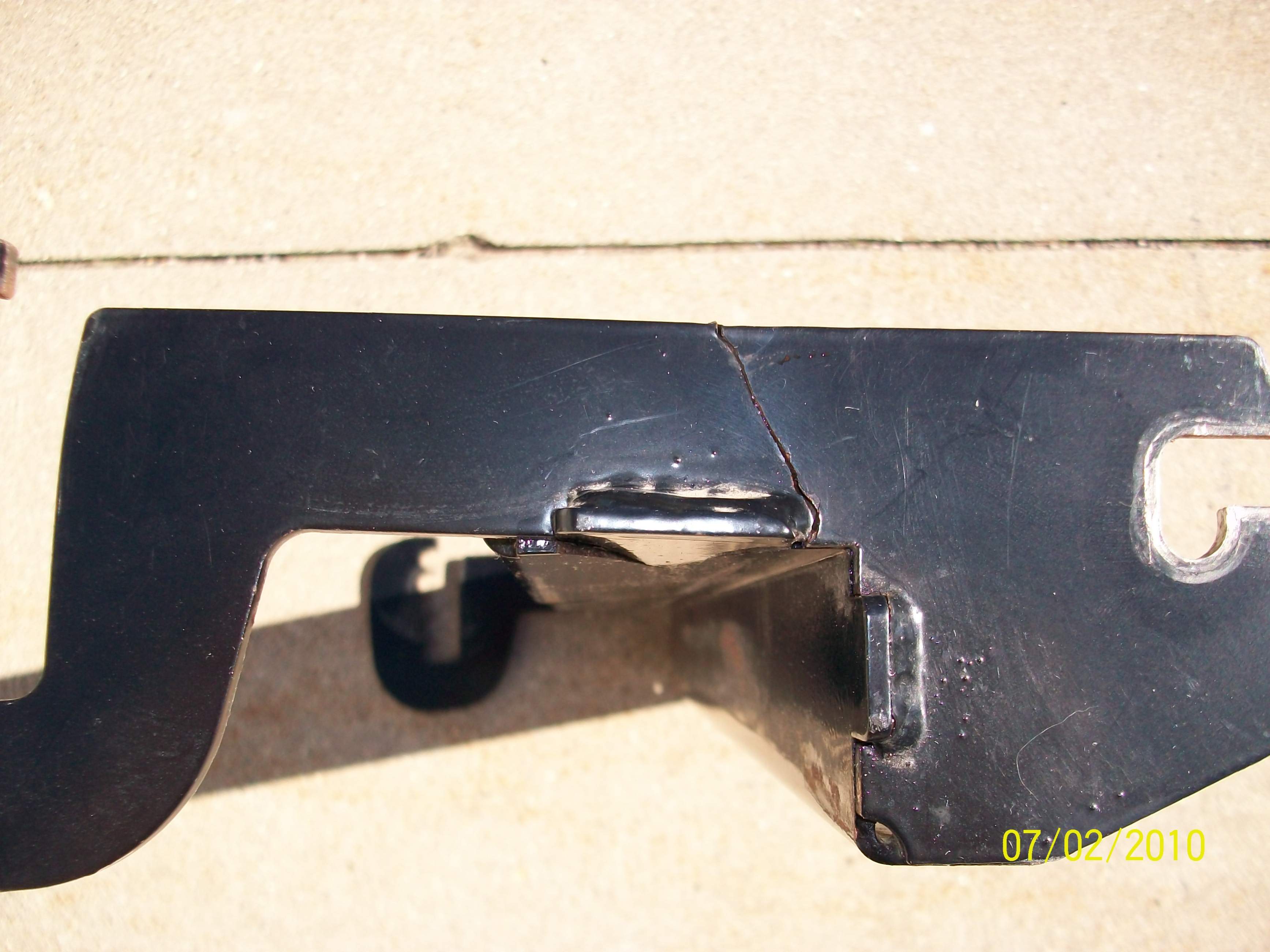

I took the top panel assembly off the roll bar bracket to look for the reason for these problems. I found eight (8) cracks through the metal of the top roll bar bracket. Three (3) cracks were in the rear vertical portion, four (4) were in the horizontal portion, and one (1) was in the right side plate portion. These are almost certainly fatigue cracks from bouncing around while mowing my pasture and meadow. The cracks were allowing the unwanted movement of the canopy.

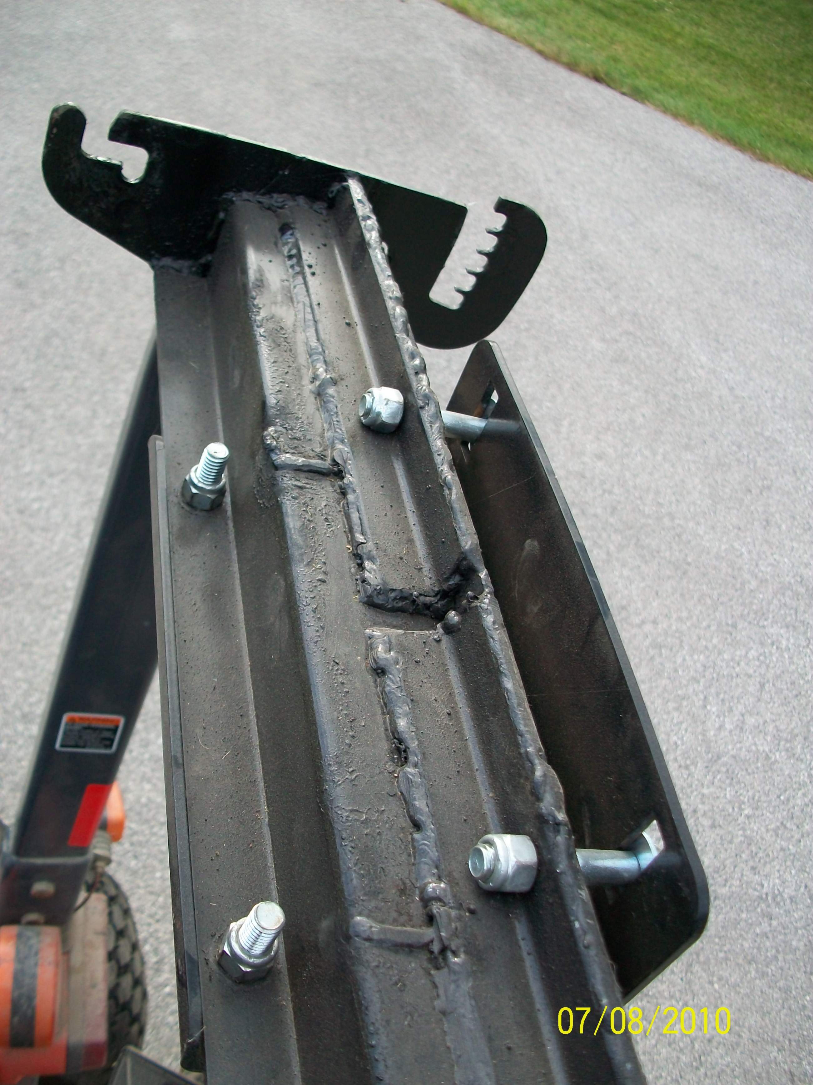

I decided to try to repair and possibly reinforce my existing bracket, before spending that much money. Luckily, I have a son with welding skills (although with limited access to equipment). My son finished filling in the cracks and adding a small angle iron reinforcement Saturday. Today was the first test. Three hours of mowing lawn with no problem. The canopy was rock steady. Hopefully this fix can stand up to the pasture.

Sodamo - Here are photos of some of the cracks before repair.
The 1st photo shows the bottom/back.
The 2nd photo shows the right side plate.
The 3rd photo shows the bottom right side.

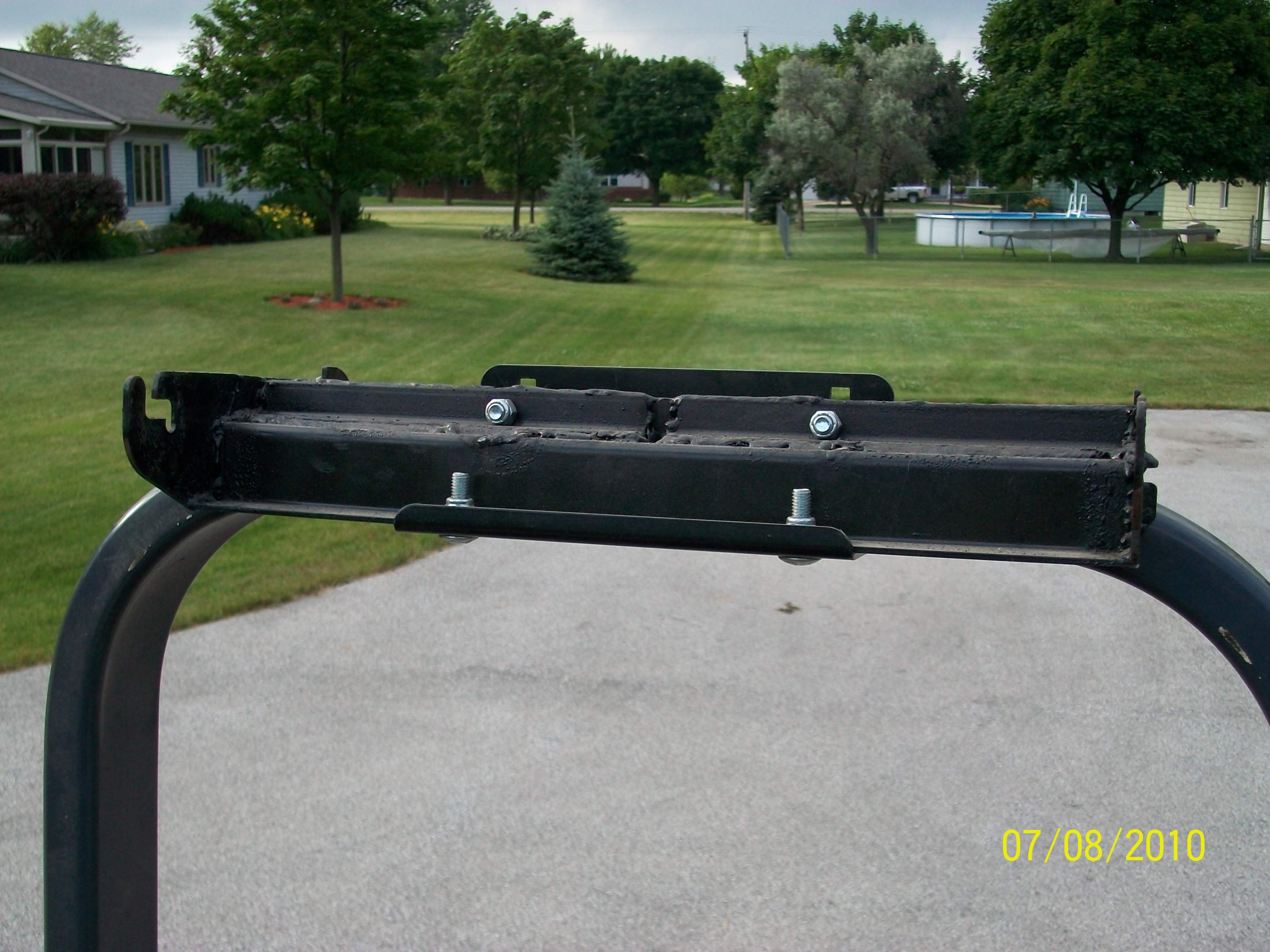

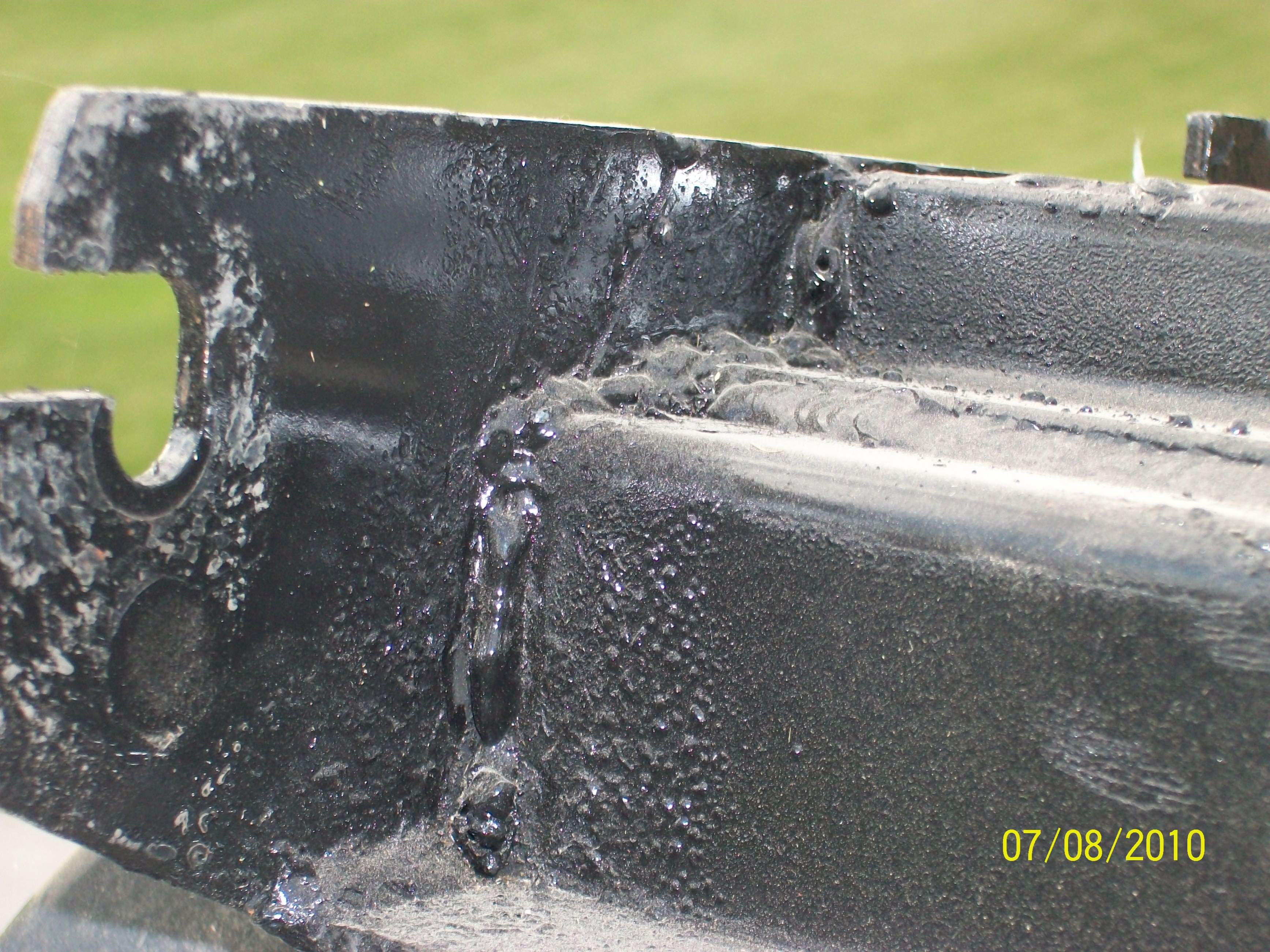

Sodama - Photos of the repaired bracket.
The 1st photo shows the front.
The 2nd photo shows the top from left side.
The 3rd photo shows the front right inside.
The added angle iron covered the original horizontal bolt holes and had to be drilled through to match. The angle iron also kept me from tightening the lock nuts, so I replaced the carraige bolts with hex head bolts, held the nuts stationary and tighted the bolts.
I hope this helps!
