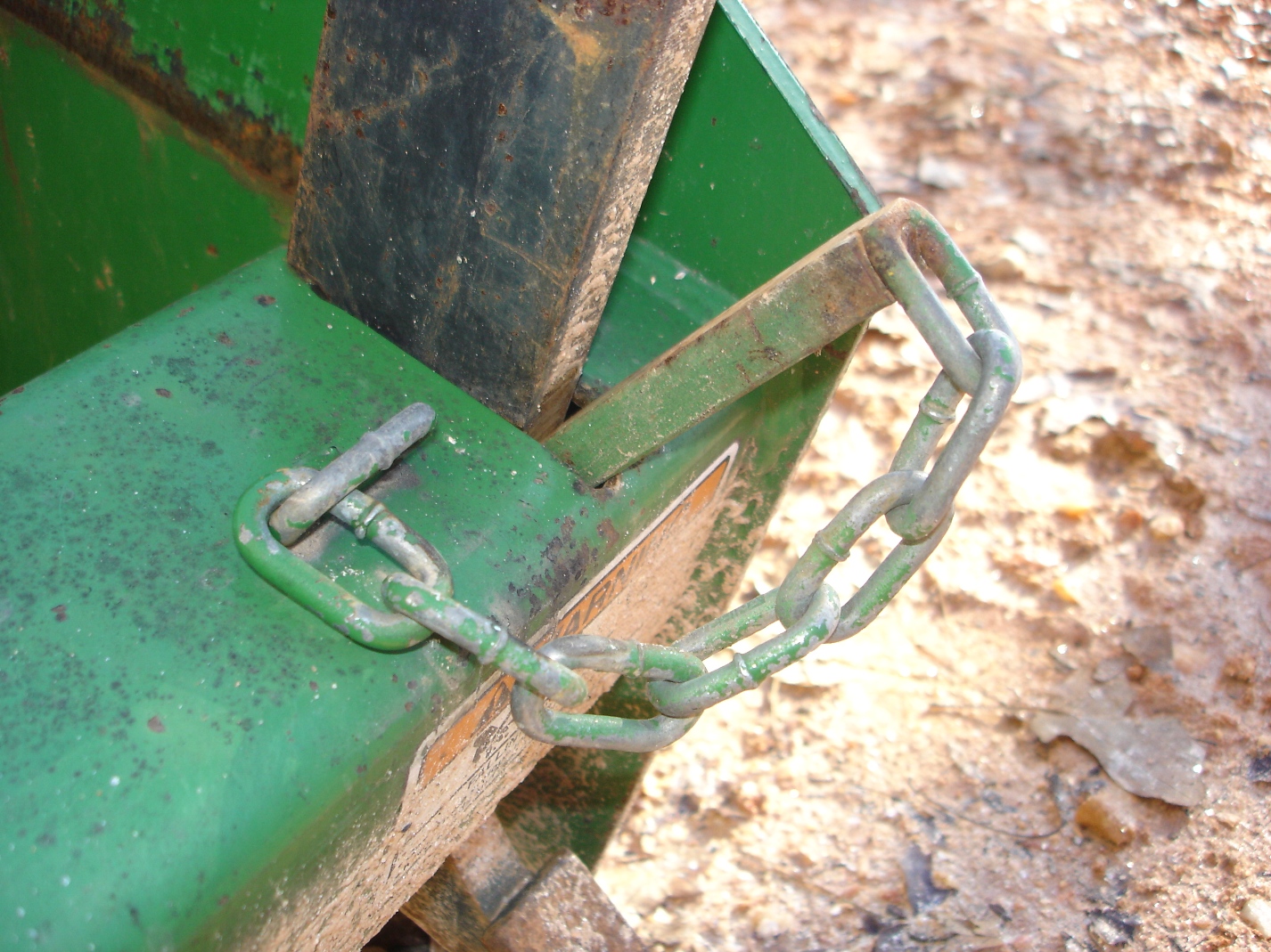

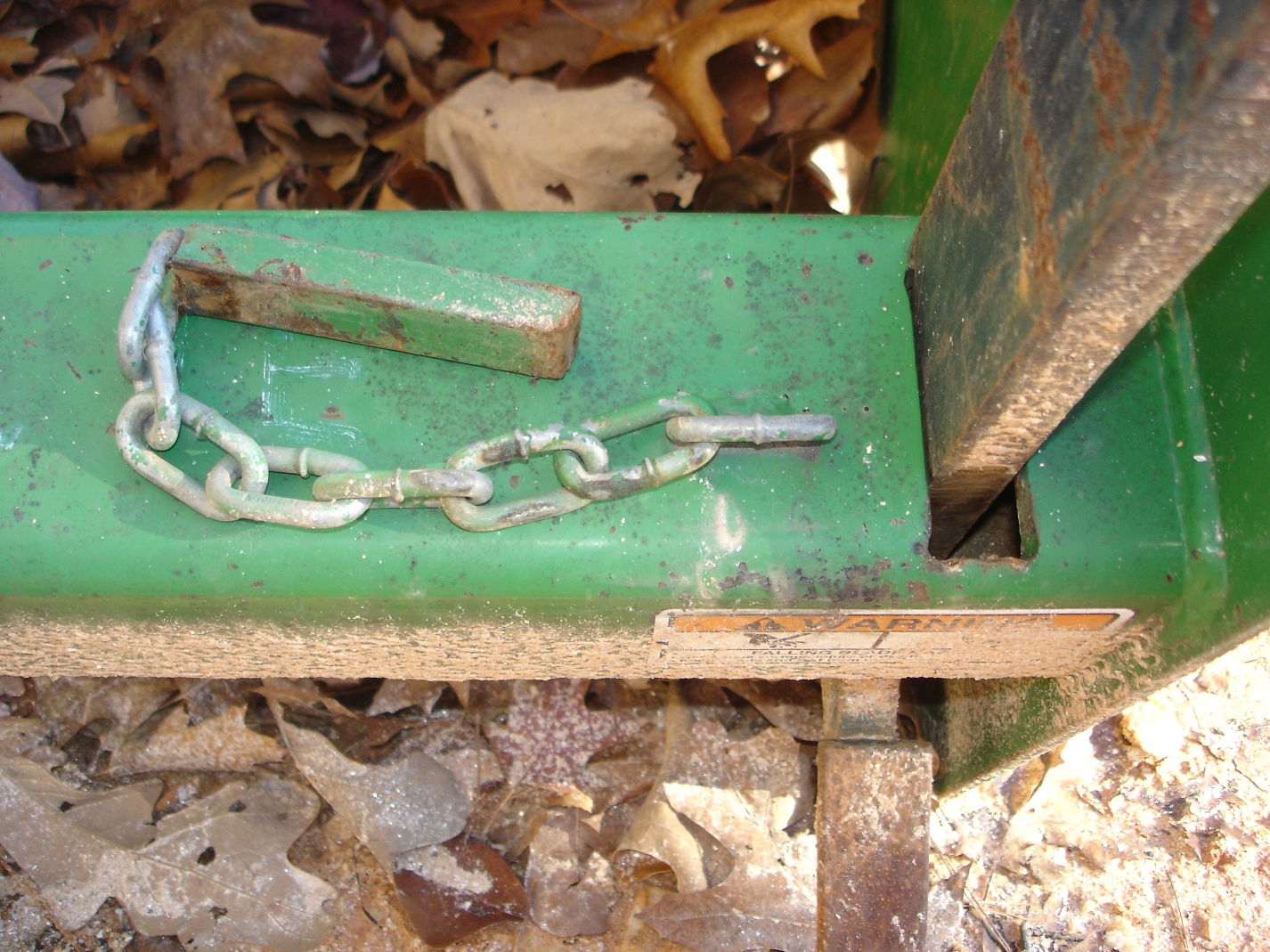

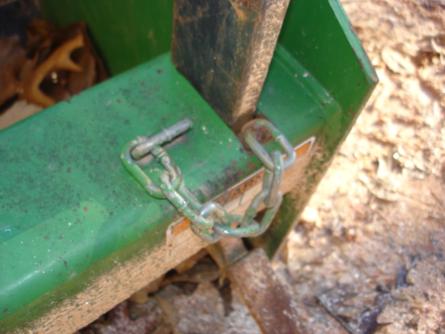

   / tuffline box blade scarifier falling out #9
This is what the Tufline factory installed on mine. The pin itself is just a short piece of square steel stock. You can chain them or make a removable T of 1/2" square steel. The leg of the T needs to be 3-4" long and the top could be 2" across. Drop the T's into the slots with the top bars parallel with the front edge.
