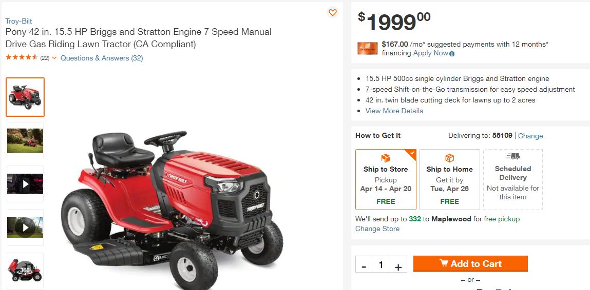

Seven speed manual shift riding lawn mower:
That was easy to find.
Richard
Richard
Well, the minute you tell folks, 'there ain't much of any of those things' someone goes out and finds an example of the opposing viewpoint. I believe jgayman was saying that, 'most lawnmowers come with HST trannies, not geared' and to that, I agree 100%. I fix 100s of lawnmowers and have never seen one geared transmission. Obviously they make em', and good on you to point this out, but they are in the overwhelming minority, in my - and others - humble opinion.
