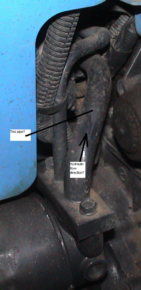

Hi Guys, Thanks for the info. Attached is a pic of the back of the tractor. Is this the right pipe? Is the flow direction correct? If I cut this pipe and get some "in" and "out" connectors fitted, via a center-open valve, will this work?
With my limited knowledge of this stuff, can I take it that the center open valve, when connected to a ram (for example) offers "extend" when the valve is pushed one way, "contract" when pushed the other way and "connect in to out" when not touched?

I can't tell from the picture. The pressure line is the small line on the hydraulic pump. An open center valve allows oil to pass through the valve when it is not being operated. A close center does not allow oil to pass. An open center pump pumps a constant volumn in relation to engine speed. A closed center pump pumps on demand. If there is no demand for oil , none is pumped.
What you want is a double acting open center valve.

I think you are labeling the return line rather than the feed. The smaller line looks more like the feed. As posted, the best place to start is at the pump and follow the smaller line to a spot you can tie in.

Kayssupply - I believe you are right!
Having listened to the "wisdom of the elders", I pulled the wheel off and removed the cover. I have reposted a picture and relabelled it. Is this right? /forums/images/graemlins/confused.gif
