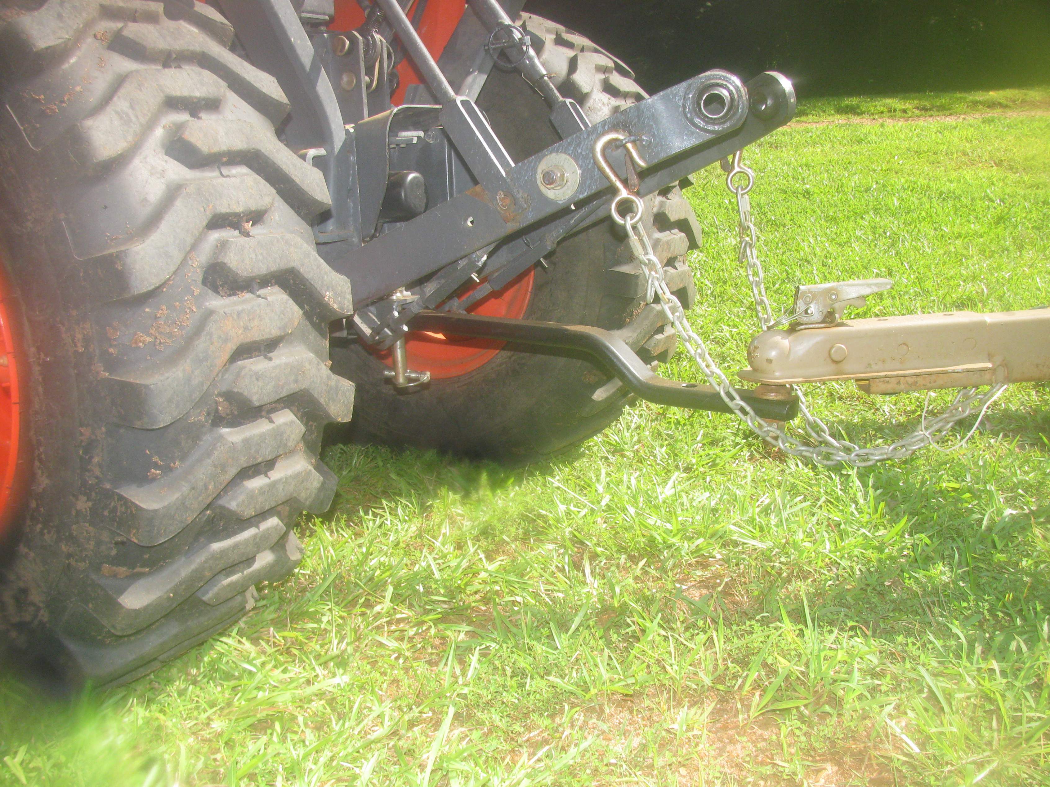

I needed a fixed drawbar quick. The local Kubota dealer said he could get me one in three days for ~ $70. I needed one before then so went to TSC to see what they had. They had one that looked like it might work for $45. It worked like a charm. I think I like it better than the Kubota drawbar made for this tractor because it is longer. I could turn the trailer 90 degrees to the tractor and not even be close to hitting the tires. I know the load it will handle decreases the further out it is but it will be fine for my use. The ball is about the same distance back as it would be on a 3 pt bar. I may weld a thin shim to the end that fits to the tractor to make it a little more snug but I don't really think it is all that necessary. Just in case somebody lost theirs, would like a longer one, or, like me, bought a B2920 (or similar) that no longer had the drawbar with it.
