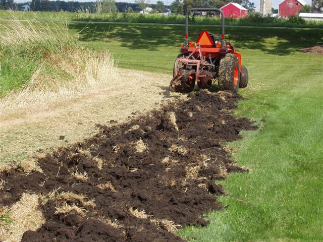

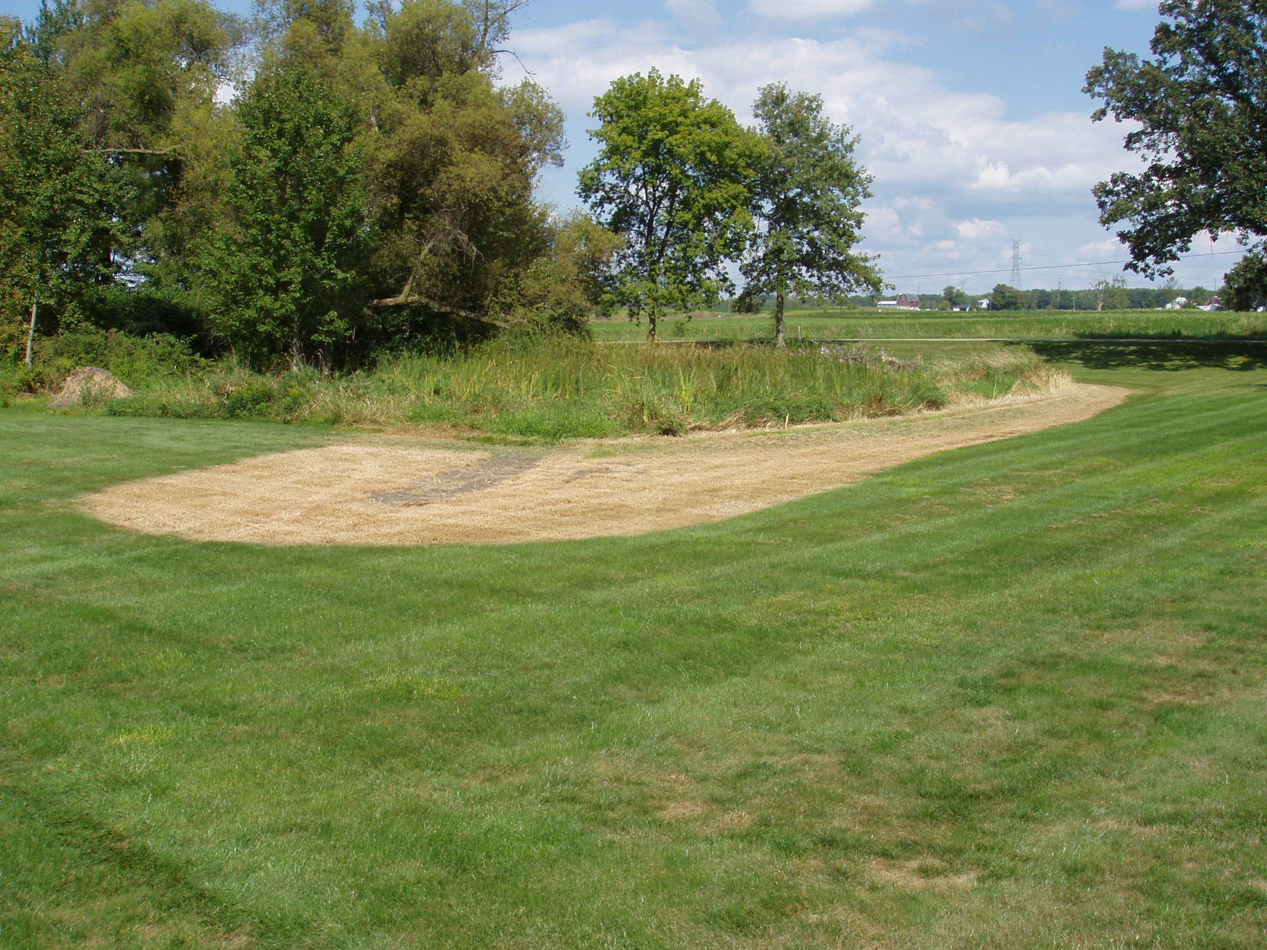

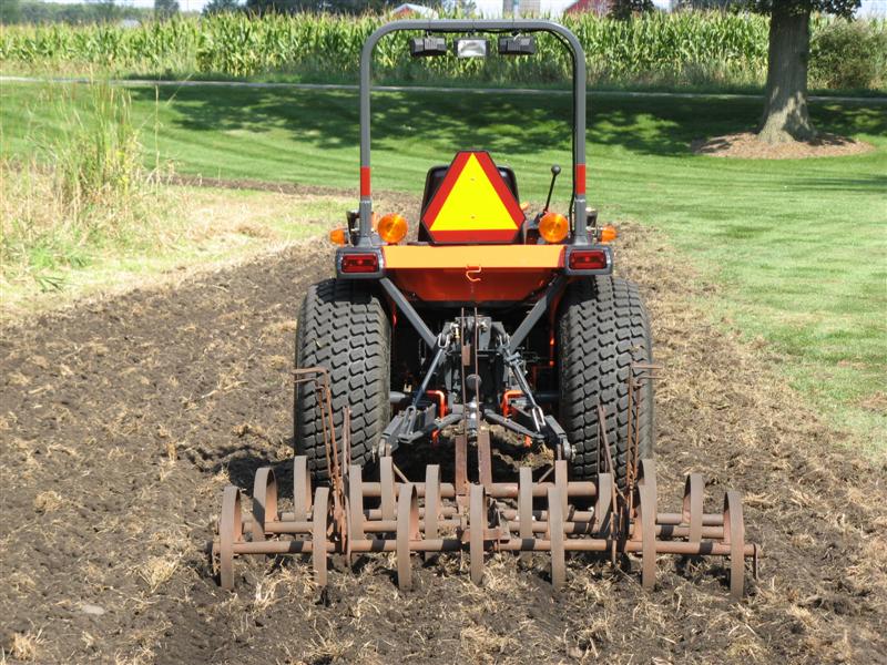

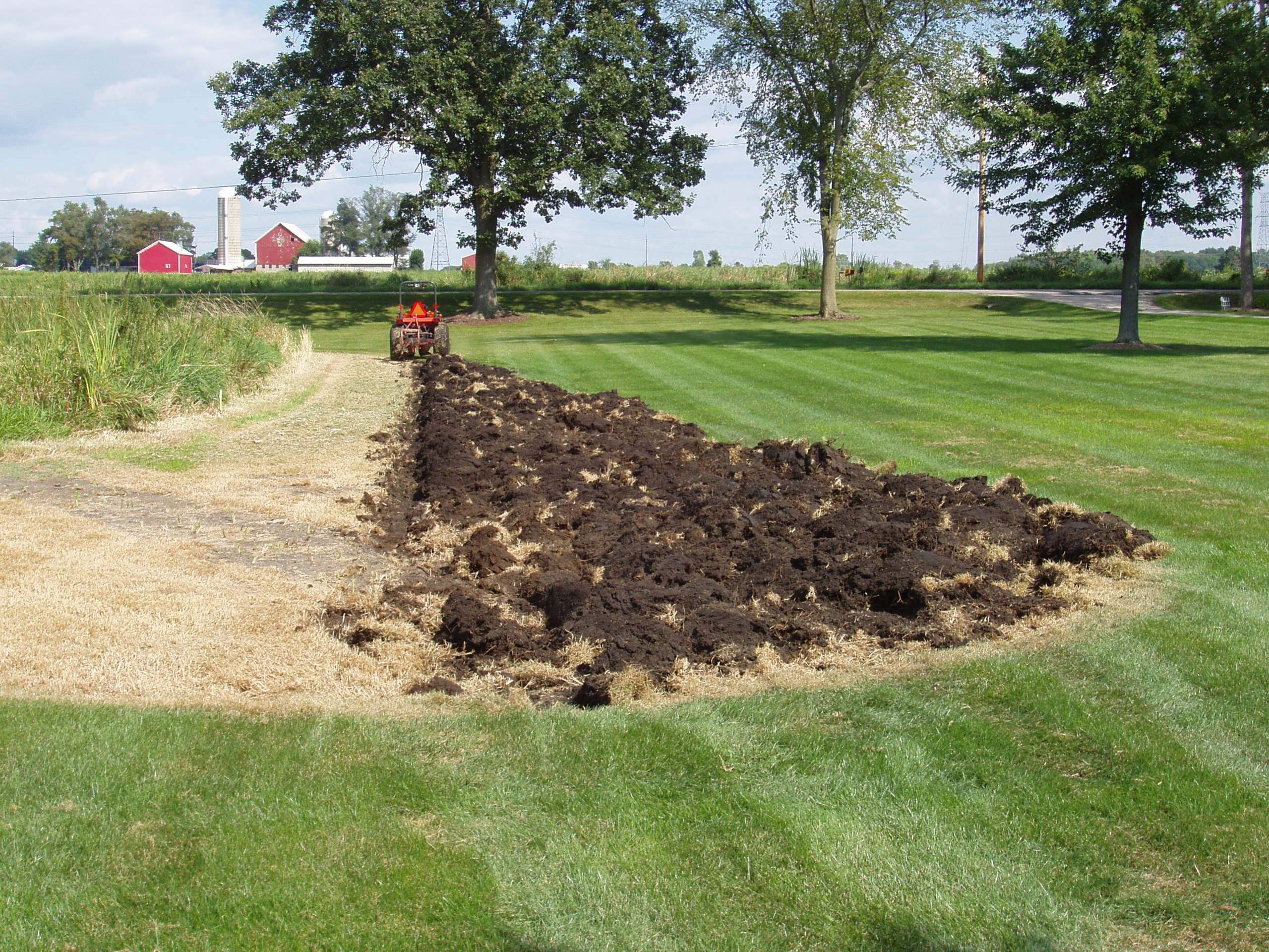

In 2006 I had a patch of canary grass that I wanted to turn into lawn. This was a low spot on the edge of my property that was too wet until midsummer to drive on. I tiled it so the water would drain and then late that summer I sprayed it with roundup. A couple of weeks later I plowed it with my B3030 and a 2X14 plow. A week later it started to rain and I couldn't get back on it that year. A year later it was dry again and weed covered so to get it ready for lawn grass I used a 6' 3pt drag that I salvaged and repaired from the neighbor's fencerow. I made several passes with the drag. I next went over it with a lawn roller. I alternated the drag and roller a couple of more times until it was broke down enough for grass seed. It turned out pretty good. Here some pics of the process.

N1ST, if you could find a 1 bottom 14" or 16" moldboard plow or a 2X12" plow that would be the ideal size for your tractor. I looked for them but could not find one so I settled for the 2X14". It works OK in sandy ground like I have. I would never use it to plow a large field, though. Our tractors are very versatile but they just are not designed for sustained heavy tillage work. With proper size implements they can do alot, though. There is no one tool that does it all to break up the soil. The most popular secondary tillage tools are a disk, a springtooth cultivator or drag, and a cultipacker. They are used in combination or all at the same time pulled by a big tractor. Some are even combined into one tool.
I think you might be able to do something with your cultivator and tiller. If you can control the depth of the cultivator you can pull it easier without taking off a couple of tines. With the ground ripped up a little the tiller should work better. Or use your middle buster to break it up and then till. On the other hand, a plow and a disk that your tractor can handle will probably work best. Good luck.
