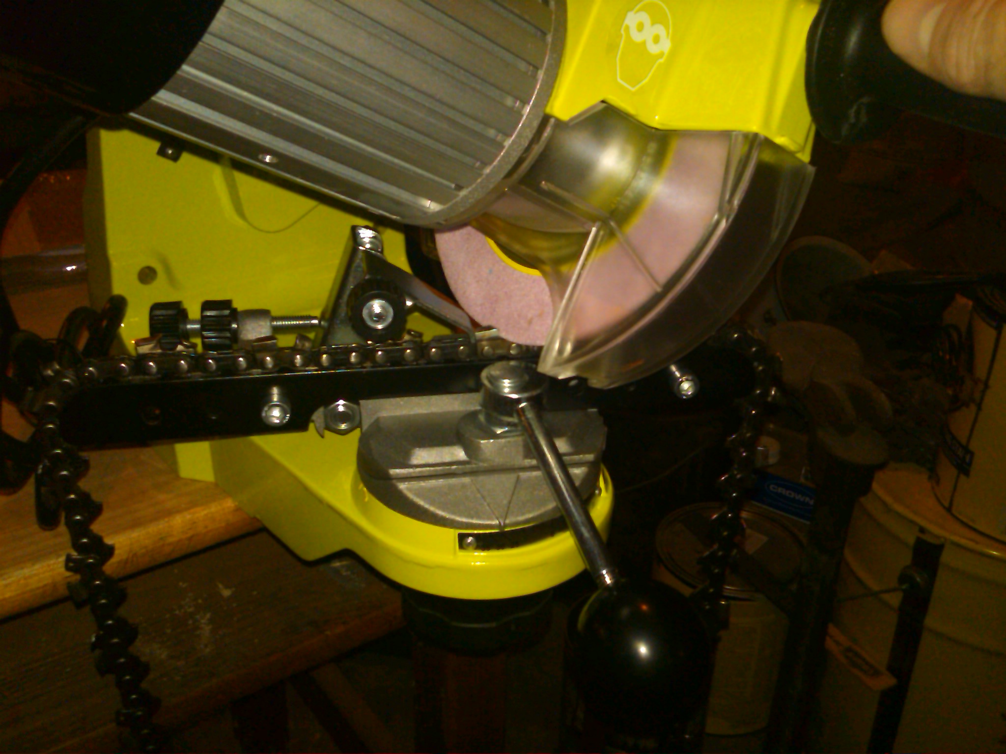

Okay, I got it mounted to the small desk and it seems to be at a good working height when sitting in a chair.
According to the information sheet that came with my chain I need a set up like 60* 25*. I am thankful I always keep the package my chains come in and when switching out I put the old chain back in the package and hang it on the wall.
The instructions with the sharpener does not give much information on the angles needed. So after looking at several different ways of setting it up I decide to look at the actual chain package and the information sheet inside tells exactly what set up you need for the chain number you bought/use.
I was going to sharpen one last night but the wife says "no grinding smell in the basement":(. So I hope to try one chain in the next day or two and see how it cuts Saturday before sharpening the rest of them.
See pictures below.

Here is the one I got back in the 1970's. Looks very similar to yours. ( I added the light)
I have worn out 4-5 chainsaws and been through many chains over the years, but this thing just keeps on
going. I have mounted lockable or retractable casters under most of my shop tools, including this one, for easy mobility
and storage when not in use.
