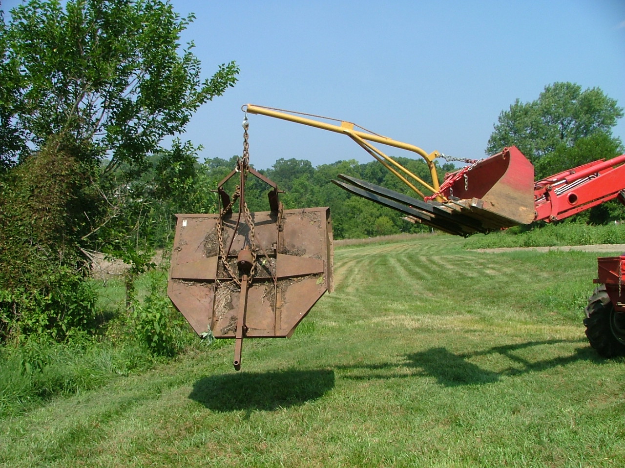

I think this is the same one that TSC sells. The bushhog weighs in the neigborhood of 500...

/ TSC Boom Pole #6
Just out of curiousity, what are some of the things you'd use a boom pole for (assuming that you also had a functioning FEL)? I could see myself using one to skid (small) logs (with the lower hook of course). What are some other uses?

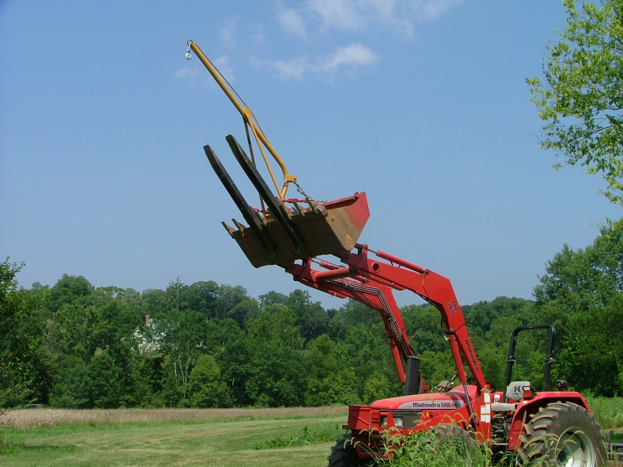

BobG
What tractor is your boom pole mounted on the loader bucket of?
I was thinking of making such a rig to lift roof trusses for a new machine shed but do not want to learn the hard way about leverage vs. stability.

It's a Mahindra 6000 4WD. With loaded tires it weighs in the neigborhood of 9500 to 10,000 lbs. Quite a horse...As far as putting up trusses this will give you an idea of how far I can "go up"....The loader is rated almost to 4500 lbs as "breakout". don't think I'll be trying to pick anything up that it can't handle..
