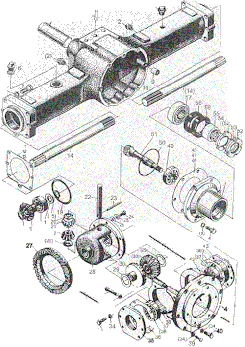

I made a disturbing discovery today on my new (to me) 2003 TS354C Tractor. It had 50 hours on it when o purchased it from a private individual.
I noticed some fluid leaking from between the Diferential Carrier Refer to the atttached diagram - Front Supporting Shaft? (Item 4) and Front Drive Axle Housing (Item 10). On closer examination I discovered that the bolts were loose.
I figured, No problem, just tighten them up. /forums/images/graemlins/smile.gif Unfortunatly when i tried to tighten them, I discovered that several of them were striped out. /forums/images/graemlins/frown.gif Ok I figured just tap them out over size or helicoil them.
But tonight I got to thinking... Maybe this is symptomatic of something worse... /forums/images/graemlins/confused.gif tomorrow I plan to drain out the fluid and look for metal in the oil... I will post more as i go.
Has anyone else run into this type of problem?

One last try to attach the diagram...

Now that I look at this diagram again it is not item 4 but rather item 41 - Front Bevel Gear Bearing Seat joint with the Front Drive Axle housing that is leaking. The bolt that is striped out is Item 40 (Bolt M10x35).
Does anyone know if there is enough metal in the Front Drive Axle Housing to allow me to drill and tap for M12x35's ?

I think there is plenty of room to install helicoils, not sure about drilling and tapping to 12mm, but you might also see how deep the holes are drilled and tapped and perhaps you can just use longer 10mm bolts. So long as you get good threads for at least 10mm you should be fine.
I'm Courious if it is upper or lower bolts that are stripped? This is the first front axle problem on a TS I have heard of and would like to know what happened. I have differentials, and outer drives in stock, but not the axle casting itself
Could be it was leaking and prior owner tried to tighten too much to stop. Some people just don't undertand that Cast iron is not the same strength as steel.

Yes, I believe that the previous owner may have over tightened them. I bought a 10mm tap and 40mm long grade 8 bolts. I noticed that the very bottom bolt (the only one actually striped out) I took out was only 30mm but the parts list specs 35 mm. I ran in the tap and the new bolt seems to be holding well...
I had to tighten up all of the bolts including the top. They had backed out around 3/16”! Tomorrow I am going to purchase some locktite and apply it to each of them. Is there some sealant I can apply to assist with the seal in lew of a breakdown for seal replacement?

Tonight I removed all but one of the bolts and backed that one out which opened up the joint about 3/16" inch again... I used alchohol and paper towels to remove the majority of the oil from around the joint then used carb cleaner spray to remove the remaining oil deeper in the joint.
I cleaned and de-greased all of the bolts and replaced all but two of the 30 mm bolts with longer ones,
I then applied a bead of permatex high tourque gasket sealer the grey one (cause thats what they had at the local farm supply 5 mins down the road.) using a clean putty knife I worked it into the joint.
I then applied a bit of red Locktite to the tipe of each bolt and tightened them up. all pretty easy except the very top bolt hich i had to perform a hodini act to get into the hole as the side frame and radiotor / engine limit access. Of course i got the Permatex all over my hands in the process... Finaly got the bolt started and using a 16mm open end box wrench began the slow process of tightening it up.
The amout of rotation that I was able to obtain required me to use a trick my dad taught me and flip the wrench over each time. Of course I could only move it with two fingers. /forums/images/graemlins/smile.gif I looked in to see how i was progressing and discovered that the lock washer had fallen off /forums/images/graemlins/frown.gif another twenty minutes to back it out and clean it up and get it re-installed.
Long story short(er) It took me about ten minutes to get all but one bolt installed and perhaps two hours to install the top one. Good thing I am a stuborn person. (See this can be a good thing) let her set for an hour and filled up the outer drive units with new penzoil 80w90 non foaming gear oil (not the HP).
Checked out the free play and noise with the gear oil and it feels real tight also the front end now rolls super smothly /forums/images/graemlins/smile.gif I am feeling more confident now that there has been no permanite damage and the front end should provide many hours of reliable service.
